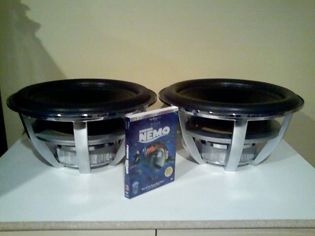

I am replacing a Paradigm ps1200 (12" bandpass) sub with 2 15" Audiobahn high excursion subs and a TOA 300w x 2 rms pro audio amp. The subs will be in sealed or ported boxes. Not 100% sure which way I will go with the boxes yet but they will be flush mounted into either the front wall or front side wall of my HT. The reason I think this is a "budget" install is that the subs were $200 and the amp was only $125 - all off ebay. I had a car audio adjustable crossover laying around that I will use for now to get going.
So far I have:
The amp mounted in my rack
My car audio crossover mounted
All wiring connected between amp/crossover/pre-amp
Hopefully boxes will be ready to test by the weekend.

Update
Just a brief update,
Well I hooked up one sub in a 2.25 cubic foot generic ported box to the amp bridged and it was okay - could not really test at a decent level due to kids sleeping upstairs. I played around with the crossover point, phase and level until it was basically right.
Then on a whim I decided to try running the sub out from the preamp (crossed at a fixed 100hz ?) into the input on my AudioControl phase coupled activator and then out into the car audio electronic crossover. Wow....Holy ..... what a difference. I bought this thing a couple of years ago and never hooked it up. To say the quality and extension of bass was improved is like saying adding a sub to a system is noticable. Based on this experience I am quite sure that 2 of these drivers in sealed boxes will be ample for my application.
Pierre
