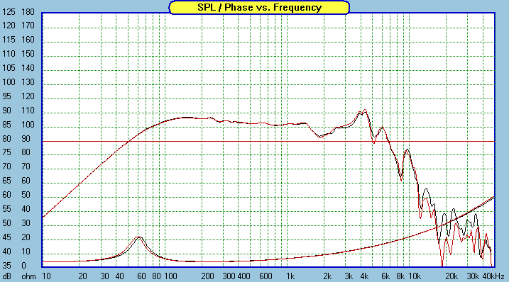

This graph shows consistency between units:
I have zaph's measurements posted now which can be seen at my photo bucket until the comparison application is updated: http://s8.photobucket.com/albums/a44/OlogyAudio/Z55/

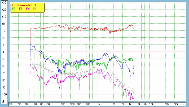

They are not as awesome as I expected, but are definitely not bad by any means... The frequency response deviated between the sample and the production quite a bit, for this reason I'm going to avoid pulp mixes as well as textile domes in the future to help out batch to batch consistency. I hear this issue plagues every engineer at one point or another in their career so I intend to make sure it only happens once... I will stick with more consistent processes at least until I can afford the time to watch over the mixes and coatings in person. The distortion below 80hz could stand to be a bit better but in all it looks to do fairly well at the price point. I have also revised the 1 way xmax down to 5mm as a more conservative estimate based on the capability of the suspension.

The peak at 4khz can be dealt with, without too much issue. I also think the dip in the frequency response helps mask the 3rd harmonic distortion associated with it since my ears aren't registering much in the way of anomalies there. This unit was also surface mounted for the measurements. I'm playing with several designs at the moment but I would like to see what other people can come up with as well.
