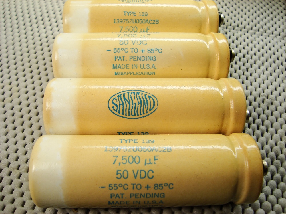

OK so I checked the capacitors for fun. They read a little low, but seem to be functional.
My capacitor checker is the low voltage type. (BK precision 820), so I don't have a whole lot of faith in the test.
Now the filter caps are 7500uf+7500uf 50v in series for each channel. This gives ~3500uf @100v.
I wonder the reasoning for this? Simply to raise the voltage rating of available caps?
I guess I could just replace the 7500uf + 7500uf 50v's with a single 3500mf cap at 100V? (If available)
Not that I needs it, but maybe I could increase the capacitance while I'm at it.
I just had a peek online.
Going with a 4700uf /100V looks like the way to go, there is lot's to choose from, I only saw one 7500uf so far.
Good to have some options. There is also some 3500uf 400v computer type caps that might be an option too.

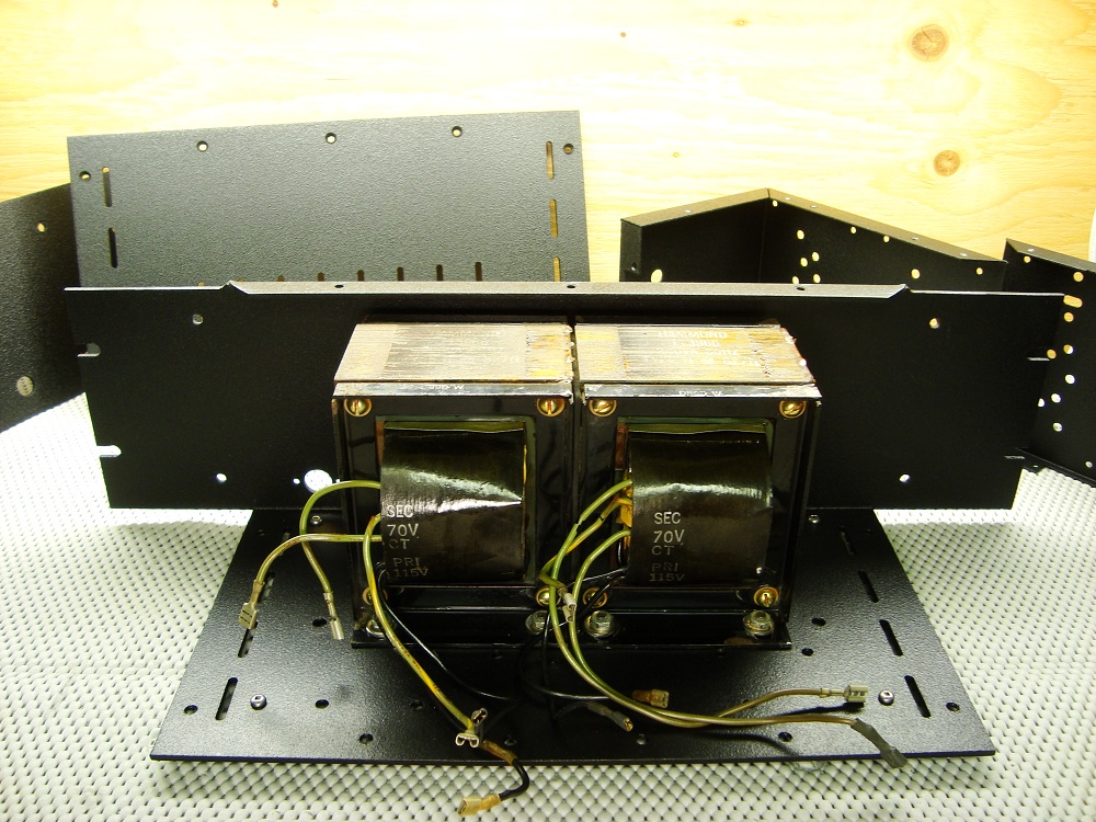

So I finally got the thing cleaned up. It sure was a lot of work. I have cleaned every part except the actual circuit boards. I will do them separately.
I fought in -20 weather inside of an improvised paint tent to get my polyeurea coating on. Barely got it done with out screwing it up. lol.
Here's a picture of the assembly started. I installed some new feet. If those Hammond transformers don't give you a hard-on there's something wrong with you.
Good for you GloBug. What kind of amp are you going to build with those transformers 70vac secondaries?

Bryston uses those caps in all the amps. make sure you get "ORIGINAL" caps, I have seen fake ones as everything else. you can try Panasonic FC or go crazy like me and get Mundorf Audio grade caps 125c for power supply, they are expensive but worth every penny.😉
Thanks for the tip!
The amp has Sangamos in there now. I don't think they are original, but the font looks fairly vintage.
They are 7500uf @50v.
They are in series of two, effectively 2 x 3750uf @100v.

The price is not too bad on those, I assumed they would be higher then most the caps on eBay. Not bad at all. I figured I would budget about $100 on P.S. filtering.
I am going to have to play around with the values. They do have 10,000uf @63v, I could use two of those in series for 5,000uf @126v.
I don't want to go to high over the original value, which I take to be 3750uf @100v per power supply. I should have a look at the schematics to make sure that is the correct value.
