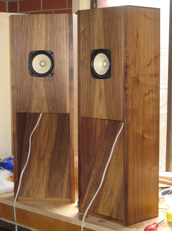

yeppers, she's actually quite a sleeper, and not bad WAF either - I've built 2 pairs of them. After auditioning the first prototype, my sister had me build her a real pair.
I played with FE126 & FF125K with some series R, but settled on ole reliable FE127E. (or if you can get your hands on a pair of Hemp Acoustics FR4.5)
sand / kitty litter fill the lower void

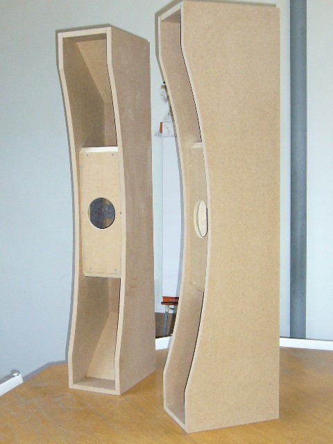

I build a genetic crossing between the curvy-chang and the brynn.
Tried different drivers , in exchange baffle front, FE126 and some others.
Now running Kef B110B and T27 with kef x-over. Everybody says STUNNING!!
Very high WAF.
They are suited for a lot of drivers, very forgivible.
Only a pic during building proces.
Very high WAF.

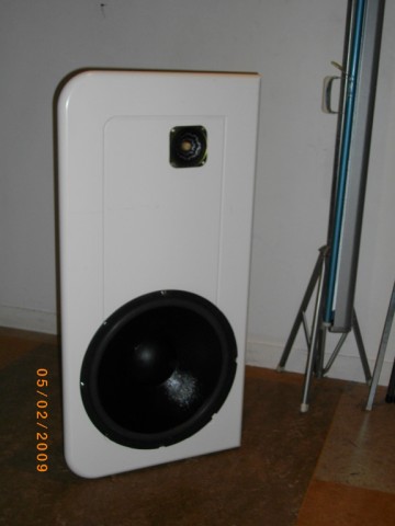

To Chrisb,
Neither, we have a store over here for secondhand stuf.
The supra-baffle's are beertray's , made from pressed wood , 25 cent a piece.
Most of the time I work backward, meaning ; I see a lot of things on this forum that I wanna try. Looking at stores I see things that are to be used for another purpose.
That brings me to ideas and then I adjust(size and recalculate) the original design.
For instance I replicated MJK's open baffle design after seeing pieces of an old bed.
They didn't have the right size, so I read Martin's article carefully and deceided to adjust the x-over components 10%.
They sounded terrific (=good).
Measured them with an old digital system called DAAS(german).
And this was according the theorie.
Sorry for the bad English, I do hope you understand my explanation.

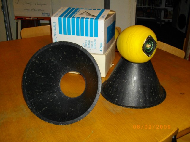

Or an IKEA bamboe pot , the hole(backside) had the right dimensions for a tube.
87mm foster unit(about fe83 foster) mounted in the bottom.
The conical "horns" , found them in the secondhandstore ;
50 cents each , simulate them in hornresp.
Are going to be fronthorns for lowther, filling in nice the acoustical hole ~250-1000Hz.

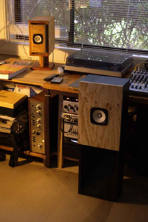

Yes I built a pair....... love 'em....pete
Completed Brynn's.
I had a listen a few months ago before they were oiled up and was uninspired to finish them as I'm not madly keen on the Fostex (127e) sound, preferring CSS FR125 in 12.5L BR cabinets.
They were a little nicer than when they were in a 13L BR with 2dB BSC but I think I just find the CSS a nicer all rounder (SPL's not withstanding).
I'll bring them in tomorrow and give them another run. It is a lovely looking cabinet shape though, and if you like Fostex then likely well worth the effort.
