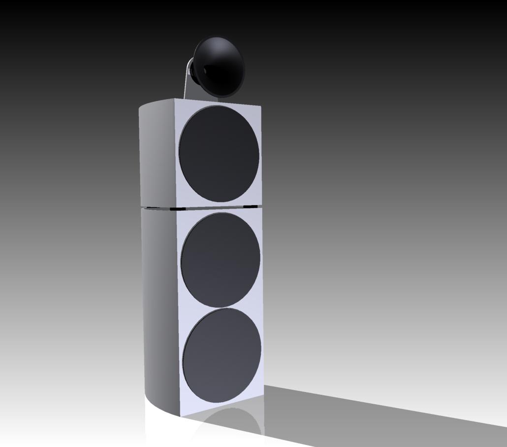

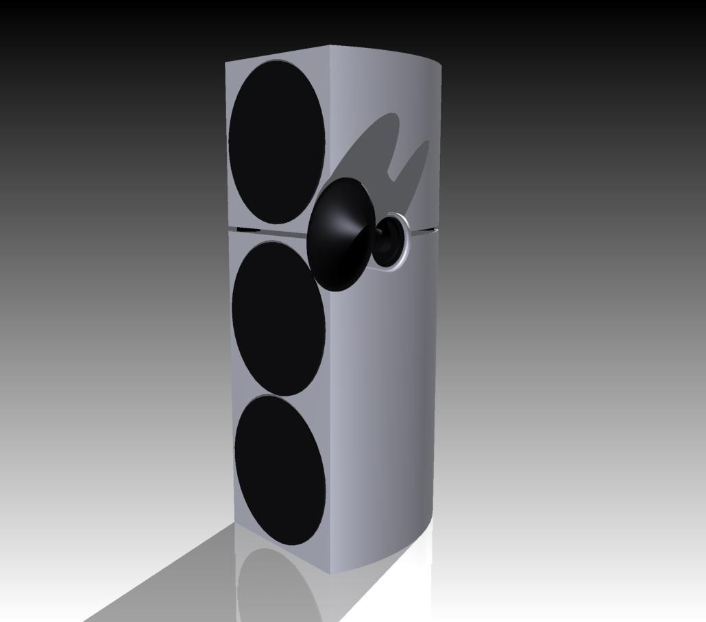

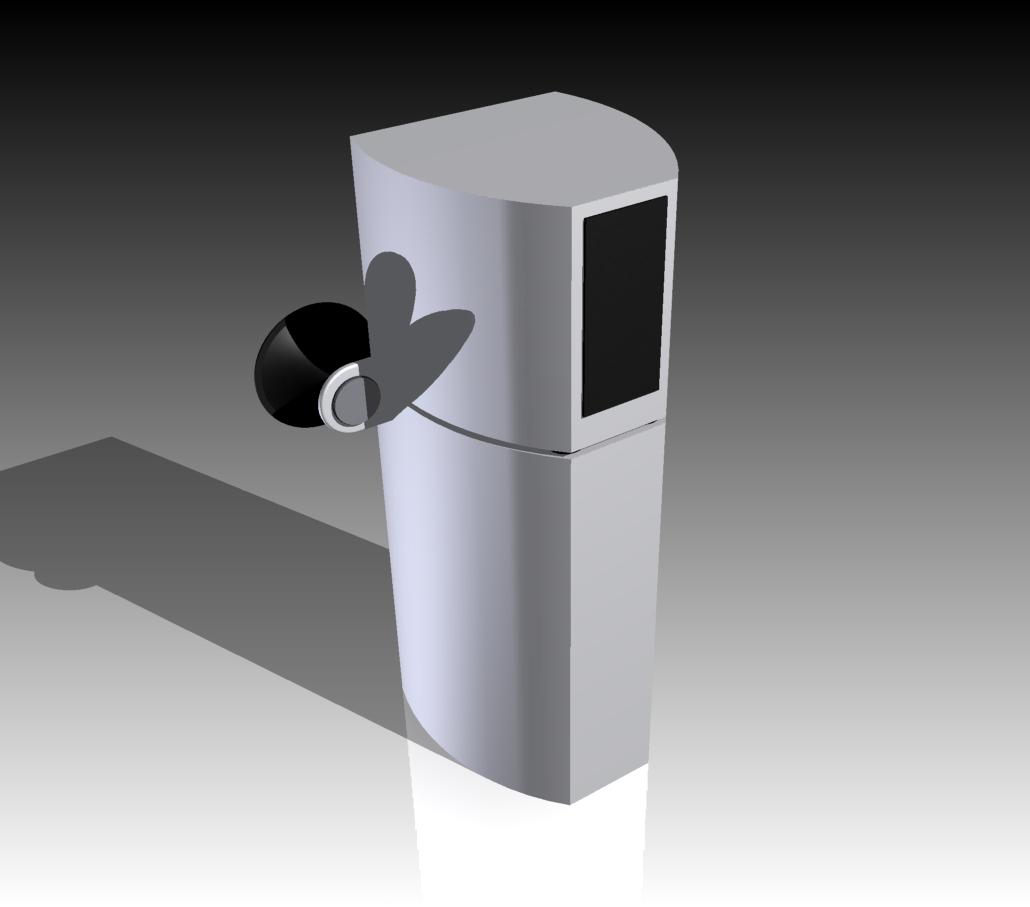

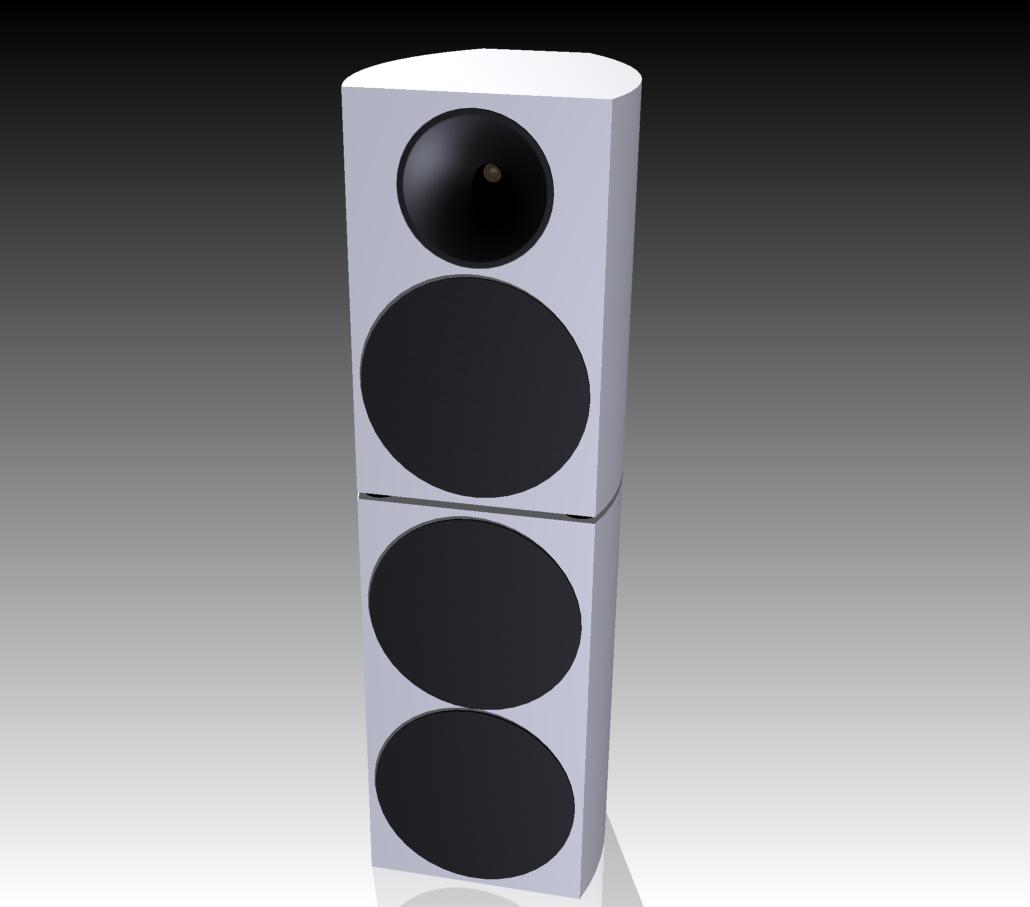

Hi folks, I have been busy some time with the concept of a pretty big loudspeaker that will make use of vintage Philips loudspeakers.
The loudspeaker will contain two 12" woofers, a 12" fullrange unit, and a polycarbonat dome combined with an 8" Dayton waveguide.
I allways wanted to make a "super" loudspeaker with vintage Philips stuff. The 12" fullrange e.g. is one of the best 12" fullrange units out there.
One of the main things is to not make a "huge" cabinet, the only concept for the two 12" woofers is to put them in a highpass filtered closed box. This way the enclosure for the two woofer will be about 70 liters. The 12" fullrange unit will have an open enclosure that will be damped pretty heavy.
On a dutch DIY site I have explained the whole concept, I will translate the most important parts and will put them on this forum. For those who want to take a peak of the concept here is the link forum.zelfbouwaudio.nl • Toon onderwerp - Philips 2x12"woofer, 12" breedbander en poly-dome (Tractrix) . Allthough it is in dutch language there are a lot of pictures of the units, measurements, simulations and the design that will speak for themselves.

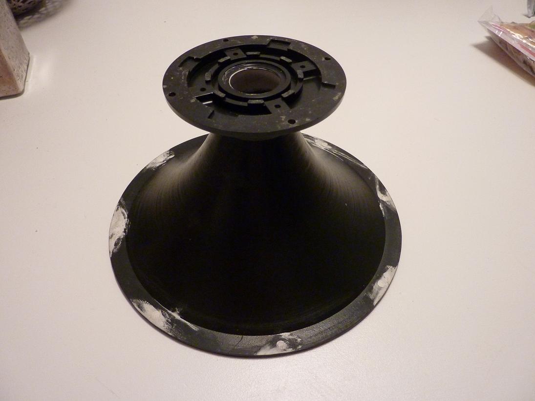

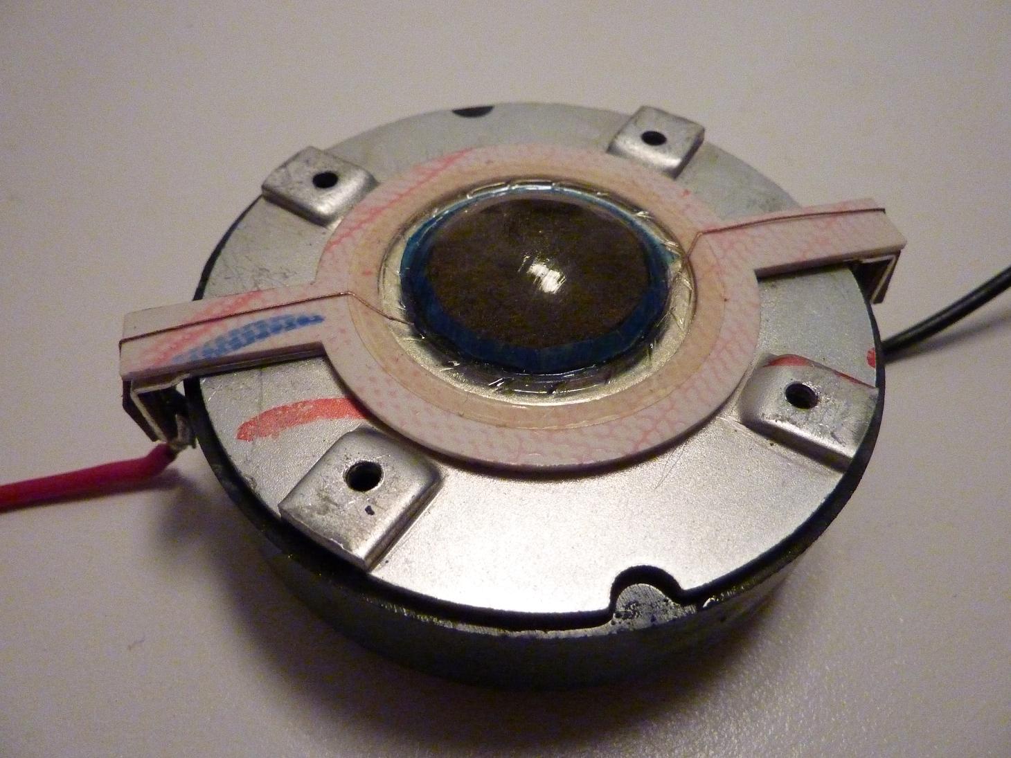

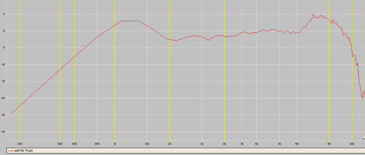

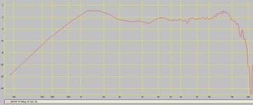

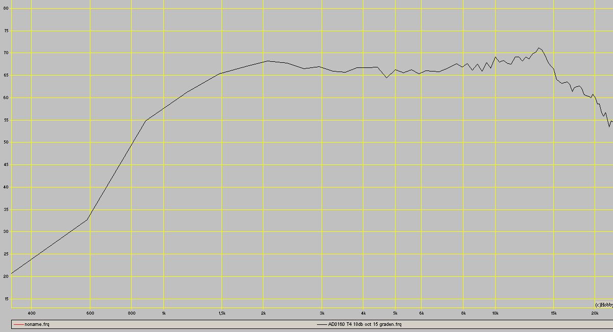

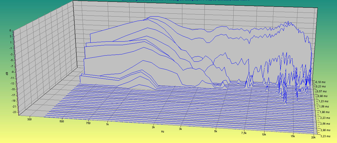

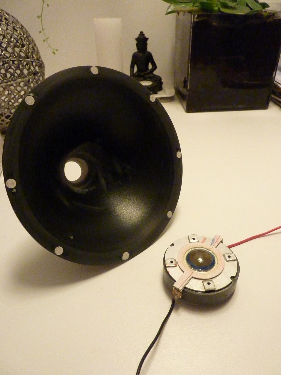

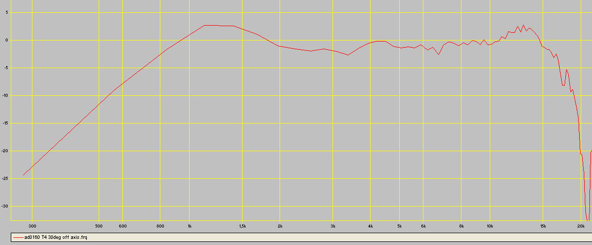

Here are some pictures of the AD0160/T4 Philips tweeter and the 8" waveguide.
You see some measurements of the original(unmodified) tweeter, damn good for a 40 year old speaker😎
To make it perform better I changed the damping behind the dome with felt, this smooths out the high peak around 14khz.

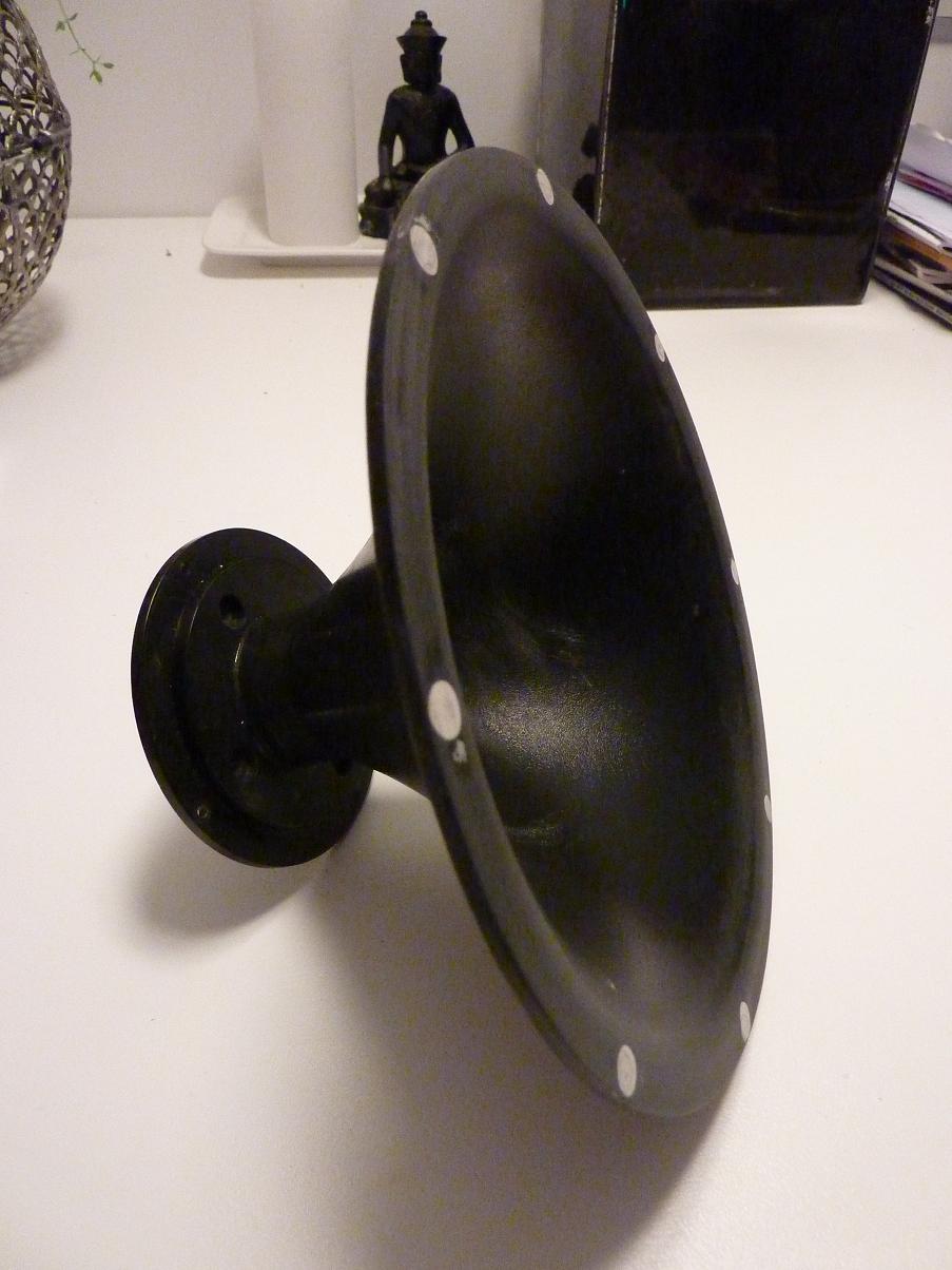

Tweeter+waveguide

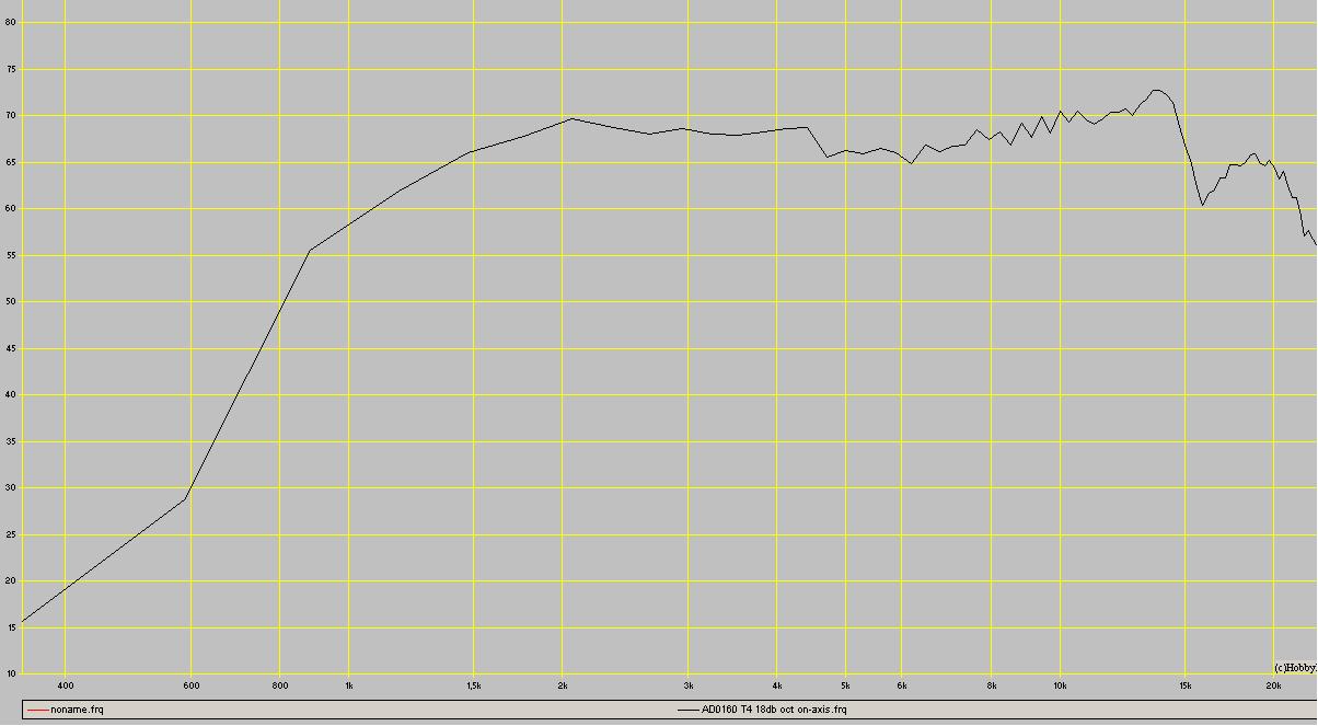

It took me some time to smooth out the transition between the faceplate and waveguidethroat. The measurements of the tweeter and waveguide are with a xover (18dB/oct). The xover would normaly make for a xover frequency of approx. 4khz, but with the waveguide it is 1.3khz😎
On axis the top end(above 10khz) looks a bit nasty, but the more you move off-axis the smoother it gets.
And how does it sound? I made a test setup with the Ad12100/M8 fullrange driver and the tweeter+waveguid crossed at 1.3khz. Man, it sounds great! Very life like and lots of detail. All I can say that the sound is addictive, I still want to listen to it😀 I have made speakers with other more expensive drivers but they don't sound nearly as good as this.
Tweeter+waveguide

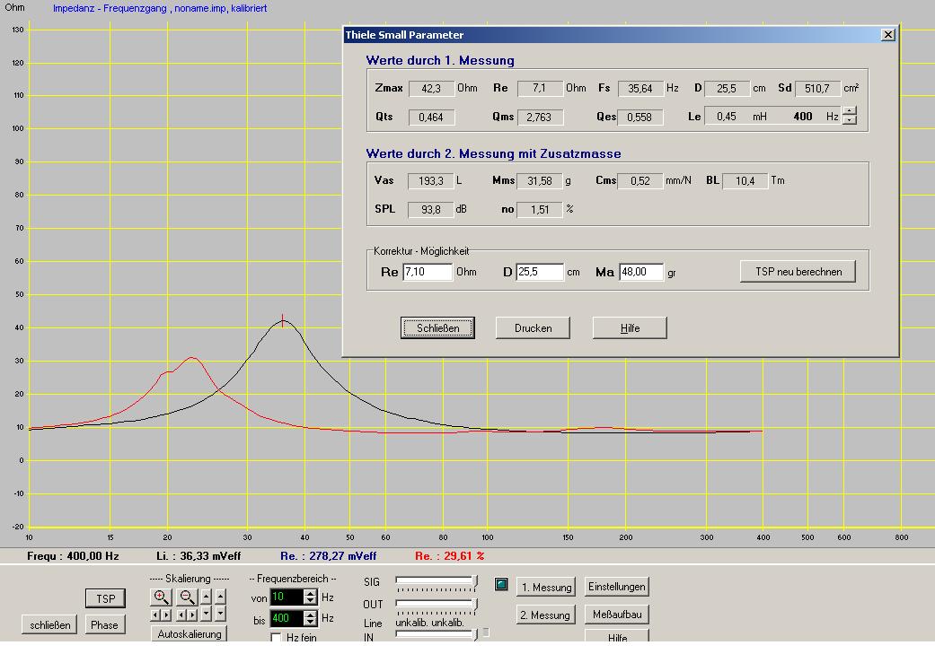

have you , by any chance , measured T/S for 12100/M8 ?
You're in luck, yes I have😎
Thiele Small Parameters AD12100/M8
Fs 36Hz
Re 7,1ohm
Qes 0,558
Qms 2,763
Qts 0,464
Vas 193,3 ltr
Mms 31,6 g
calculated Rms 2,59 kg/s
Spl 93,8 dB

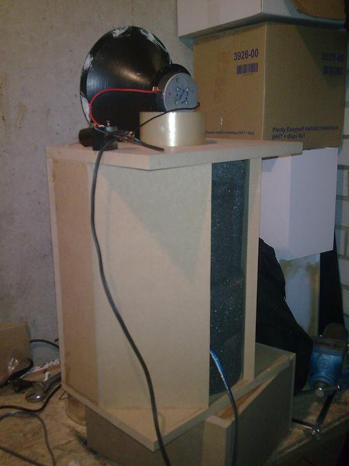

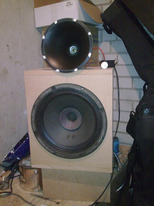

Here are two pictures of the test setup I wrote about earlier😀
It looks awfull, I know, but it was all about functionality. The AD12100/M8 speaker is in a tapered open enclosure, the perfect cabinet for this driver. It doesn't produce any deep bass(that will be done by two other 12" woofers) but the mid/bass that's coming out of this setup is amazingly punchy.
The Ad12100/M8 is filtered by a 3,3mh inductor and a notch to dampen the 2khz bump thats created by transition of the cone to the whizzer cone. It couples perfectly at 1.3khz with the Ad0160/T4 in the waveguide. Soundwise it's very open, detailed and voices sound very, very realistic. I invited some musicians to listen to it and they were amazed. One of them has Dynaudio Studio monitors, he said that they could not produce such a life like experience😎

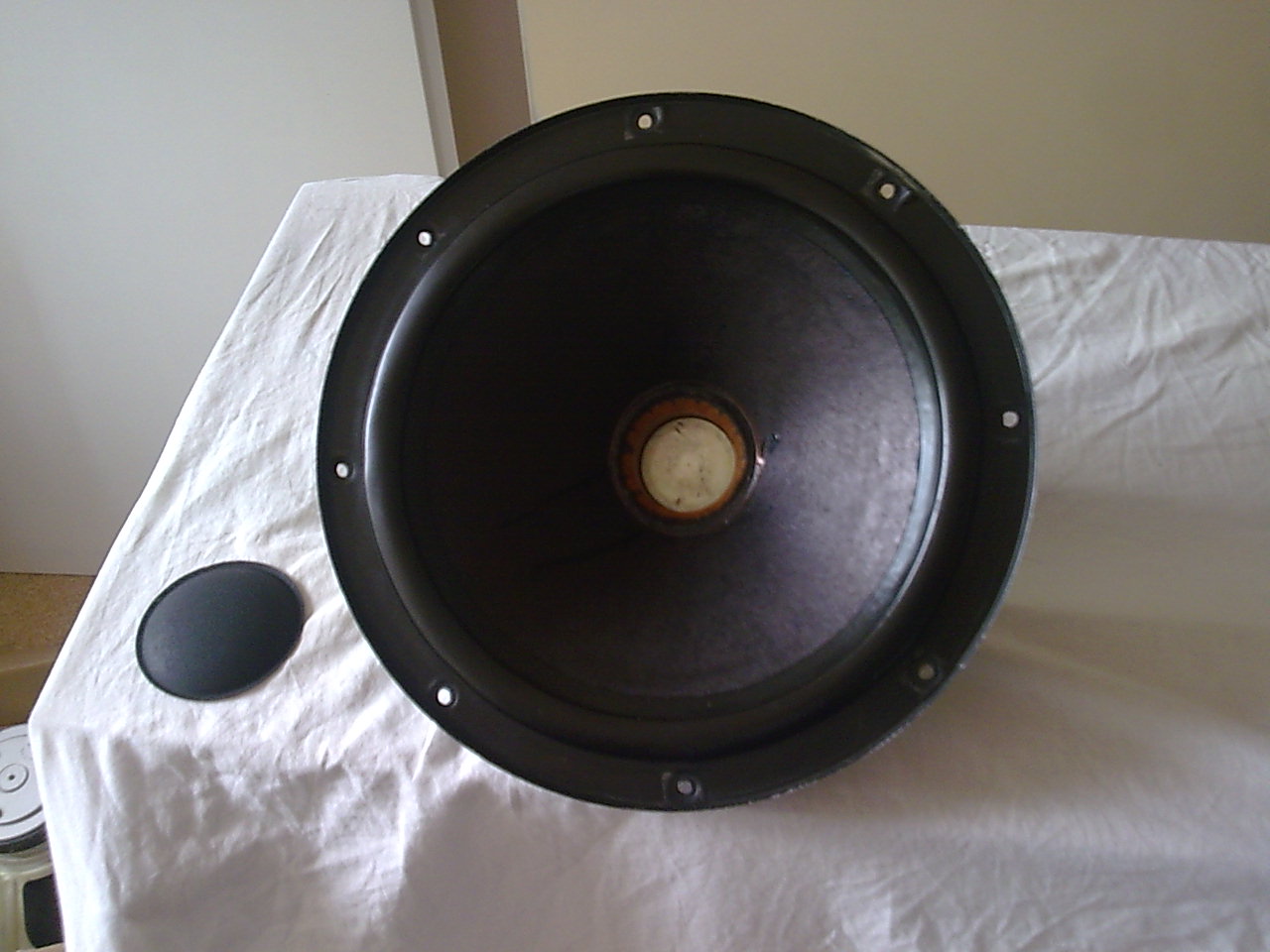

The low-end of the concept.
In the design I will use the AD12100/W8 and the AD12200/W8.
The AD12100/W8 is a 12" woofer from the early 70's, it has a nice rubber surround, a 2" voice coil, a paper voice coil former, 5mm xmax
The AD12200/W8 is a 12" woofer from the early 80", it has a rubber surround, a 2" voice coil, a aluminium voice coil former, 5mm xmax
After measuring the AD12100/W8 I noticed a pretty low Qms (means high mechanical losses) allthough it has a paper voice coil former. After swapping the dustcap for a porous one the Qms got twice as high😎 After the modification the calculated Rms got as low as 1,85 kg/s, which is very low for a 12" woofer. Below you'll find the TSP's of the original and the modified AD12100/W8 as well as the TSP's of the AD12200/W8.

Hello Dave, the waveguide is the one in the followinglink Dayton H08RW 8" Round Waveguide 1" Threaded | Parts-Express.com
Actually it's more like a Tractrix horn then a waveguide, which is good.
To make it fit you need to cut of the threaded part, after that you can glue it to the faceplate of the ad0160. To make the transition smooth you need to use some filler or other stuff to fill up the gap.
With the 4ohm version of the tweeter you can start with a 12db/oct filter with a 6,8uf cap and a 0,39mh inductor. This will give you a crossover point of approx. 1.5khz.
If you have any questions, please feel free to ask.
edit: to make the AD0160 even a better tweeter you need to disassemble it and put a fellt knob on the polepiece, this will reduce resonances of the poly dome against the pole piece.

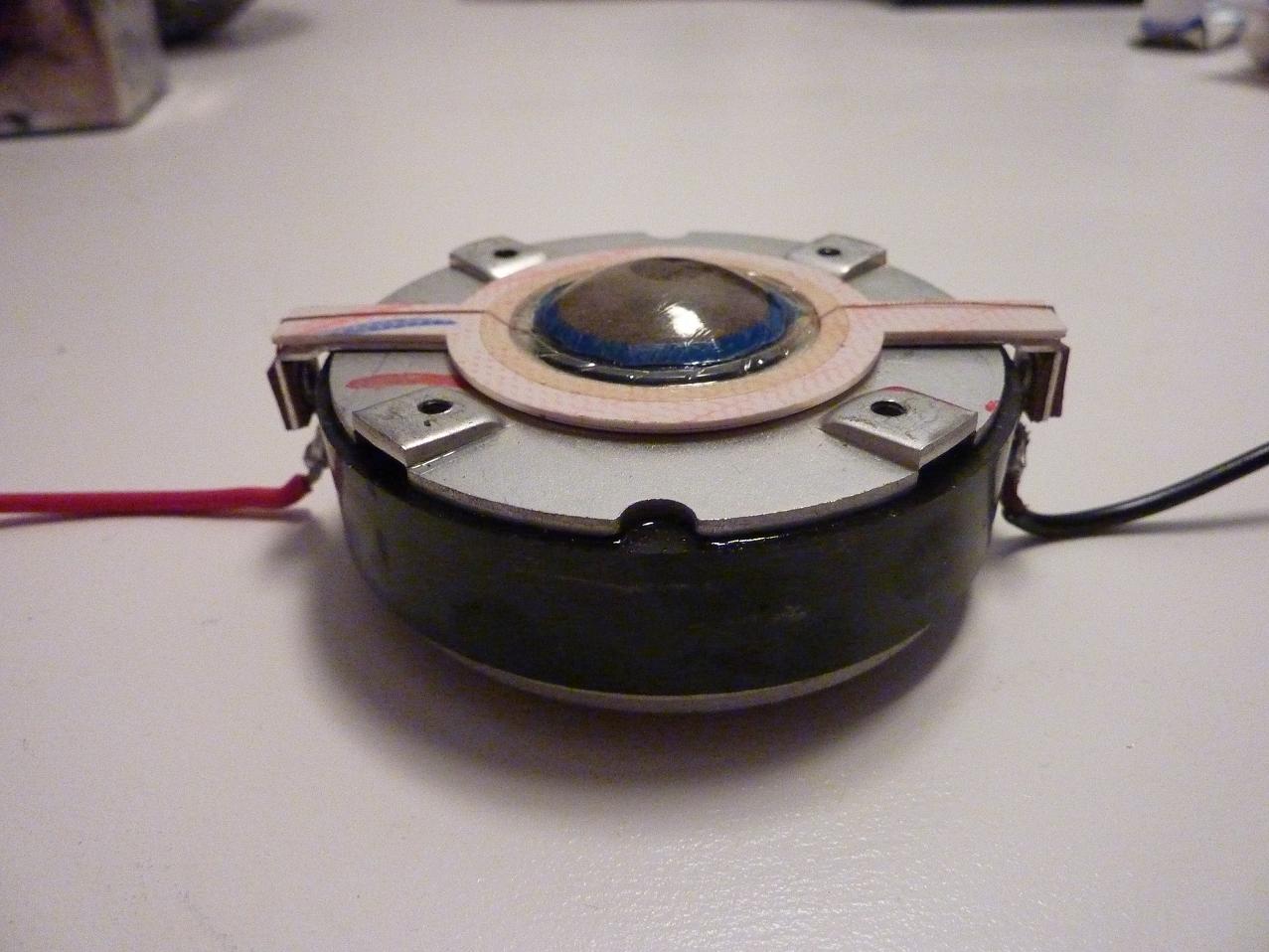

Dave and other people who want to tweak their AD0160's, disassembling the tweeter is a bit tough. The dome itself is attached to a glassfiberframe which sports a metalring. This metalring, you allready guessed it, sticks to the magnet and it's a bit tricky to remove it. Try using a small screwdriver to lift one side of the glassfiberframe, then put a small stick or someting underneath that side. After that, lift the other side. This way you can remove the frame without damaging the construction(it is pretty sturdy though).
Ones removed you can add a self sticking felltknob on the polepiece. You should also make a small hole in the center of the felltknob because the polepiece has a cavity to increase the volume,
