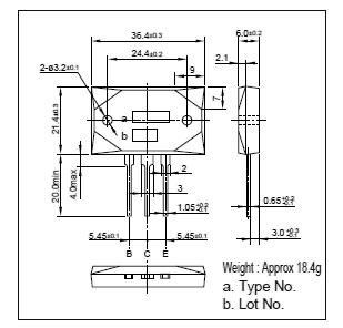

the back is usually connected to middle pin = collector
for power transistors
so beep from middle pin to back is okay
those with beep from back (or middle pin)
to the outer pins (1,3 =base,emitter)
might be shortcircuited, and defect

Here you can find datasheets
to see what is the
B - base
C - collector
E - emitter
of the Sanken 2SC3264 and other
http://www.datasheetarchive.com/search.php?q=2sc3264&searchtype=default&p=1
They are very good and big power transistors 😎
