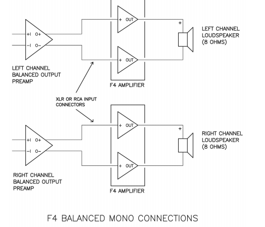

No - I refer to this picture in the F4 manual -- where Nelson specifically states that either XLR or RCA single ended connectors can be used to BRIDGE.
And I believe the schematic above will not work as it shorts the phases together......although I'm not sure, that's why I'm asking!
The preamp on that diagram says balanced.
Of course you can use any connection you like. You could even use BNC connectors.
There is nothing wrong with Nelson’s diagram.
