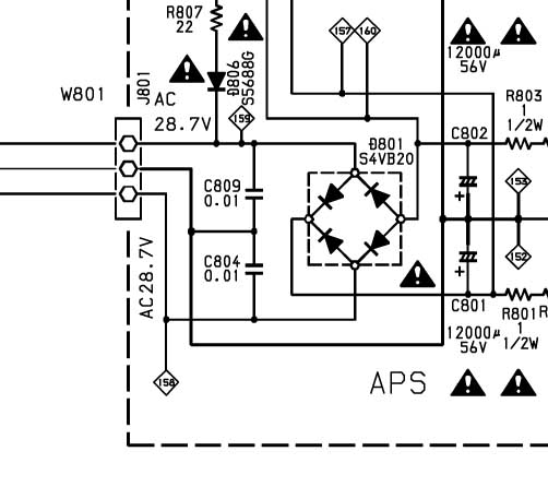

The Bridge Rectifier in the power supply of my Marantz amp is physically damaged. It's a square shaped part from Shindengen, 200V, 4 amp.
Could someone with more knowledge than me tell me if I have to replace it with the exact same value? I see for example that Radio Shack have a 200V 6 amp rectifier. I just want to put something in the circuit to see if it will work.

You're fine, and thinking correctly.
You do have to ask yourself though... why did the rectifier blow? You might want to probe around on the rails and look for more shorts/failed comps...

Well...I'm embarrassed to say that at one time I took the two large caps out of the board and then replaced them..don't ask...and at that time I knew nothing about polarisation. So if I had them in the wrong way could that have damaged the rectifier?
I'm taking baby steps here😉
Schematic attached.

Did you replace the caps with larger ones (ie. more uF)? In that case you get higher charge currents and may need a bridge with higher rating.

I replaced 12000uF 56 V caps with 10000 63 V Caps.
Should I adjust the Bridge Rectifier..I was going to use a 200V 6 Amp from RadioShack.

Well, since you replaced with smaller caps, that is probably not the reason, although it could be if they are better (lower ESR) and the bridge was designed on the limit. However, that is probably not the cause of the fault in this case.

If the polarity of the caps was wrong, that might well have damaged the rectifier. Unfortunately, it might also have damaged the caps🙁
If the polarity was wrong... it may take 20 minutes or more but he caps would have exploded! You would have known!
This could be just a simple rectifier problem... but you should look for other problems first...

20 minutes! In my experience incorrectly polarised caps blow at switch on, and what a bang and mess they make!
The bridge rectifier you intend to use will be fine. I would look to increase the capacitors back to the original value of capacitance though, usually going down in capacitance is worse for performance.
