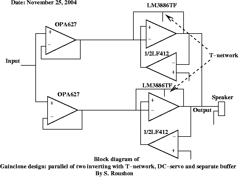

Block diagram of my design
I am posting the block diagram of my gainclone design using LM3886.
More details schematic will come soon. Please have a look and give me your suggestions....I will include acknowledgments and thanks to all the people I got help and suggestions form when I post the detals schematic....

I am following the application notes AN-1192. Yeah, I will try the circuit without the DC-servo also. I see in AN-1192 that in the case of parallel of two inverting design the cap between buffer and the amp is used only when there is no DC-servo. I think that is what you mean.
regards

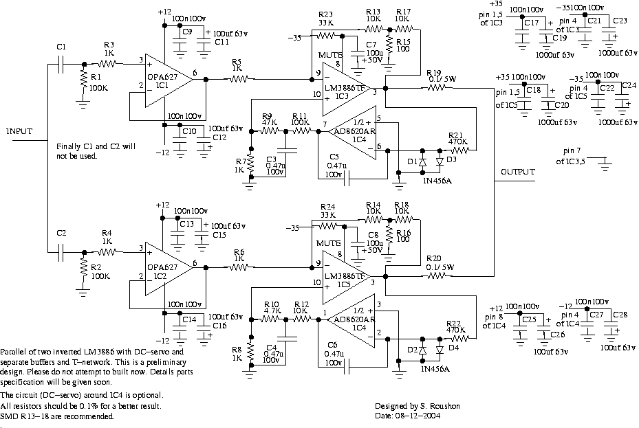

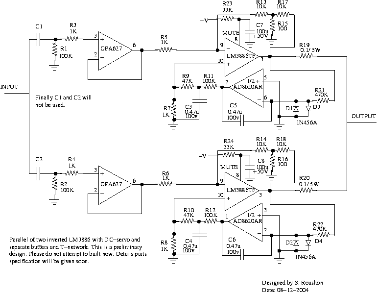

Preliminary design
My preliminary design of parallel of two inverted LM3886 is attached. Looking forward very much to your suggestions and kindly point out any mistake you find in it.

no mistake found so far...it seems....so i can go ahead and build it. this is the only way i can test it since simulation is not possible in my computer.

Upupa Epops said:
Only little notice : Input buffer can be common for both amps. Voltage divider on output of servo is too high - give there ten times lower value - 4K7 and 10 K. 😎
i am experimenting with separate buffers. i know this makes the circuit expensive to build. but i have all the ics needed, so i will try. thanks for the suggestion about voltage divider resistors. i reduced it according to your suggestion. a little update of the circuit is attached. i will have lm338 regulated power supply for lm3886 and lm317/lm337 regulated for opa627 and ad8620ar. the power supply design will be posted shortly.
still waiting for more suggestions/corrections before i design the PCB.
