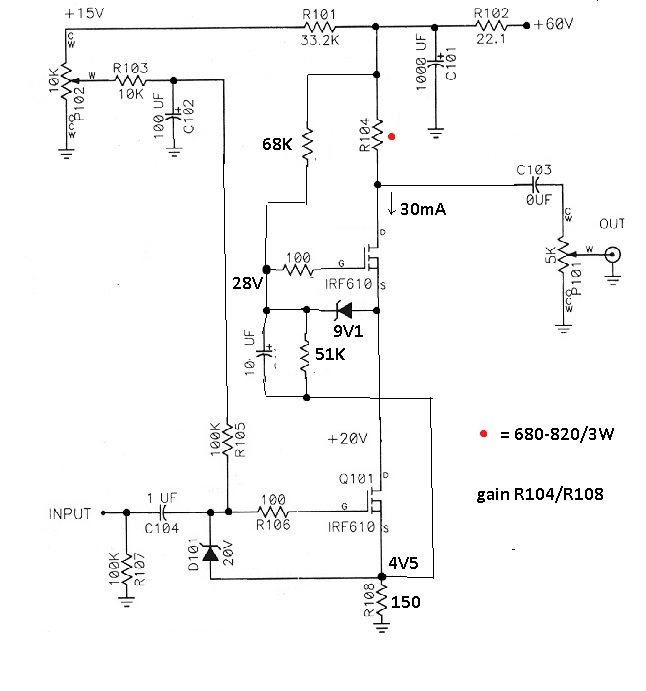

use any of them
post schm and I'll show you how to make cascoded one
in a meantime , read this http://www.firstwatt.com/pdf/art_cas_amp.pdf

Hello, Thank you very much indeed ! 1st problem solved !
i am not sure what you mean ... the schematic is the one available in the net here below. I hope that the pcbs are built accordingly.
and all other articles at FIRST WATT ARTICLES

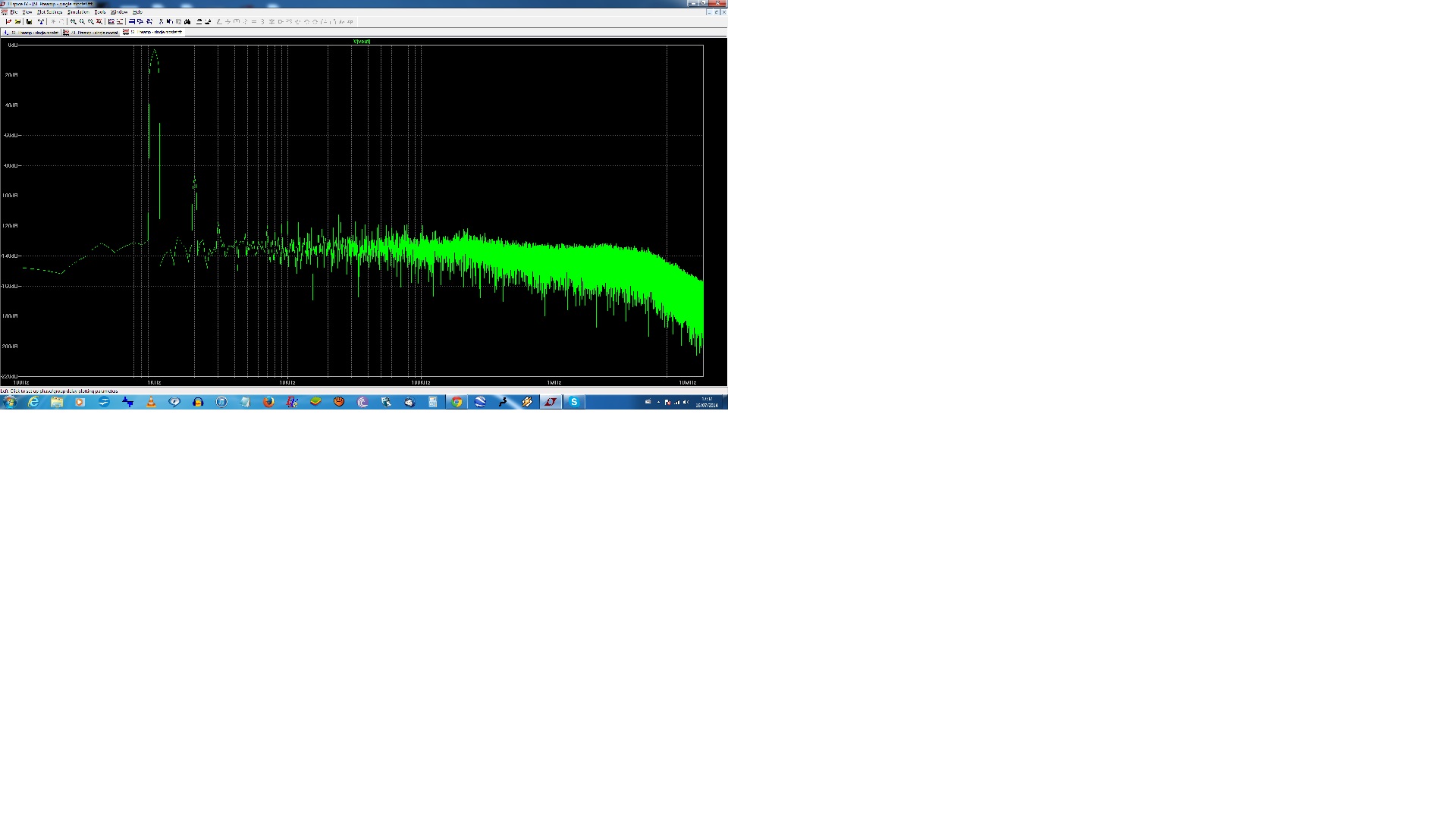

Wow ! very impressive distortion spectrum 😱
I am exclusively interested in line stages for now.
And do you think that is possible to mod the original schema to cascode ?
It looks a little complicated to me ... but the trace on the scope is very impressive ... completely clean !
Thanks and regards, gino

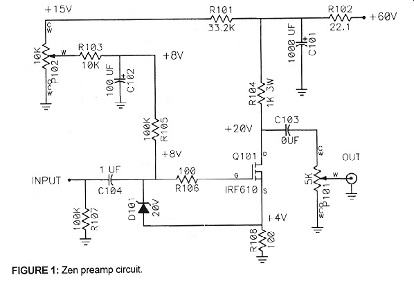

Hi and sorry to bother you but i have another question.
I have received some pcb for the BOZ and i decided to go with the original design ... but with possibly some changes.
Looking at the original schema here below, if i understand correctly the gain is 10 (i.e. R104/R108) and the out impedance 1kohm (i.e. R104)
is it possible to decrease the gain at around 2 and the output impedance at around 500 ohm ?
Which components i should change ?
My idea:
R104 = 470 ohm
R108 = 220 ohm
Vsupply = 48V
This shoud give gain around 2 and out impedance = 470 ohm. Am i right ?
Could i keep all the rest unchanged ?
Thanks a lot. Regards, gino

when you change the resistor values you also change the bias current.
you will need to re-set the bias to obtain ~16Vdc at the output, based on Vcc=48Vdc.
That will push twice the current through the 610 and make it dissipate nearly twice as many watts.
The source resistor may require to be changed to suit the new dissipations and that would change the gain from your desired 2times.

Hi and so i am right to ask why the gain in the BOZ is so high ... but i understand i am the only one feeling the problem 😱🙁
Maybe it has been designed with low gain power amps in mind ?
Thanks again, gino
the output impedance of 1k is high.
OK it is less than the maximum of a 10k pot, but it is high.
It might be better to put the vol pot after your BoZ and add a buffer after the vol pot.

Personally i would prefer to have a pot at the input and a amp stage after, as usual without input buffers
I think that changing Vsupply and some resistors value both out impedance and gain can be decreased
Moreover i have seen projects on the web, less refined i suppose, where the bias for the mosfet is set with a simple voltage divider
So 4 resistors, one mosftet, two caps should make a stage
This evening i will see if there is the 610 model in LTSpice
On the Vishay site there is but i have problem in importing it in the program
I usually make a mess with this sw ... 🙁
Kind regards, gino

Instead i was thinking to something really basic like the schema attached
From the fft it has only some 2nd order distortion (nice) and minimal 3rd order
I understand that one thing is the simulation another one the actual performance of a prototype ... but this is what i have in mind
