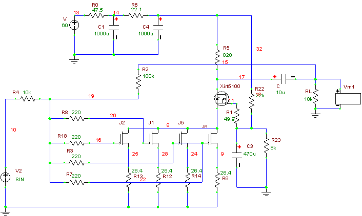

Years ago, I built the BOZ, but with some slight modifications to the power supply. Very nice sounding preamp.
I never used the BOZ PCB I got from AudioXpress.com and right now I've almost got a cascode version of the preamp working using the stock PCB. It uses 4 BF862 JFETs cascoded with an IRF510 Mosfet per channel.
I accidentally adjusted the bias potentiometers wrong which put too much voltage across BF862 JFETs and fried all of them. 🙁
It's kind of a G.Rollins SSTART preamp, but biased differently with different JFETs and it uses voltage feedback. Measures nicely in SPICE ... should sound good, but we'll see.
I'll post the schematic later, when I have time if you like?

Here's the circuit, as modeled using the Linear Systems LSK170C, though I'm actually using the BF862. I've haven't got it working again yet since I fried my JFETs last time. So, this is an untested and not listened to circuit. I plan on getting it wired up again soon maybe this week.
attachment.php
That DoZ looks nice and is simpler and easier to wire up. I might also try that. Thanks Shaan.
