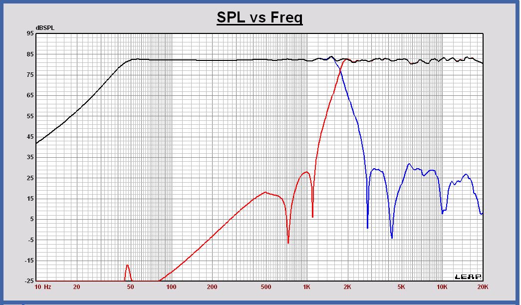

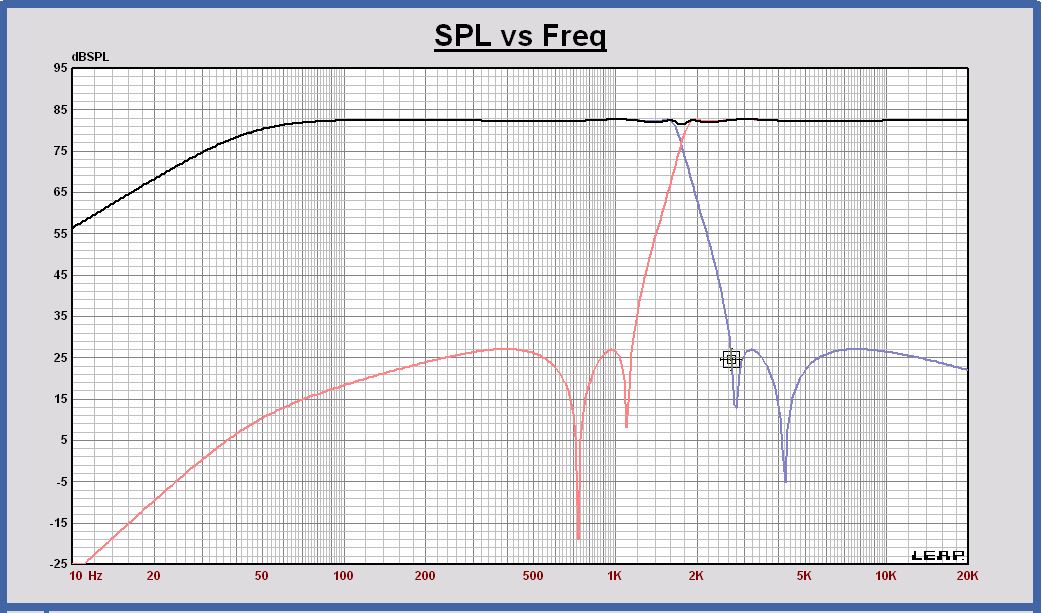

With miniDSP it is possible to realize elliptical filters. I already made 3rd order and 5th order designs.
See an example in the plots of a 5th order design of a 2 way system crossed at 1750Hz, the targets and the practical realized design.
The 5th order filters have a fall off in the stopband of 80dB/octave and the outband reduction is -55dB.
I do the design in Leap CrossoverShop with analog functional blocks and via a bilinear transform the coefficients of the biquads for miniDSP are calculated.
If no SPL equalizing for the drivers is needed, 3 biquads are needed to realize the basic elliptical filtering for a 5th order filter.
IMO elliptical filters sound very nice, but you have to make the design very accurate. Together with a friend I realized a 5th order 3 way design with very good sounding results.
So, if 5th order elliptical is brickwall enough, it is possible to realize in miniDSP.
Even a higher order filter is possible, but then the groupdelay will peak more at the crossover frequency, even too much.
