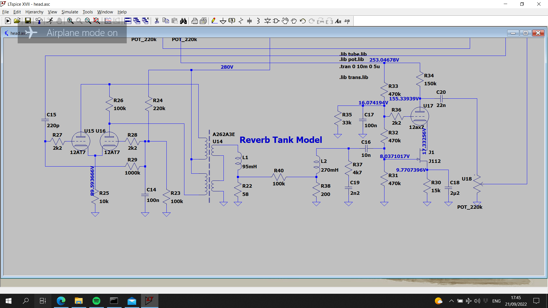

Hey,
Thanks for your work.
I manage to create the ltspice model for your .cir file but the outpout stay at I and V = 0 with or without load.
Could you provide a minimal working exemple of your circuit ?
Thank you.

Hi Tom
Sorry for my late reply - I was OFF for the last 3 days. When you provide me an email address of you, I can send you a tested/working Schematics example (.asc file) containing my reverb spice model, ok?
