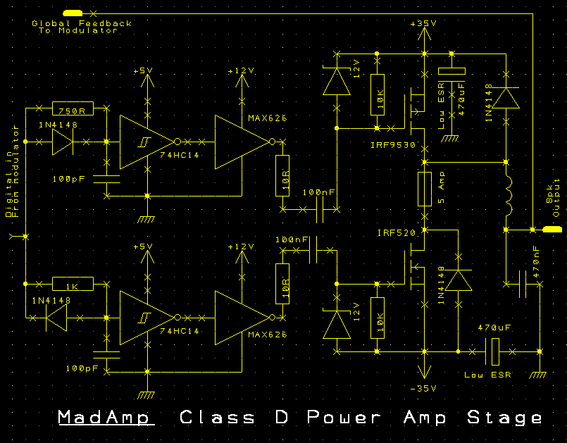

My dead time is set at 50n/s, looking at the bridge on a scope this clears the switching by about 25 n/s, considering the rise/ fall time of the bridge is about 10n/s i thought this was a good time to select, not too tight not too sloppy. I read recently that a dead time of 60n/s can cause up to 10% distortion while tightening the time to around 10 n/s lowers this figure to 0.1% Do you think i sould tighen things up or just leave them😕

By the way, do you really mean 500uH for the output inductor? They're usually more like 22uH or 33uH.
AC hum is definitely not caused by the board layout but due to the fact the a class-d amp directly switches between the noisy supply rails. It is greatly reduced by NFB though.
But the hiss can be caused by bad layout (transient overshoots reaching the modulator) and use of breadboard. A class-d amp is an EMC hell and therefore great care of layout has to be taken. The PCB is one of the most important electrical components of the amp and it has to be designed and made by YOU. That's a major problem when it comes to the development of class-d amps.

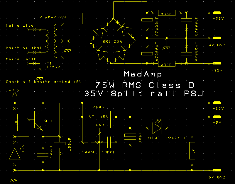

This overlooks the temperature of the mains transformer though, it's just a 45 VA center tap with 8200uF on each rail or so, plus whatever decoupling on the board.

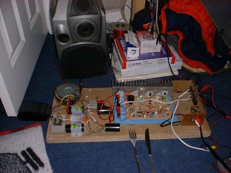

Here is a taster of the amp, you will have to wait till saturday for closer pictures and the schematic as the battries have just died in my camera and i'm off to the pub soon so i'll draw up the circuit for you all tommoz... enjoy and don't kill yourselves laughin 😀
It looks to me as though you've taken some care in layout, nicely done. That's a great way to do the heatsinking, even of the mosfets heat up they won't melt into the board and short with anything.
My only real concern with your set up is that fork and knife, hope they aren't your test probes.

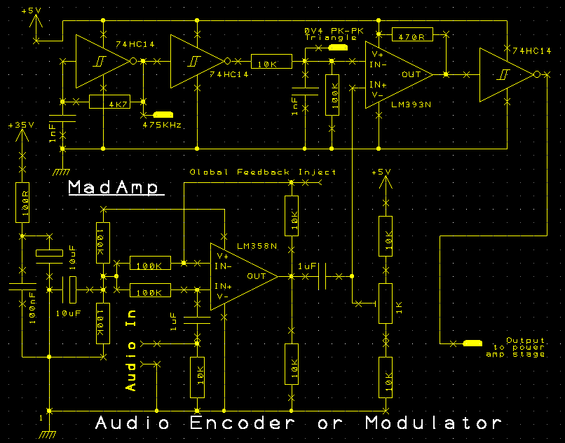

Hi all,
As promised here are the schematics and pictures of what i've got so far, i know there are improvments to be made, i'm getting round to them. I want to ask everyones advice here, what do you think of leaving the twiddly pot in the design? The blue pot is there to adjust the DC bias of the amp at the speaker output. It seems stable at the mo, but i would rarther add on some kind of self-biasing circuit, just got to think of a good way of doing it so it will start up safley. If you think its o.k however i will be tempted to leave it as it is. Let me know. Also is there any reason why i should not be using as much feedback as i am? It is perfectly stable and well away from any signs of oscillation but what effects can it have on the sound quality? After all that is why i'm using it, to remove any non liniarities in the output filter and to reduce hiss to an undetectable level
Here is the power supply circuit:-
