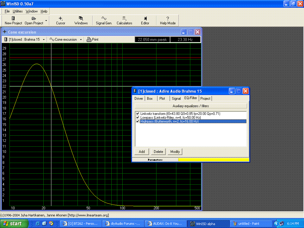

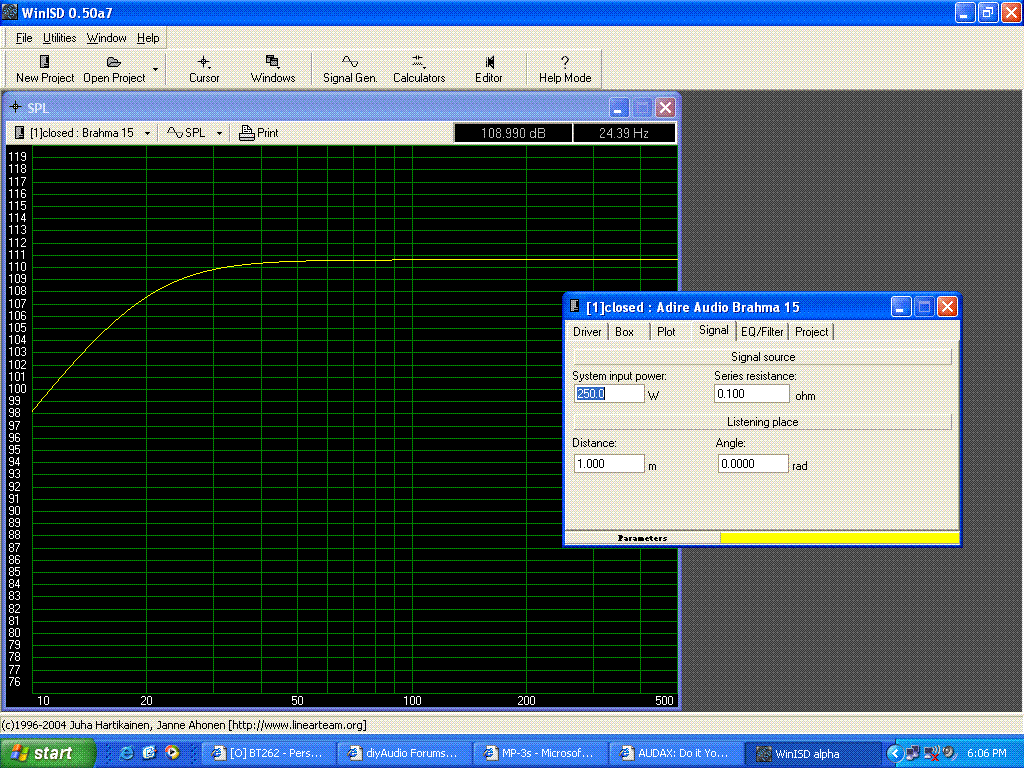

The box is 60 liters. Attached is the WinISD model of the SPL with 250W. Above 250W I reach max excursion.

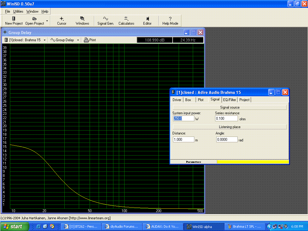

One thing that bothers me is the group delay when I apply all the filters. WinISD predicts 32.8m/s at 20Hz. I plan on running on my filters actively, but my understanding is that the phase shift will cause group delay even when using active filters. Is this correct? Any suggestions?
yes group delay is related to phase shift😉
Dont worry about phase graphs,not many people can even interpret them.

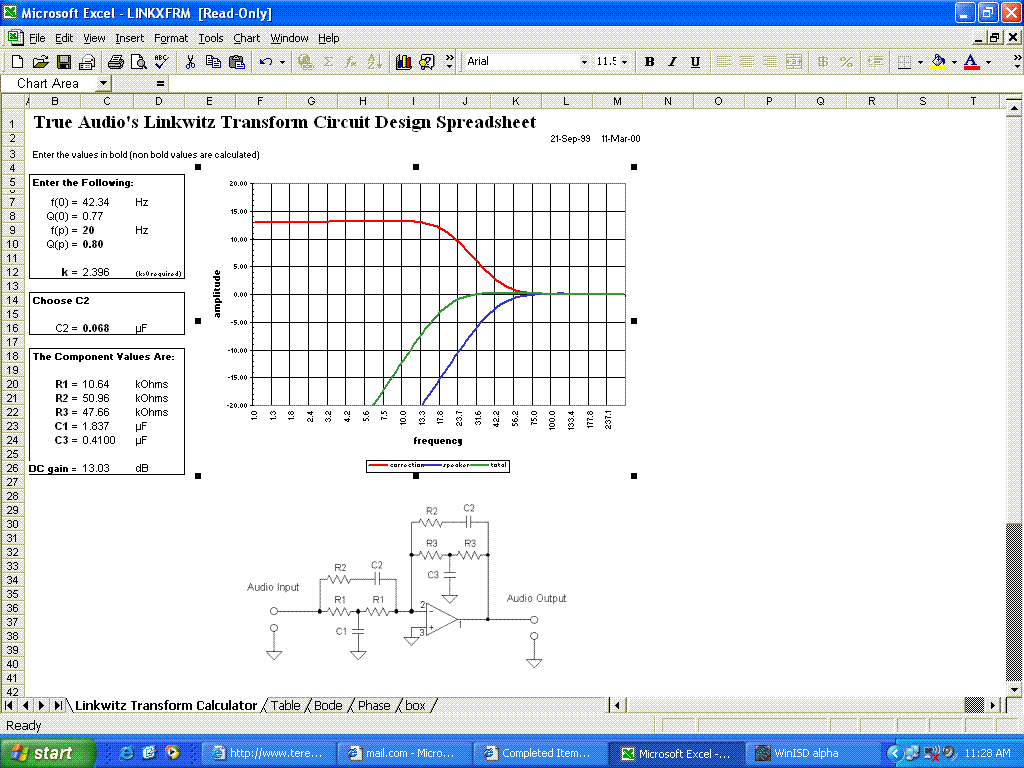

True Audio's spreadsheet calculates a 12-13dB gain at 20Hz (see attachment). Ouch. However, Rod Elliot's page implies (as I read it) that the amp will not be required to crank the full EQ power RMS as much of the signal demands appear as transients and much of the low bass in music occurs at a lower volume. Unfortunately, he doesn't expand on this as far as I can tell, so it has left the actual power requirements as a bit of a mystery to me.
Also, I plan to use this sub strictly for music, as I have a ported Brahma 12 that I use for home theater. The Brahma 12 models a group delay that climbs steeply into the upper 30's m/s at 20Hz. I wanted to build this sub partly to compare a low group delay sub to the relatively high group delay of the Brahma 12. That is why I was so concerned about the GP and phase shift.

i dont know wtf you did in your WinISD but in my WinISD you dont reach 28mm one way untill 2000w in a 60l box....even if you forgot to hit one of the 0's, ie 600l box (HUGE) untill a 500w input and you only reach that at 10Hz..... at 20 you need 800w...but then agian WinISD is Ghey.....:xeye:
The TrueRTA spreadsheet doesn't predict a phase curve. The 3 curves are the natural FR, the EQ curve and the FR after EQ is applied to the signal.

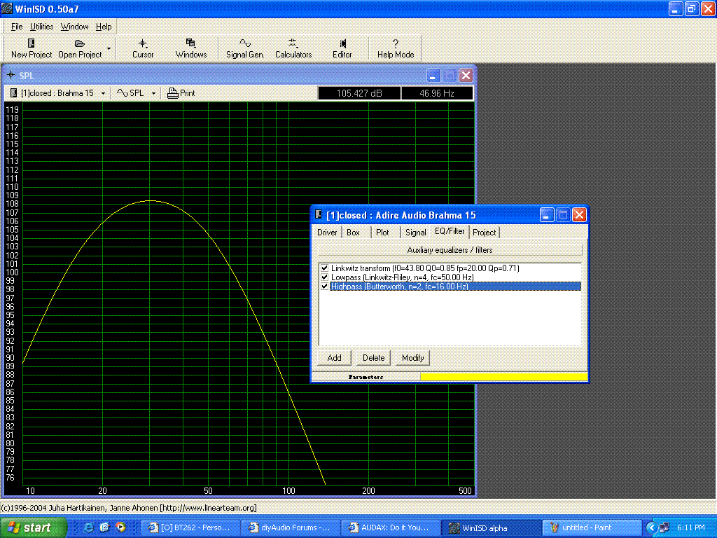

I would not use a HP filter in a sealed design...defeats the purpose of choosing a sealed alignment for it's low GD. The Brahma 15 in 2 cubes won't require protection.
If your L/T boost is 12 dB @ 20 Hz, then at max SPL (about 108 dB @ 1 meter), you'll require 250 watts X 16 (12 dB=16 times), or 2,000 watts to maintain a flat response to 20 Hz.

A Brahma 15 in 2 cubes with 12 dB of L/T boost (and final 'Q' of .5) is an excellent music sub design. I have a couple of them around here and I power them with around 1,400 available watts each. Seems to be a good power plant for the design.

My True Audio calculations were for a final system Q of .77, which I believe is the default for the spreadsheet. I see a final Q of .5 trades a bit of SPL (about 3dB) for lower group delay. I will give that a shot as well.
