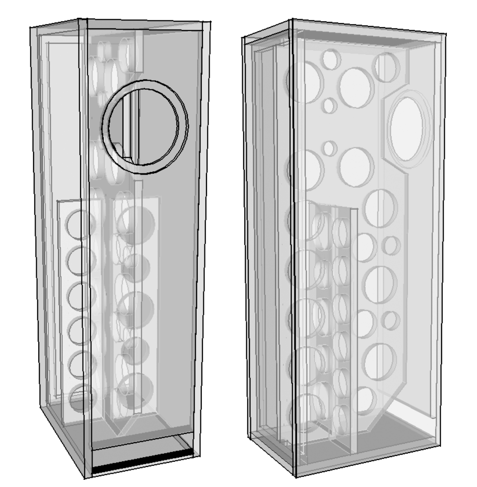

I’m building a pencil cabinet for alpair 10.3 drivers.
Here is a schematic of the bracing
Will it interact the longitudinal standing wave?
Also, should the stuffing be equally spread in the whole volume of the cabinet?

As Dave said, longitudinal is [much] preferred. If you must use window-braces, try to use an oval / elliptical form-factor rather than multiple rectangles to reduce potential distruption to the longitudinal standing wave, but changing the orientation of the bracing is going to be much more effective & also offers the potential to [lightly] brace the rear of the motor structure.
