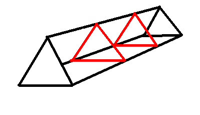

However, all ideas for internal bracing are still welcome. Here roughly what I was thinking about. The red triangles are the braces and one side of the enclosure is "open".

That bracing scheme seems reasonable, you just don't want them to be so big that they interfere with pipe resonance.
IIRC the greatest pressures exist at the ends, so some people double up the end pieces.

Good advice. Bottom pannels in particular tend to sing, especially if spikes are fitted as you've got a hollow cavity right where you don't want it, under the enclousre, so doublingboth top and bottom is mandatory IMO. One other useful tip for any resonant cabinet: forget spikes. Apply Blu-Tak in sheets to the bottom (no gaps), then stick it to a slab of granite or marble as a plinth. Or even a concrete one at a pinch. You could always paint or veneer it. Kills any potential resonance stone dead, tightens up the LF like you wouldn't believe, and brings benefits to the mids too. Better still, it's cheap. 😉

Bracing that runs along the length of a panel is far more effective
then a number of cross braces. A 2" section of cabinet material
is the sort of thing you need. Do not place the brace in the exact
centre of the panel, offset it slightly so the two sides are different.
This sort of bracing will not interfere with the tuning of the MLTL.

That's actually what I concidered after your first post. However, those braces could've only gone on the outside of the enclosure since I had already cut all the pieces. In my amateurish head I would actually think that these types of vertical braces could be beneficial in more than one way. They would stiffen the enclosure and probably break down some internal reflections too. Sort of like a diffuser. If that's the case, then triangular braces would be even better? I've let myself believe that the less parallel the sides of an enclosure are, the better. A cube is the worst form, and a ball or an egg is the best? Not really applicable to these TL designs I guess. Hmm... I can almost see myself buying a few concrete sewer pipes...

I use window braces in my MLTL's. I use a pair of braces immediately above and below the driver and another one dividing the bottom of the pipe by the golden ratio (or square root of 2 or whatever turns you on). This does two things. First, it does divide the panels into smaller section, particularly at the top of the pipe where internal pressures are greatest. Second, the top two braces form a solid structure around the driver so that the maximum amount of mass is concentrated around the driver frame.
The effect of window braces on the the pipe is acoustical resistance -- stuffing. As long as the cross pieces are reasonable sized -- 3/4" - 1", the braces will have virtually no effect on the pipe.

Hi - I also have the 48 MLTL. I fitted a triangular brace about 3 inches below the driver. This was a piece of half-inch ply with the centre removed so that it was little more than a frame. It helped brace the sides and (the reason for doing it) helped assembly. I think the top and base are the important ones to brace though - the triangular shape does ok on its own (although I used ply rather than MDF).
Regarding stuffing - like you I stuffed the section from just below the driver to the top, in my case using BAF wadding. The brace also helped keep that in place. I didn't use much - enough to fill the area without compressing the material. Works fine.
