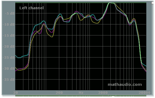

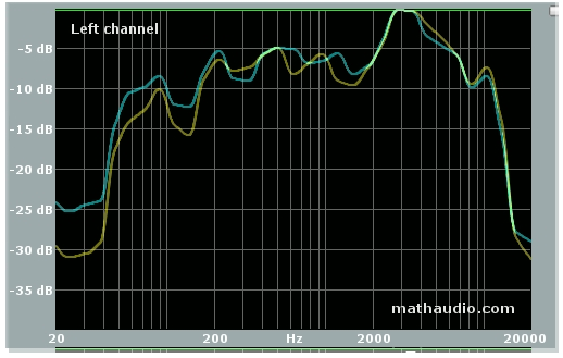

Ok, I've now repeated the measurements with the braces in place - frequency response shown below. As before yellow is un-modded, blue modded before bracing, pink with bracing to baffle. Apologies for the quality of the graph, one of these days I'll learn how to use my image software properly! I seem to have lost 3-4dB in the 50-70Hz range and the response is lumpier.
The braces take up 0.45% of the total cabinet volume - I deliberately kept them slim to avoid volume changes. Maybe I've blocked a standing wave that was reinforcing the output of the reflex ports in this area.🙁

What you did is dramatically reduce 2nd harmonic distortion which is from the modal response of the panel resonances. 2nd HD in the LF region yields "fatter" bass, and speakers with low 2nd HD tend to sound lean, although correct. Older large box speakers have extraordinary levels of said distortion, while modern speakers do not due to the cabinet not contributing so much to the sound. Many people prefer that thicker, heavier sound. it is, however, still distortion.
I guess to answer your actual question, no, you can't. You took an underdamped enclosure that would ring when excited, and now have stiffened it so that it no longer does. The bass you are hearing was always there; there just used to be grunge on top of is (it is not lower bass that you've lost, it's the upper "punchier" bass).

Without knowledge - just by the FR graphs - i would have assumed the cabinet's Qb has been reduced noteably ...
Is that brace horizontally between driver and inner mouth of port ?
How much (in %) is the cross section of the cabinet (in horizontal plane) reduced by that brace ?
How close is it to the inner mouth of the port ?
