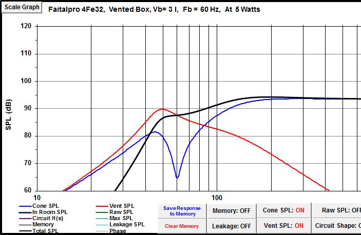

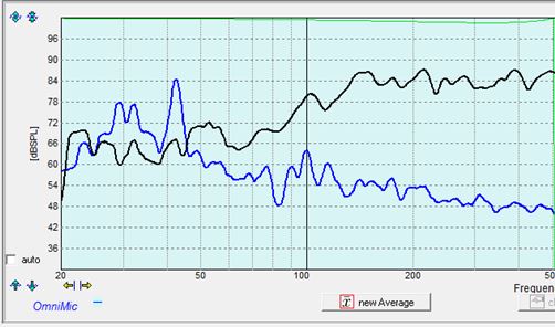

Sorry for the late reply. Have been a bit busy lately.
The speaker driver is a Faitalpro 4Fe32
The freq response by Omnimic measurement shows a 12db drop from 150Hz to 50Hz. Distance from mike to speaker is about 50cm. The simulation (woofer box model and circuit designer by Jeff Bagby) shows a drop of about 6db only.There is also a further drop of 6db at port tuning frequency (circa 60Hz). I had also verified by impedance measurement using the DATS system the port tuning frequency is at 60Hz.
The volume of the cabinet is about 3l and is a 9inch sphere.
the cabinet is a wooden sphere of about 9 inch in diameter. The driver is facing the front and the port is at the bottom. The distance between port and bottom surface is about 1 inch.

At an 80dB midband level around 1khz, you need the bass at 60 hz to be 100 dB, or 20dB louder to be perceived at the same level. For highest efficiency, tune at Fs or higher. Not to say that one can't tune below that, though you are in the compliance controlled region ( not mass controlled ) and if the suspension is tight, you may not get near what the simulation says.
Thanks for your lengthy reply. Really appreciate it. Yup, I did have a high pass filter at about 40Hz to reduce power below port tuning.
This makes sense, I am not familiar on the basis is the model and assumptions. But tunign below Fs is probably not what a lot of people will do and the inacuracy of the model might be the cause of deviation.
I am also most concern about the drop at port tuning, as if the port not working at all.
I will try to measure while barricading the area so the the port energy only points front and see if it makes any difference.

Seems to me the agreement of sim and mic are quite good. A whole lot better than I'd expect.
On the other hand, the only measurement that counts in the end is made at your listening chair. Domestic room acoustic influences will overwhelm the little variations in up-close mic measurements. So then you need to introduce DSP to fix things since it would only be random luck if the bumps in the sim were helpful or harmful to the room response.
The smart future methodology will be to assess the room first and then do a sim that recognizes drivers, boxes, and rooms in the mix.

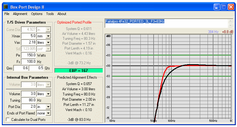

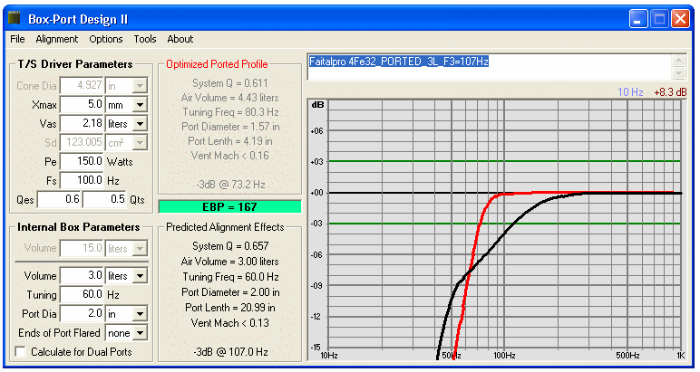

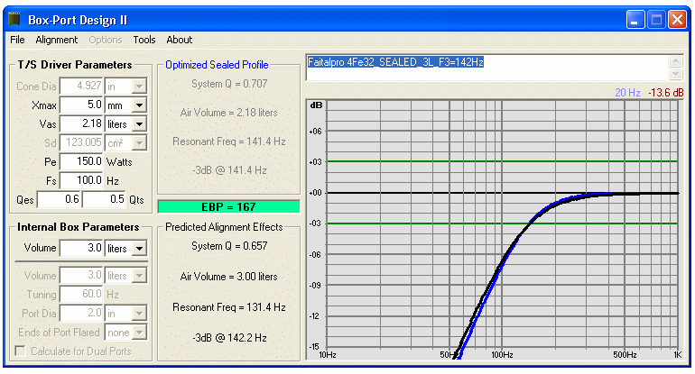

Your port tuning is too low (left plot-black trace). Tuning to 80Hz will give you a F3 of 83Hz (center plot)
Or better still, change it to a Sealed Box (right plot F3=142Hz) and cross over to a woofer for bass.

Hi Michael,
Thanks for the simulation, i didn't mention earlier that i tried another box at 80 Hz and it sounds better and sims better.
Simulation based on the worksheet i have and your differs by a about 2db at 60 Hz. But iwill still be happy if i had a result that was anything close to what you were getting.
I wanted more bass extension, and one way of achieving it is by dropping the port frequency and giving it a small 3-6 db boost by dsp. If had the based on your simulation, i would add a 4 db boost electronically at 60Hz, i would achieve a frequency response of -3db at 60Hz. Would have been more than adequate for me.
However kn my case it was 12db down at 50 Hz and 18db down at 60Hz. That is not realistic to correct electronically.
Even at my other box where i tuned it to 80Hz, it was down at -6db at 70Hz but there was a big dip at 80Hz port tuning frequency.
I can't quite undertand the cause of the dip. Although for the simulation to be off might be because of as what another poster has mentioned, that port tuning below Fs is quite inaccurate..
