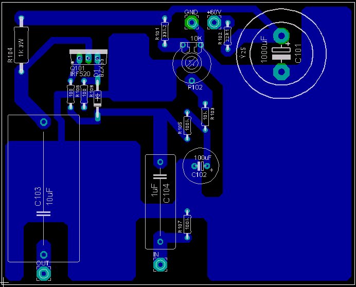

In the meantime her is the pcb layout that I made, I cant se any errors and I checked all the values. But maybe I’ve gone blind or something. Sometimes it can be hard to see ones own mistakes.
Try measuring the voltage at the Source pin of the
MOSFET. Presuming that there is a resistor
connected from the Source to Ground, the voltage
you measure divided by the resistor value will tell you
how much current is flowing through Q1.

ELarson's right.
You've got a number of potential current paths. Just measure the voltage drops across the resistors and calculate the current flow with ohm's law. I'd start with the very first resistor downstream of the regulator transistor (R2 or R3) and find out just how much current the circuit is drawing. Then look farther downstream to find where it's going.

Kermit - What voltages do you measure at the 3 pins
of the BD239C when the pot is turned all the way up
and then all the way down?
It's interesting that with 77-78 volts unregulated that
a stack of 7 10V zeners only gave you about 60 volts.
Are you using the 4750 ohm resistor to feed the zeners
and the base of the BD239C? Perhaps you could try a
somewhat smaller resistor (2200 ohms, say) to feed
the stack with a bit more current (and also the Base
of the transistor, of course.)

Thanks Erik.
I finally got around to do some measurements. This is what I get after removing the extra zener and paralleling R1 with a second 4750 resistor. R1 is now 2375 ohm. The voltages at the pins of BD239C is:
Base: 60V
Collector: 86V no load, 85,6V P101/102 full cw.
Emitter: 48V no load 24V both channels full cw.
On the upside I now have a total of 10mA on both channels, so it appears you are on to something with the lowering of R1. Il put a pot in there and try to adjust it until I get a stable output.

Quick update, with the pot parallel to R1 I managed to get 40mA +, YESS!! Bad thing, I smoked the pot. Good thing it was a bad salvaged one. Any ideas as to how I can calculate how small a resistor I need?
If you can find the nominal current rating (Iz)of the zener diodes (how much to get the zener voltage?) then you can figure it out.
R= (86-64)/Iz. That way you'll set the current through the zeners to be what you need to get them to exhibit their zener voltage.
Other choice is to keep paralleling resistors in the range of 5K until you like what you get. According to Mr. Pass you're looking for 64 volts at the base of the transistor. Then leave it or measure it and replace it with an appropriate resistor. As long as the current is enough, it's not critical what the value is. (10-20% too much current won't matter).

With the Base at 60V I would have expected to see about 59V
at the Emitter. Something doesn't seem right there. Do you
have a large amount of capacitance from the Emitter to ground?
(Maybe a surge current damaged your pass transistor?)

😀 And it works!!
I rewired everything on a piece of perfboard last night. The pcb was a complete mess after all the soldering and desoldering. Checked all the parts, only C2 was bad I believe. The other parts were ok. After that all was fine. Probably something wrong with the pcb. After all that was my first attempt at making a pcb. Although I cant see anything wrong with it.
Ah well, it works now, so I’m happy!
