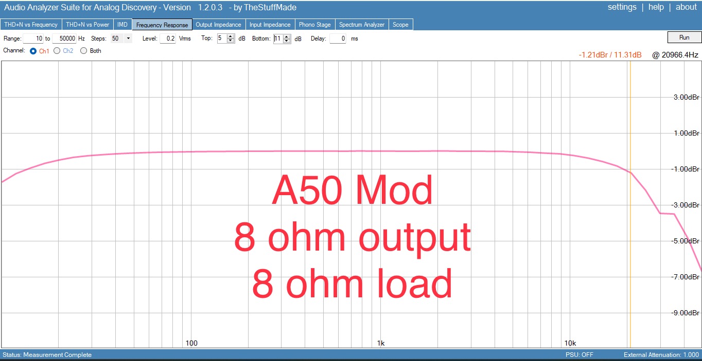

Yes. The frequency response didn’t change except for a little better bass response.

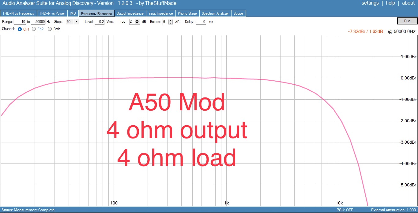

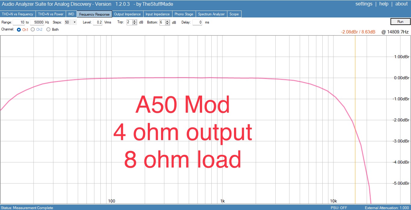

I did notice something interesting. For 8 ohm output and 8 ohm load, the response is like you’ve posted before. However, for 4 ohm output and 4 ohm load, the high frequency response is degraded significantly 2db down at 10KHz and 4 db down at 15KHz. For 4 ohm output and 8 ohm load it’s a little better, but still worse than the 8 ohm output.

Below are the frequency response plots for the 8 ohm and 4 ohm outputs. The high frequency response is worse with the 4 ohm tap, but maybe not audible.
