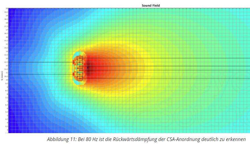

I have found an article about some theory, but it is in German
https://eventelevator.de/storys/gerichtete-subwooferanordnungen/
Anyway there is a good picture where we can see what GGNTKT is doing in a very small package when the box run in cardioid bass mode
more or less accurate translation
the 80 Hz reverse SPL attenuation with the cardioid subwoofer array is clearly visible in the polar diagram
One problem of BoxSim ist that it is not possible to simulate a back wall behind the speaker
