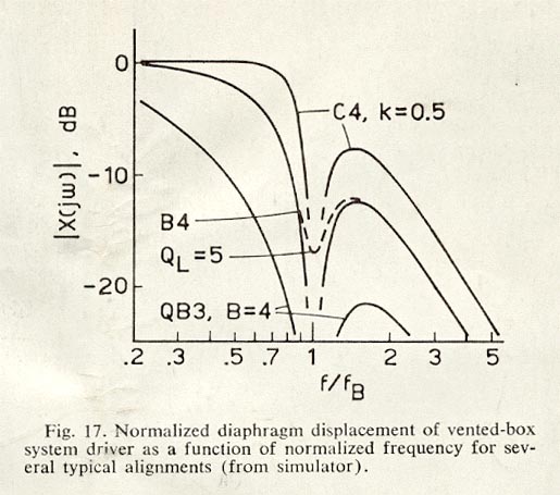

I was designing the box for my Definitive/Seas MTM and I have arrived at a slim mini-tower speaker that I can put on some shelves in my room. It has dual Definitive Tech 5.25" woofers, which have a Fs of 50.1 Hz. The F3 of the box is 47.8 and the tuning frequency is at 51.86 Hz.
So, can I expect my woofers to always be unloading and flopping around if I arrive at a F3 that is below the driver's stated frequency response of 50-3500 Hz? I don't want droopy bass from my mains.

Rory,
The values you gave are close to a B4 alignment for a BR type enclosure. You’re within 5% of prefect alignment. For a realization of a speaker design to turn out this close is excellent. To give you an example, Keele in his paper “Sensitivity of Thiele’s Vented Loudspeaker Enclosure alignments to Parameter Variations”, show that fb variation of 10% high only produced a 1.5db bump in the response curve.
I have included a scan of a graph from Small’s paper on vented enclosures that shows diaphragm displacement vs frequency around fb. It shows the woofer cone displacement WRT the drivers maximum cone displacement (0db). This is in general terms, but it can be seen that music signals below f3 ~ fb will drive the cone to relatively high cone excursions regardless of a minor misalignment.

So I'm in good shape, then? Or should I try for a different alignment? I tweaked it so that the box would have its f3 at 51 Hz, which is better for the woofers, I think.
The woofers themselves seem pretty robust, so I think they could take some cone motion if they had to, but if there's something I need to do to protect my drivers (thus increasing their life span) I am open to suggestions.
First, let me see that I'm understanding you. So for frequencies below the tuning point of the box (51.86 Hz) but above the F3 (47.8 Hz) I can expect those cones to really move, right?

You will get an F3 below the tuning frequency of the box if the box is larger than the speaker's Vas.
There are perfectly satisfactory alignments that have an box volume larger than Vas. However, it is best not to overdue that too much.
With a Qts of .39, the box should be built with a volume of Vas, tuned to Fs and will have an F3 of Fs. That is the way the B4 alignment-also called the "classic bass reflex alignment"-works.

Rory,
You’re in good shape right now. You will be able to tweak the box 5 or 10%, but it’s a lot easier if the box is too big rather than too small. The B4 alignment will work fine. Be sure to measure the speaker parameters when they come and than make the necessary adjustments in your alignment.
WRT the cone excursion, the speaker is made for a vented enclosure and if you’ve heard good things about it, I would assume you to pretty safe. It is not a bad idea to use a subsonic filter with small bass drivers. Bi-amping with a sub-woofer would solve that problem very nicely.
