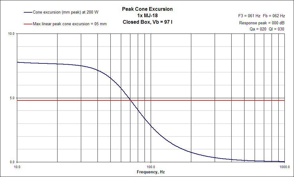

The limitation on all bass drivers is Xmax. In the case of the Omega, it's 4.8mm. This is not enough to get the kind of frequency response and power handling you want.
Here's a look at the modeled excursion of this driver in a sealed 97 litre box. F3 is 61Hz. At 70Hz the driver is starting to exceed Xmax at 200 watts.
Think about looking for another driver if you want low bass at high spl.

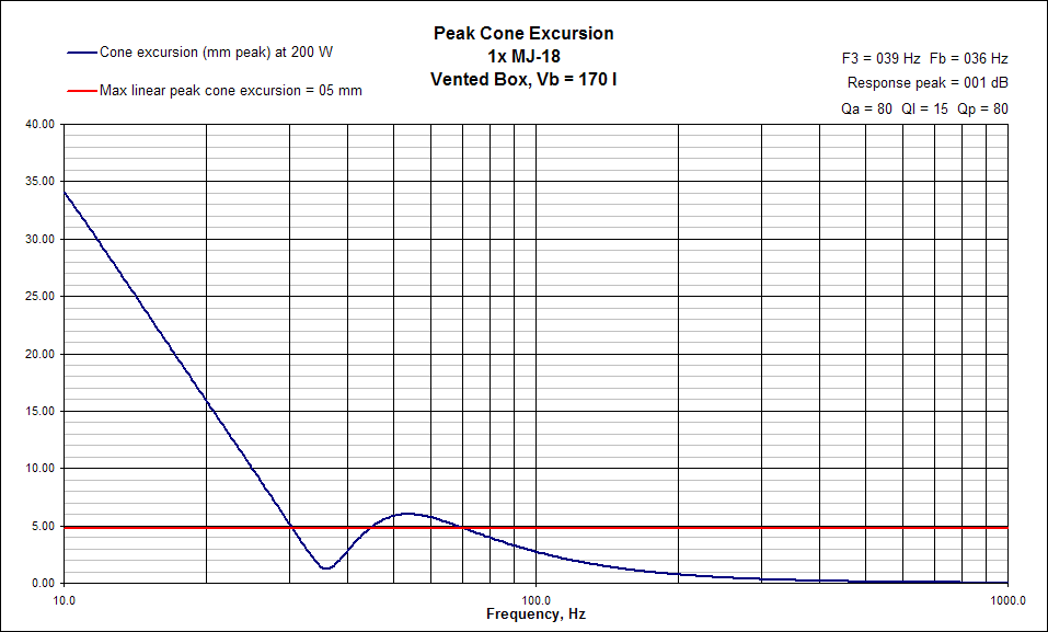

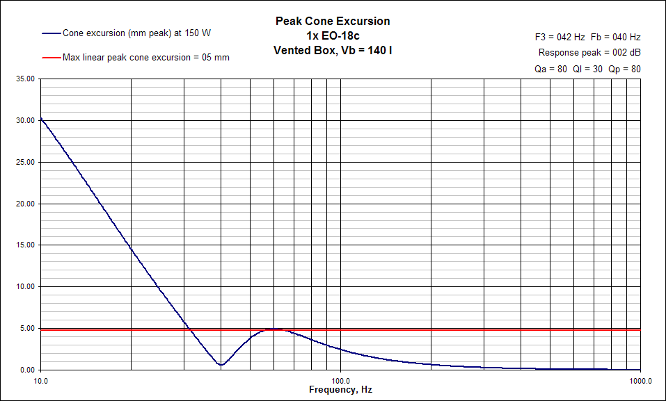

Oh! I had one other question. On the first graph you (John) posted the excursion of the cone went up in more or less a straight line as the freq. decreased. On the second graph there is a bump in the excusion (around 55Hz). What causes this?
The first graph is for a 97 litre sealed cabinet. This shows at what frequency the drivers Xmax will be exceeded. In this case, at 70Hz with 200 watts input power.

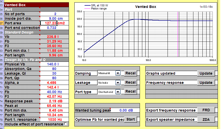

The second graph is for the same Omega driver in a vented 170 litre box. Here you see the driver is still exceeding Xmax at 70Hz, but it is only by 1mm. This may be a better approach if you really want low bass, as the chances of over-excursion are limited. Still, you will need to dramatically cut below 35Hz or your driver may (will) fail.
I'll do another simulation and see what the best scenario is, as you say you already have these drivers therefore you need to get a usable plan.

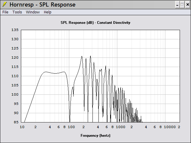

Right you are. Here's a simple tapped pipe (6th order BP) half space sim with ~30 W input to hit Xmax @ 20, 33 Hz, but it's ~411 L net:
Unfolded length = 333.5 cm/131.3"
w x d = 1232 cm^2/190.96"^2
GM
