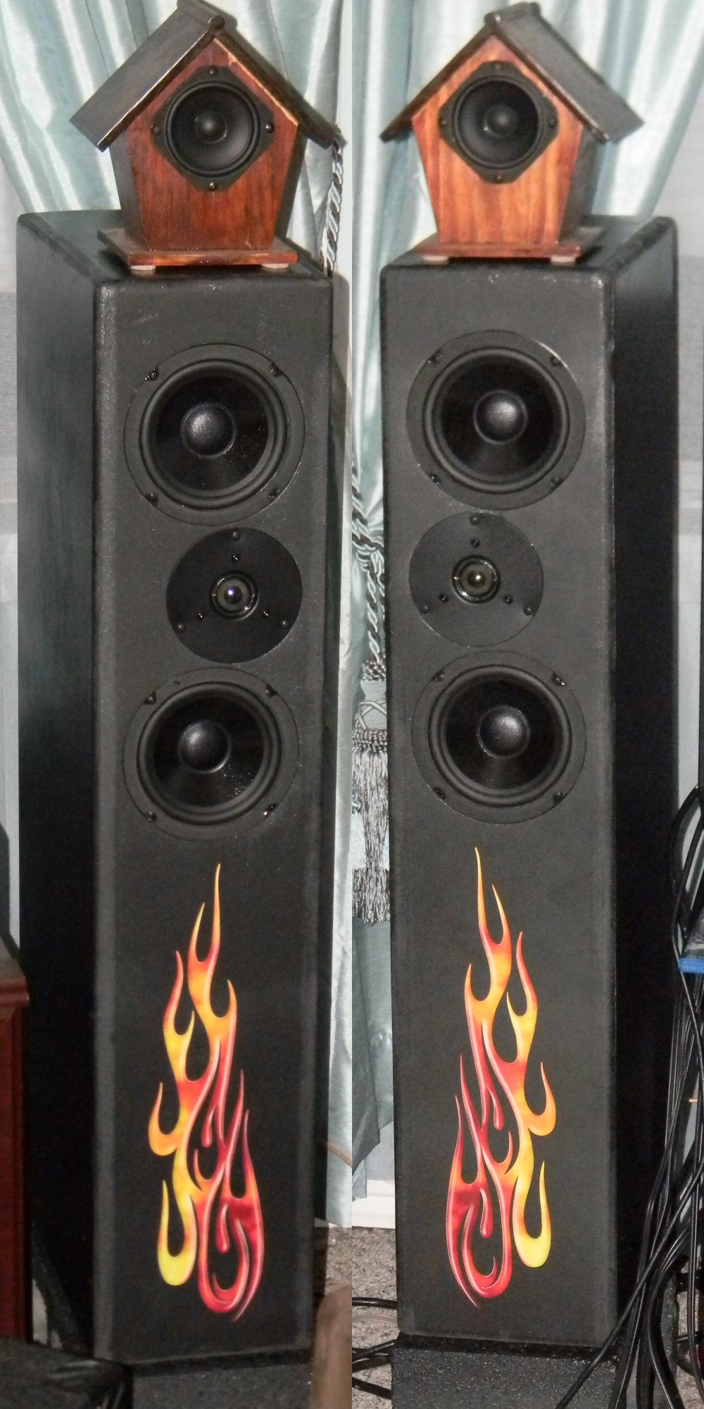

It's been a while coming. The paint finish was rought and felt like tree bark so I sanded it down with 220 grit and repainted two weekends ago. After six days, I applied the decals I ordered from Amazon, removed all stuffing, "fluffed" it out, and reinserted lightly above the braces. They turned out gorgeous.
Overall the audio quality is phenomenal and it doesn't really need a sub. Bass extends down to 30Hz or so with a smooth rolloff. No "boomy" sound at all like typical ported enclosures. Drums and musical instruments it's almost like they are in the room. I'm probably going to retire the Sony 50W 8" sub I used to have as it won't contribute much beyond the natural bass these speakers produce, and the typical "boom-boom" effect from bass overemphasis (cranking the sub gain or rolloff too high) is not hifi. I may pair them with the 12" Dayton sub from PE at some later date, but in all honesty it isn't needed. The lows of the woofers and the clear highs of the silk tweets are phenomenal, and in my living room, I'd likely go deaf before I could crank out music loud enough to "bust" them. It's concert worthy when I crank it up with rock music, yet the midbass is strong and vibrant even at low levels which was my chief complaint about the Polks (perceived hole in the midbass spectrum when played at low volume levels). Overall the tonal balance is more warm and mellow than the Polks too. The ever so slight response dip in the mid highs (compared to the Polks Monitor 40s, from the brief A/B test that I performed with them both hooked in) actually adds warmth and vibrance.
Onto the finish. The hammered black created a nice textured satin finish after resanding and the second application. I painted the cinder blocks with the same finish and placed them underneath to raise the tweeters up to ear level when seated, and added felt pads to the bottom of the cabinet. Nevermind the TC9 birdhouses, they're disconnected for now and just add to the decor. The fire decals just scream out "rebel" while keeping a touch of class. :hot:
EDIT: Stupid me when I cropped the photo put the right speaker on the left side and visa versa. The tweets should face the outside walls... 😛
