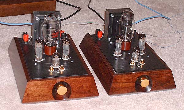

I also got started on this path with a Bottlehead Foreplay, and it has turned into a great hobby. No regrets at all. The thing about starting with a kit is you will build confidence and have some debug support should you run into a problem. Folks are very helpful at Bottlehead and Decware.
FYI, buying a vintage amp can also be troublesome - having a little experience really helps with reading tubes, checking voltages, and avoiding singe marks on your fingers.
Happy soldering/pRC

S5 sound
Well, the stock unit is OK - probably better than it should sound for that kind of money. About 8 watts out. Neutral signature. Amazing for some TV tubes and el cheapo output iron, clever design. The PP output tranny cancels most of the PS noise by nature, and the signal section is decoupled (see below) with more filtration.
It's not as good as a Monarchy Audio SM70 (SE MOSFET amp), but certainly close. Way better than a typical mass-market SS receiver.
Steve replaced the resistors first (Kiwame I believe) - not that much difference. Coupling cap replacement made things a bit more dynamic, more drive.
Chokes in the PS and replacing the resistors in the decoupling stage (was 2.2kohm/22uf) made a BIG difference - more juicy overall, toe-tapping, more listenable. Using Solen film caps for decoupling helped more. Replacing the diode bridge with UF4007 and a RRSF (Buddha-style reverse recovery spike filter) helped too.
The circuit uses feedback, and that can be fun to alter as well (wait until after the PS is cleaned up).
Caveats on this kit - the thing is built on a printed circuit board (PCB) so mods are not always easy. Steve ended up mouning his on a maple cutting board with a big square hole underneath to access the bottom of the PCB. And the tubes run hot. Some online users have complained that the sockets get brown and brittle from the heat.
The tubes used are 11MS8 TV tubes - 9 pin novar base - indirectly heated with a triode signal section and a tetrode power section. Tubes are plentiful and cheap in this type, so you can buy a bunch and sort them using the amp as a tester on a rainy afternoon with a multimeter and a pad of paper.
Is this helping? or confusing?
