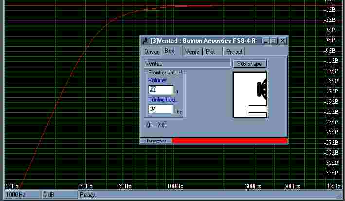

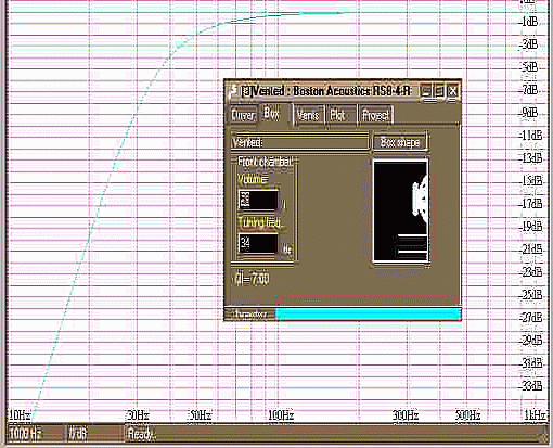

50litres at 34Hz sounds reasonable for a box with both drivers.
Tuning frequency in the frequency of the port / vent.
Vent mach is the air speed in the vent. A port 2" diameter and 4"
long has the same frequency as a port 4" diameter and 16" long.
The bigger port has lower airspeed, winISD changes colour if
the port airspeed is too high.
Play around with the diameter of the port under vents.

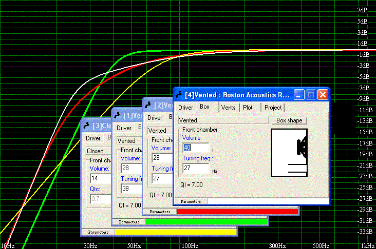

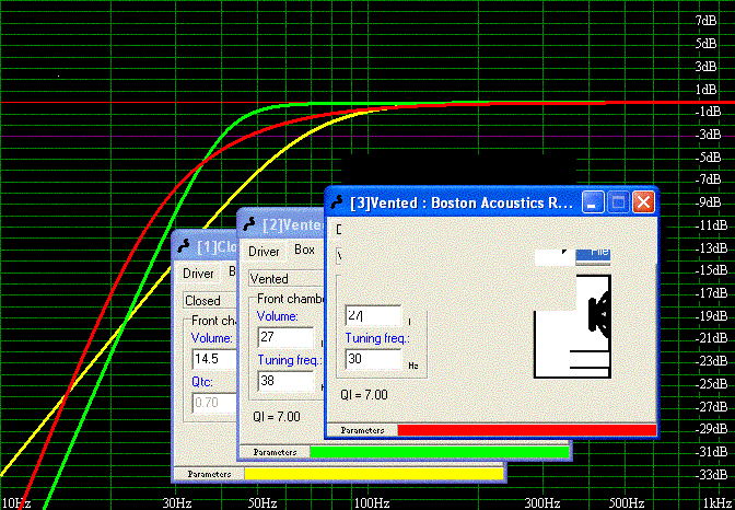

Hi everyone again,
I think I've decided to run an active crossover system for the woofers in addition to my bookshelf AE Aegis ONE speakers since the AE has one pair of speaker terminals. Noticed they're alittle low on bass.
I'll bi-amp them with one amp driving the Aegis ONE and another amp driving the BA subs. Sort of like a mix and match 2 way system.
I'm not too sure which enclosure is more suitable for the BA subs, closed or vented. I seem to keep running into ridiculous vent lengths when toying around with the tuning frequency. Anyone know whats a good tuning frequency for the subs ?
Suggestions and recommendations would be appreciated.
rchua77 said:Hi everyone again,
II'm not too sure which enclosure is more suitable for the BA subs, closed or vented. I seem to keep running into ridiculous vent lengths when toying around with the tuning frequency. Anyone know whats a good tuning frequency for the subs ?
Suggestions and recommendations would be appreciated.![]()
As I've already stated the BA drivers are not suited to sealed
subs. Tuning frequency in a 54 litre box for the pair is 27 Hz
to 38 Hz.
Lets say 30 Hz.
For a 54 litre box = a 8.2cm (~3") diameter and 26cm (~10")
length, or 6.8 (~2.5") diameter and 17 cm (~6.5") length.
I'd suggest 75mm and 213mm.
Note graphs are for a single unit.
🙂 sreten.
