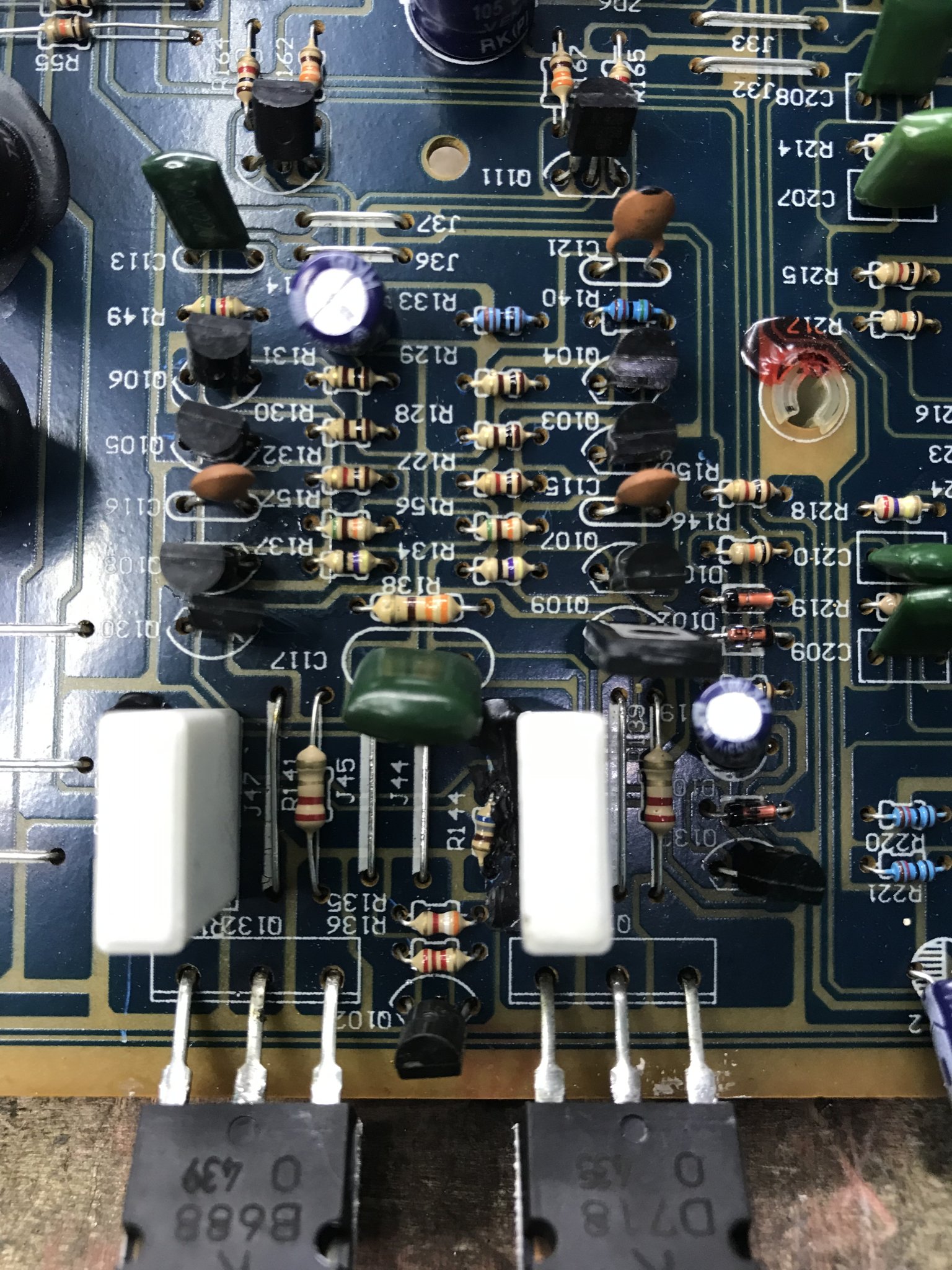

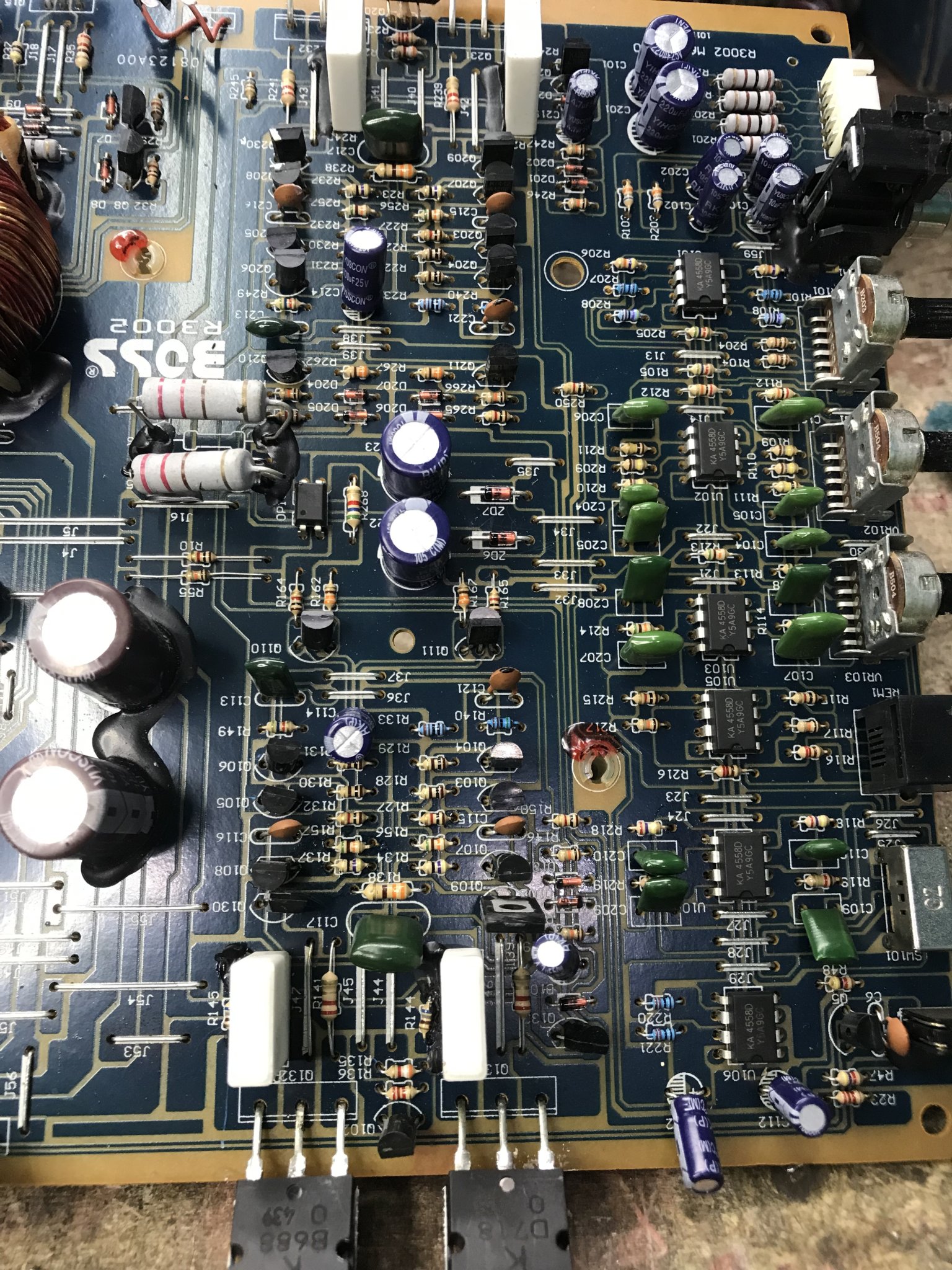

The bias in one of the channel is not holding.After a few seconds the output start to over heat.I see about 1.567v pulsing on the output terminal .
I did not find anything bad in that channel.
Any suggestions?

It originally gets clamp down together with the outputs.I try two new drivers same.
Emitter resistors test ok.
I remember i had a similar problem years and you told me to increase or decrease the value of one of the transistor near the bias transistor but i
dont remember exactly.
That's sometimes an option when both/all channels are over/under biased. You would make the bias transistor conduct more to reduce idle current. That can generally be done by increasing the B-E value or decreasing the B-C value slightly.
There appears to be another problem, causing the DC offset.
Can you simply clamp the outputs and heat the bias transistor to see if the amp will produce clean audio rail to rail?
The 1.2v offset won't hurt a dummy load or a high-power woofer.
Knowing if the amp can produce clean rail-rail audio may help in troubleshooting.
