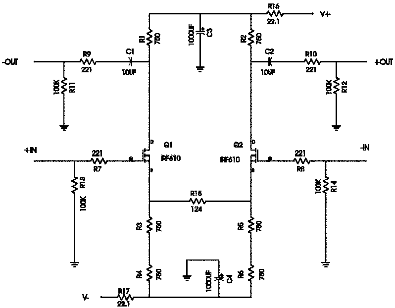

lawbadman said:Hi all
I am in the middle of building a bosoz pre amp, but I will only be using the + input and + output. My question is if the following parts are necessary for my application:
C1, R9, R11, R8, and R14.
You don't need C1, R9, and R11 for sure.
I left R8 and R14 on mine. I ended
up installing a balanced input on mine. Son of
Zen's bride does good work as a
balanced-to-single-ended converter.
Erik
Just build it per the article. Short the negative input to ground.
then enjoy 🙂
Then when you want to use it as a unbalanced to balanced
converter (to run, say an Aleph 2) you're all set. I've run mine
unbalanced into an Aleph 3 for a while now and it sounds great.
then enjoy 🙂
Thanks for the info guys.
I left out C1, R9, R11 and R8.
Has anyone done any modifications to the power supply for better sonics?
