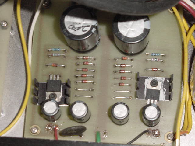

i did a stupid thing today. i powered up my BOSOZ power supply
without loading the V+ with 15 Kohms ¼ watt to ground and the
V- with 15 Kohms... i blew all the zeners and the mosfets.
just when you think you're learning something...
POOF, you let the magic smoke out...
well, i guess i at least learned not to do that.
could someone explain to me why it does this without a load?

It's been so long since I built mine I can't remember that happening to me. I couldn't tell you why. Where in Florida are you located? I am in Lakeland close to Orlando.
i'm in Clearwater
i just de-sodered all the zeners (all toast) and the MOSFETS.
i guess the caps are still good, not sure about the diode bridges.
my RS voltmeter has a diode setting. when i check the bridges,
it gives me a reading, but it's not stable... the V just keeps
increasing...
i did double check all the parts values, cap polarity, zener polarity,
etc. I mean it's not that difficult to stuff a board with the correct
parts... i suppose the parts blew because i didn't add the resistor
loads before turning on the power supply...
m.

I never heard of that. I do believe I checked the PS of my BLS with no load and nothing really happen. Sounds to me like you got bigger problems than the lack of a 15 kohms load.
I can't remember if I had mine hooked up to the circuit or not when I powered it up. I don't think the absence of a load would cause all that damage. Things to consider would be did it occur on both the + and - side. Without the mosfet or zeners installed power up and make sure you have + volts on the + side making sure that your bridges are in right and not backwards. I think if you hit those zeners backwards they will blow and I'm thinking of any way the voltage could wind up wrong. Everyone who has ever made a mistake with this stuff has looked right at it 20 times wondering why before it hit them. Be persistant, it will work. Sometimes I walk away and come back later. Good Luck

I did as PassFan suggested and took some readings
without the zeners or MOSFETs installed. Reading
across the caps right after the bridges i was getting
+103.5 VDC and -104.4 VDC. i notice these readings
are a lot higher than the 80VDC reccomended from
the article... could this be because of no load?

Your voltage is wrong. It should not be that high, it should be at the 80 volts it is supposed to be at. When you load it down the current increases not the voltage. Double check that you have dual secondary windings and that they are wired in series. With dual windings of 38v each wired in series is 76 volts x 1.414 would be about what you are getting...crap. Don't power it back up on that until someone smarter than me gives more advice.
You can also do a search for this in the Pass forumn to see if someone else had a similar problem. The calculation works out so it's not wired wrong I just question this high a voltage. Normally with 30 volt windings in series you have 60v x 1.414 would give you around 80 volts. The zeners are set up on that voltage to tell the mosfet what level to regulate at. With your voltage being higher the circuit will not behave properly. With smaller trannies you have to take out zeners. With bigger ones I don't know

Not one of my prouder jobs but it works none the less. It's actually too much of the cheap white radio shack crap and with my use of lower voltage transformers I don't think it gets hot at all. 😱
here's a pic of the main board... for some reason
i didn't take a pic of the power supply board...

There is nothing wrong per se with having 104 volts, it's just due to a crappy transformer with 15% regulation. Just make sure your first caps after the rect. are rated hi enough. I used
a C-R-C-Reg sequence after the bridge to cut down on the dissipated power on the series mosfets where the first C was rated at 150VDC. R dropped about 25 volts to put me into a more reasonable voltage range.
Moe,
don't get too scared if the 750 resistors get hot. Hot they will get, VERY hot, about 130 deg C if my memory is correct, with the small sinks the mosfet will get toasty as well.
Initially I soldered the 750 ohm resistor 1/2 inch from the pcb to give a little more ventilation. I also put all the hot stuff on the top and all the caps on the bottom to keep them cool.
