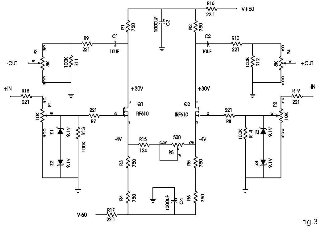

My name is Maurizio. I bought the BOSOZ pcbs and i'm preparing the list of components to buy in order to realize it.
I've one question abou the gain of the pre.
From the Nelson Pass documentation i could see that the r15 resistor is setting the line stage gain.
Using a 430 ohm value the gain should be around 10 db.
Which value should i use to have the gain=1 ?
Having the gain settled at 1 by the r15 resistor..may i consider to use the P5 pot as volume set?

Maurizio *may* mean:
https://www.firstwatt.com/pdf/art_bosoz.pdf
If so: in hi-Z loads the load at the top of Q1 Q2 is about 648 Ohms. For unity gain we want the same in the bottom. But there is already a lot of 750Ω resistors there. I figure R15 should be near 820Ω.
This is a lot of parts and heat for unity gain-- why do you need it?

Hello thanks a lot for your feedback about.
Why i want to use it?
Because my amplifier accept balanced inputs, and i would like to use like this.
I was evaluating the B1 Preamp as well as i do not need lot of gain but i'm just looking for low output impendance.
Any suggestion ? Anything i could use instead of it with balanced inut and output?

If you are asking for an alternative to the BOSOZ, without knowing either, I‘d place an advertisment for mZM‘s iron turtle… Iron Pumpkin preamplifier(s) kits

I think you look at the volume control, which is not a pot but a transformer—which is the magic part of it…
