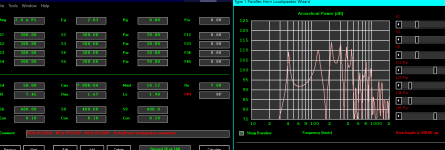

Here's a sim I made of Bose's new tapped horns
documentation is here: https://audioxpress.com/article/patent-review-bose-transmission-line-loudspeaker
US patent is here: https://patents.google.com/patent/US20150071473A1
2023-03-30-12_31_13-xara-photo-graphic-designer-untitled23-_-png.1159360

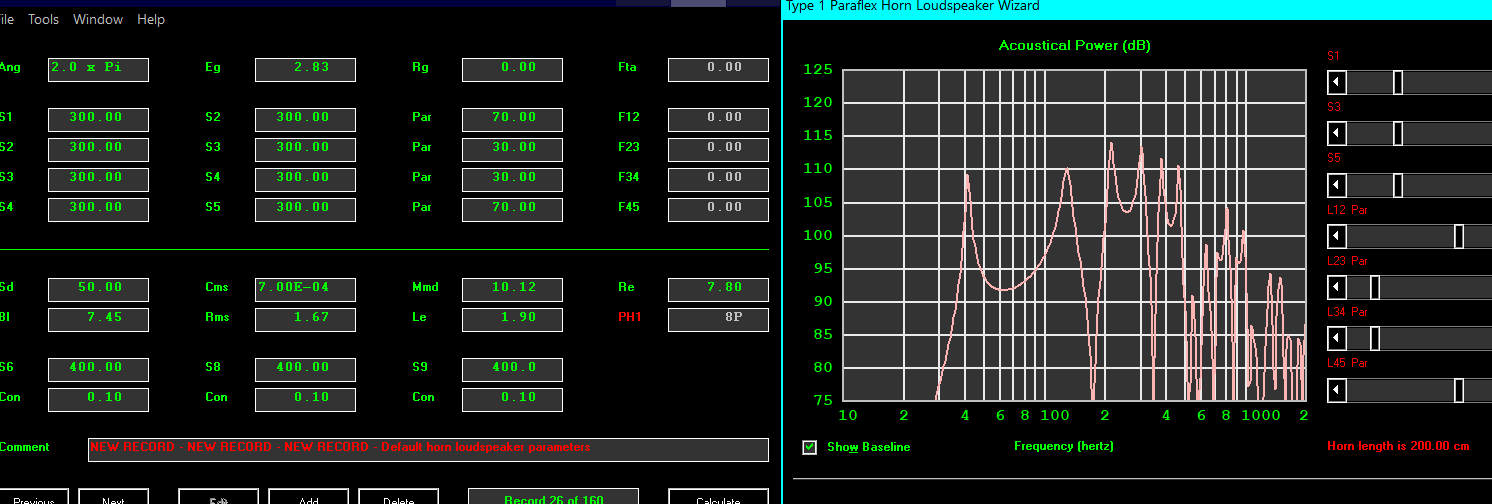

The Akabak model is quite a headache. As far as I can see, this thing can't be simmed with anything but Akabak (Hornresp can't sim it.)
The numbers in the pic above show the various segments. For instance, there's a waveguide segment between "8" and "9" and the throat of the waveguide is defined by the throat area at 8 and the mouth area at 9.
One thing that's "semi-unique" is that the stubs that are intersecting with the horns are made using a "duct" not a "waveguide." Basically, Akabak gets tricky when you have waveguide segments that are reversed. IE, if you have a segment that goes from a large area to a small area, like in a transmission line, you have to mount the waveguide segments backwards in the Akabak simulation. This is because Akabak "waveguides" only get bigger, not smaller. So if you need them to get smaller, you have to mount the segments backwards.
I opted for a duct instead, for the "stubs" in the Bose Tapped Horn. "Ducts" in Akabak don't care if they're mounted normally or backwards, it's all the same.

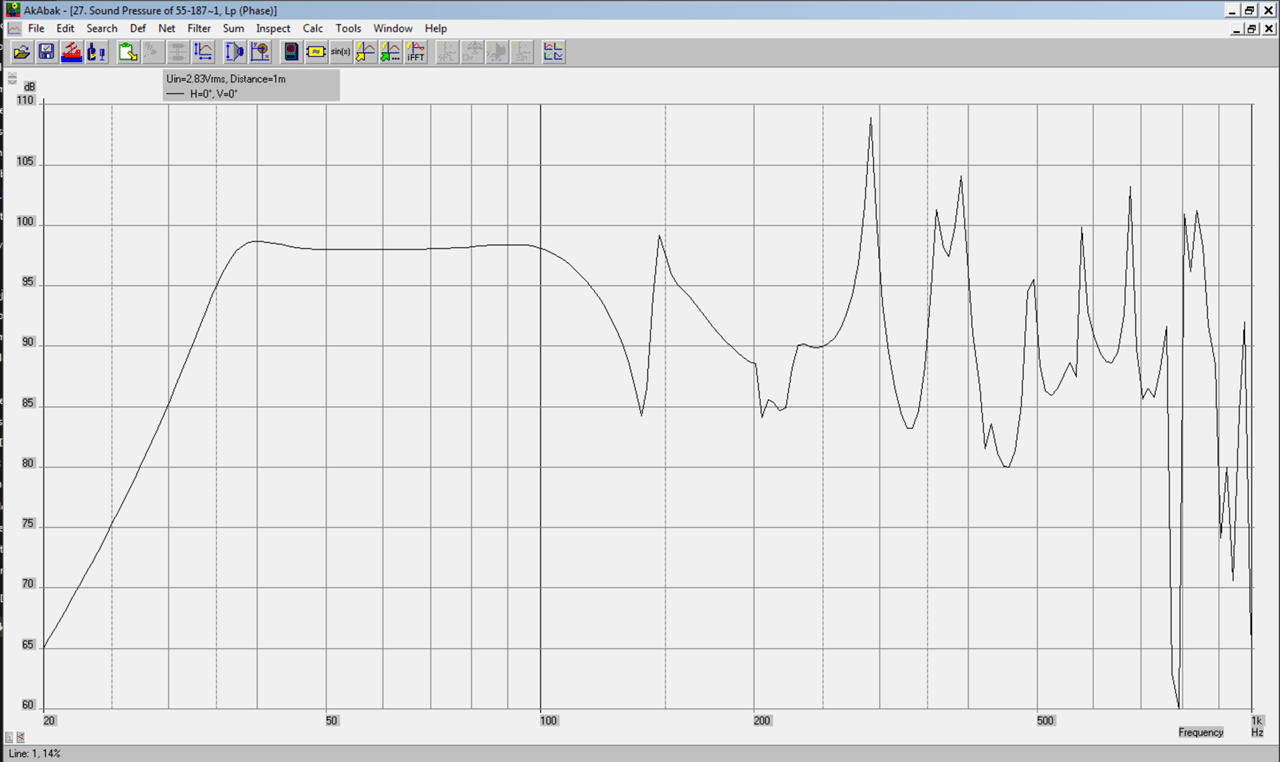

Here's the Akabak model I made. This particular subwoofer uses four of the tried and true MCM 55-1870 woofers.

Like many of the Bose subwoofer designs, it squeezes a lot of bass out of relatively small woofers. In this case, I'm using four MCM 55-1870 woofers, which would normally be struggling to play 80Hz. By putting those five inch woofers in this Bose Tapped Horn, they end up playing down to 35Hz, much lower than you'd expect from such small woofers.

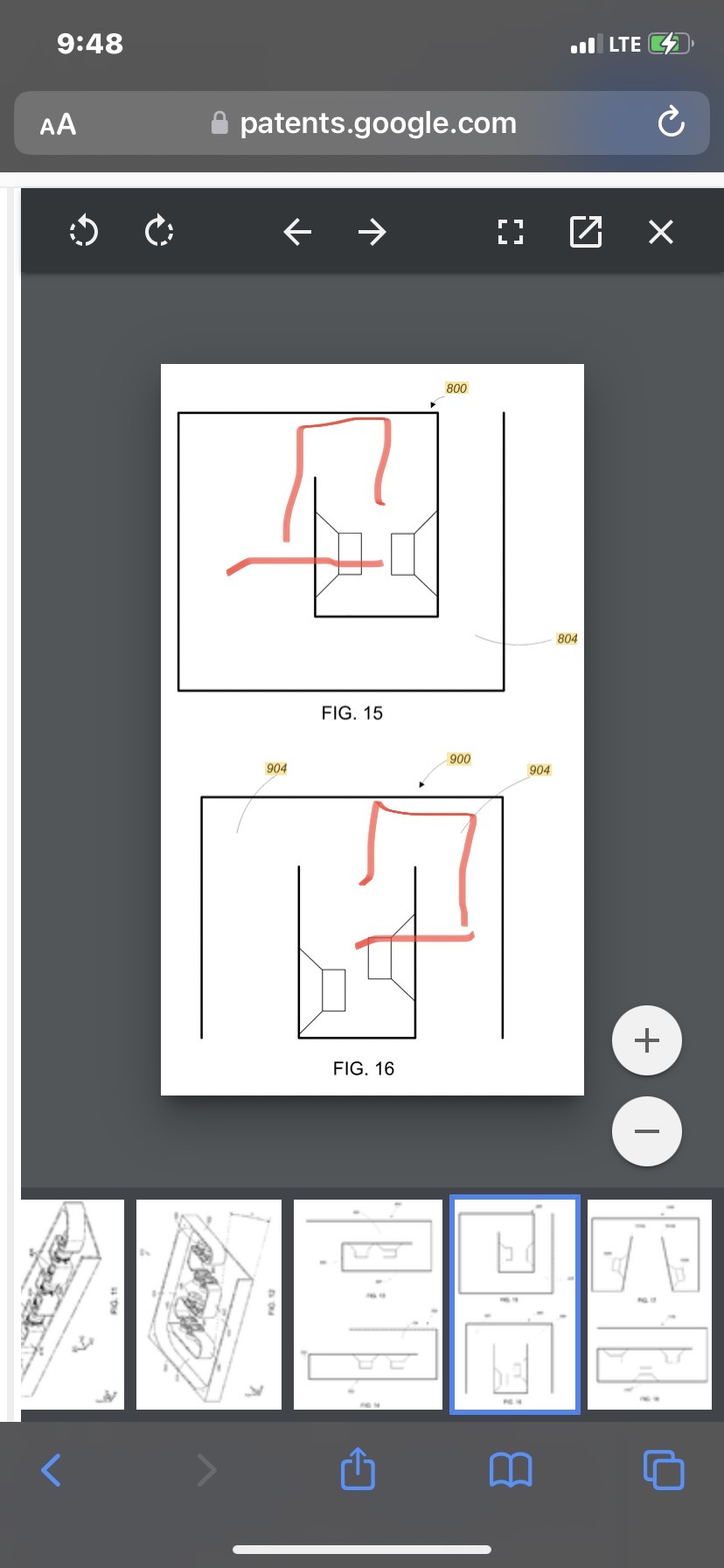

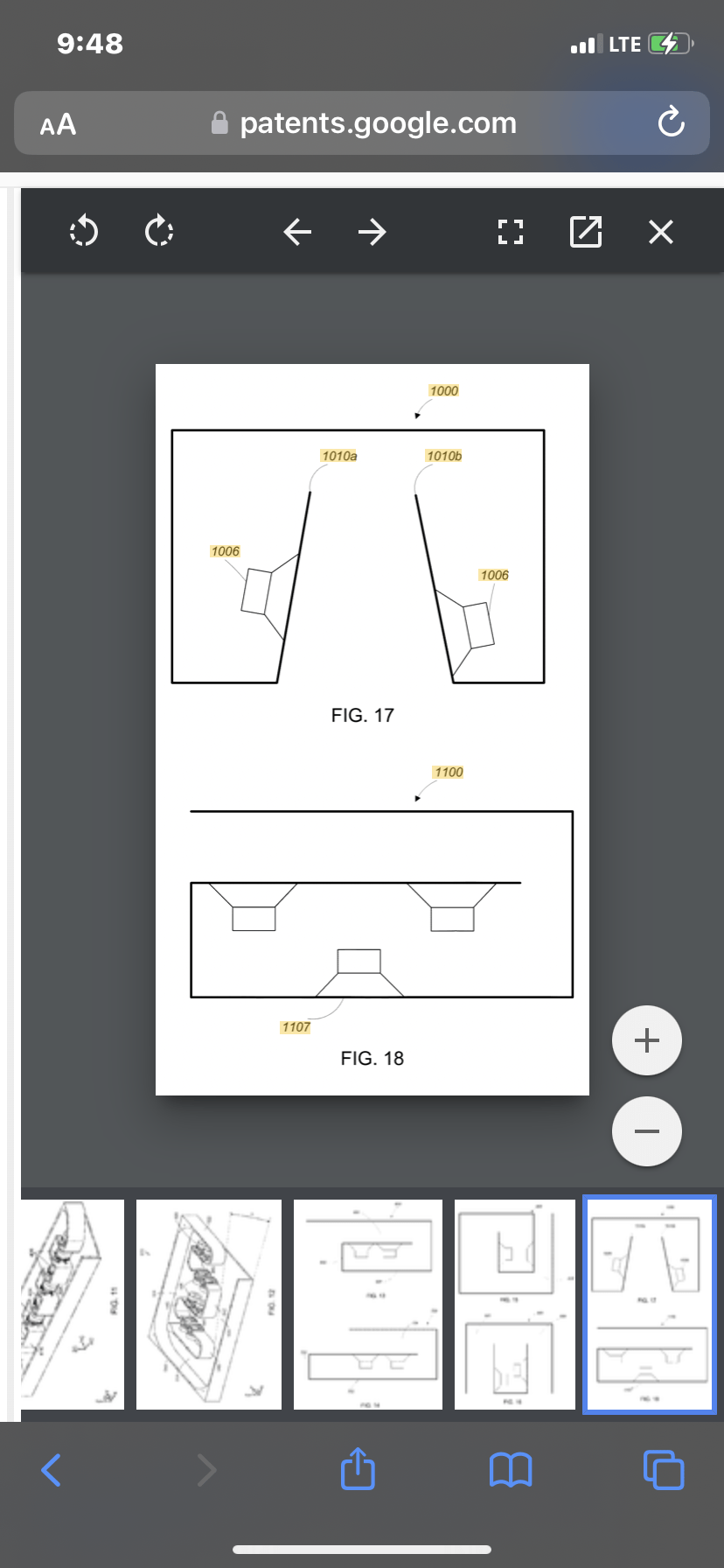

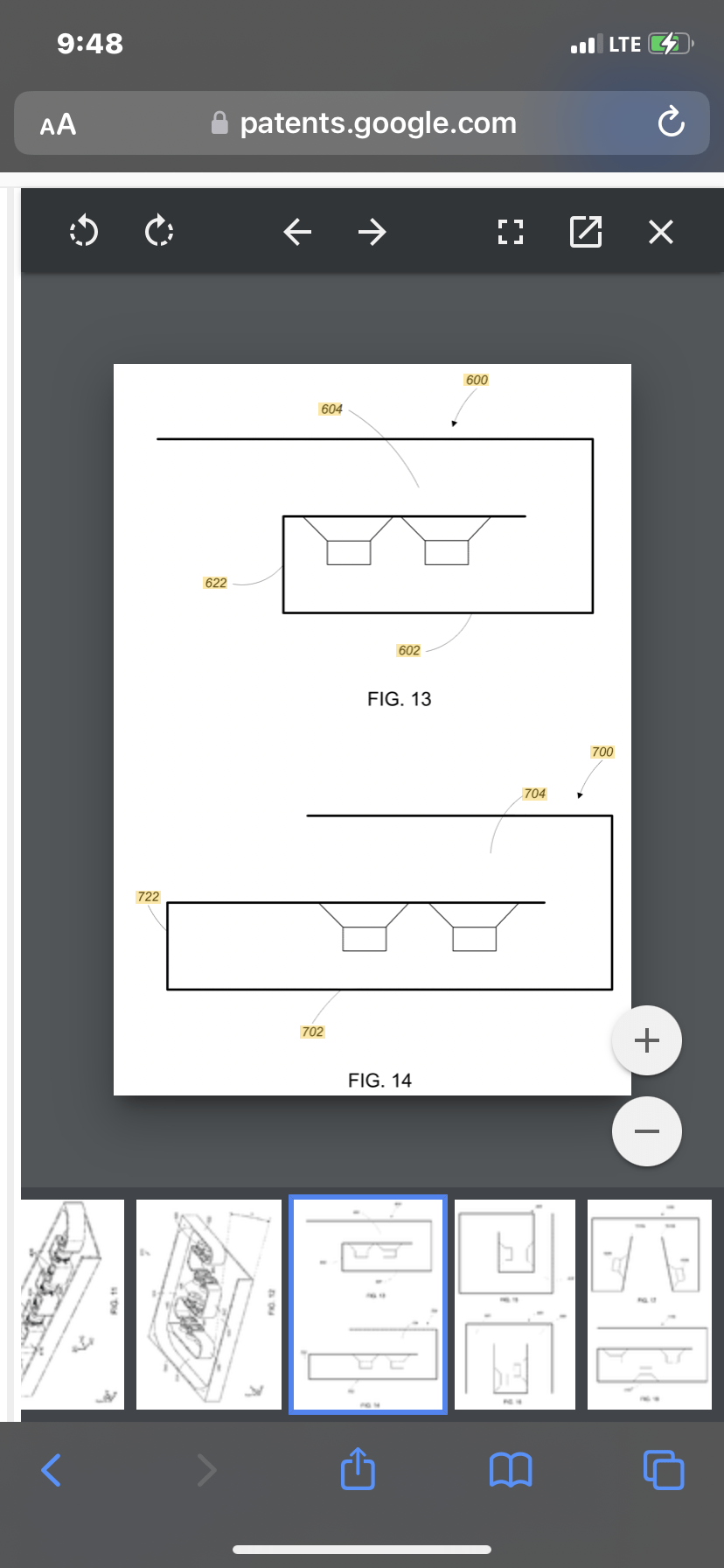

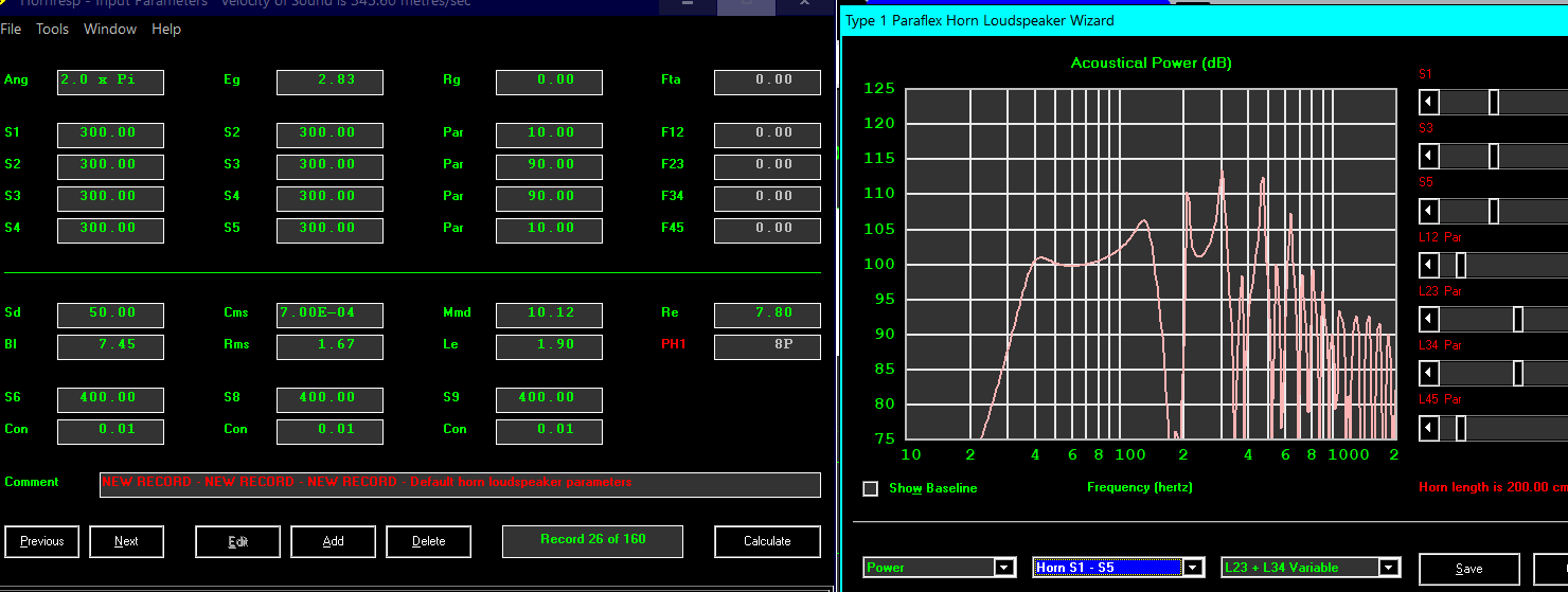

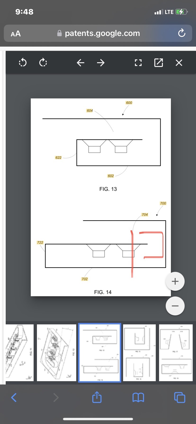

The short acoustical circuits mess with my mind . If I sim those individually (tighter and tighter) they create more and more ‘spike’ at resonance instead of when spread out. What do you guys think ?
