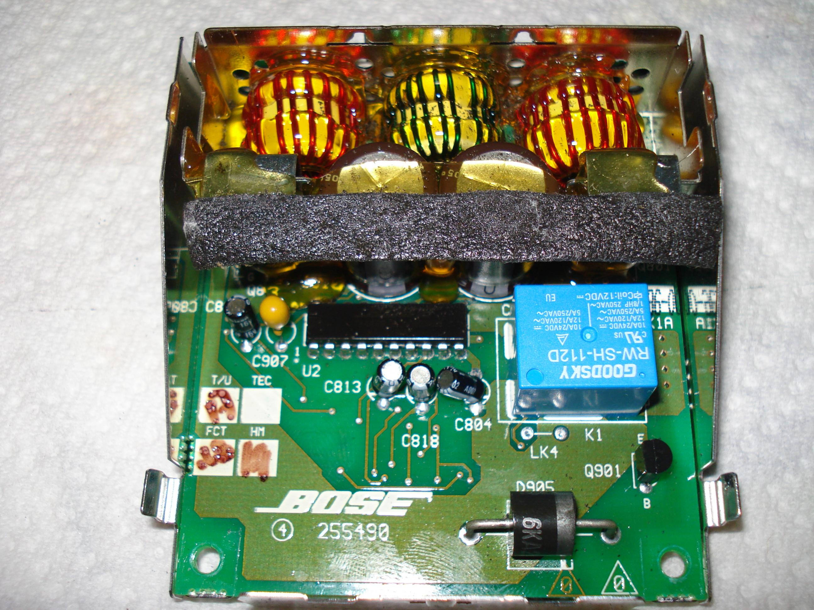

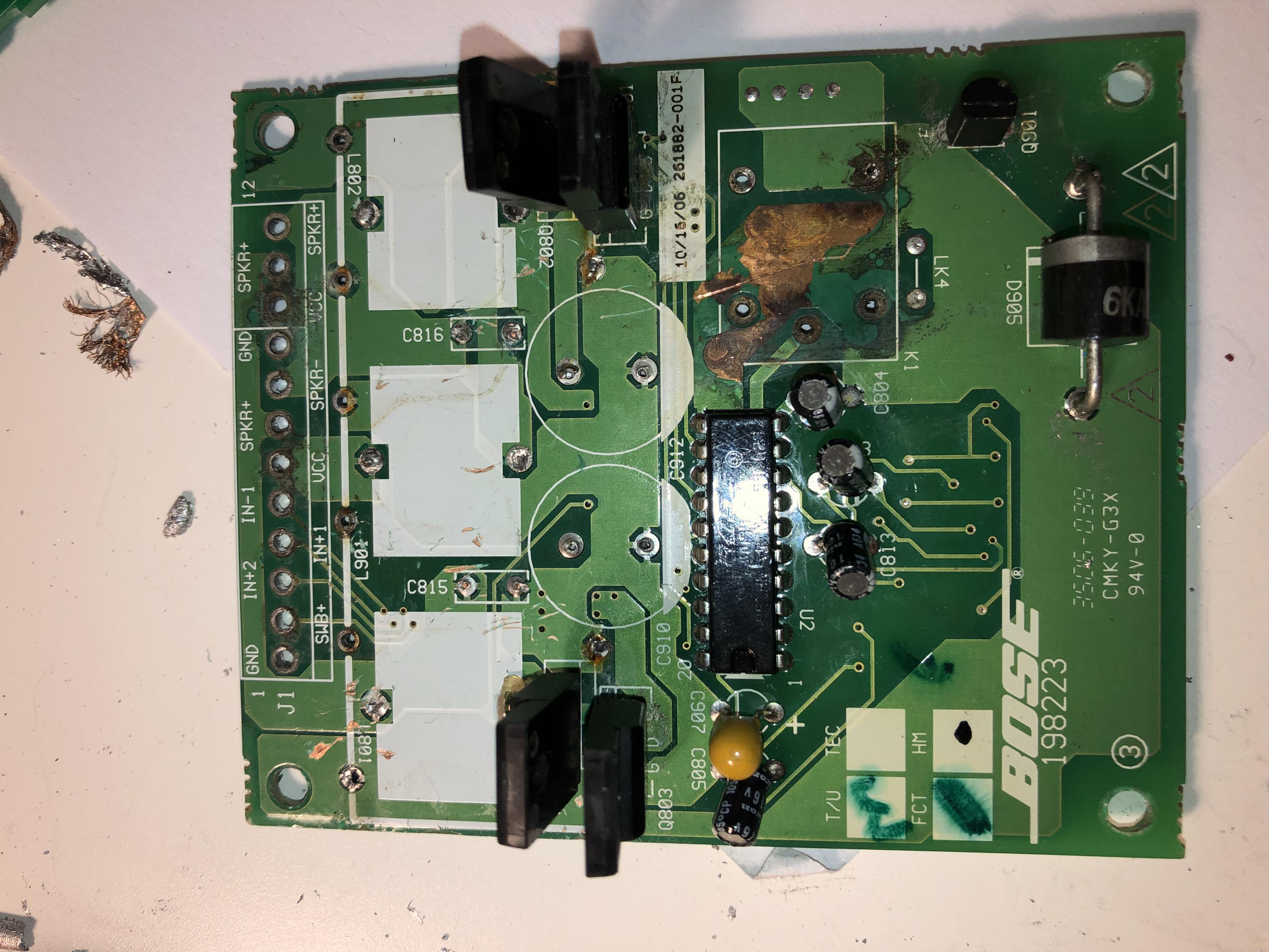

Then comes the reason why this is in the class D section. I own a alfa romeo 159 sportwagen with the Bose hifi upgrade. I always noticed that the system lacked bass and recently found out the subwoofer isn't doing anything at all.
So I removed the subwoofer (amplifier + woofer + plastic bass box) and measured the incoming five cables. The first two were regular audio out from the main amplifier, which gave a voltage reading in AC with my dmm. The next signal was a 12V dc which Is used for switching the amp on and off as the voltage dissapears when turning of the head unit in the car. The next two cables were the black mass cable (negative lead) and a regular 12V + cable.

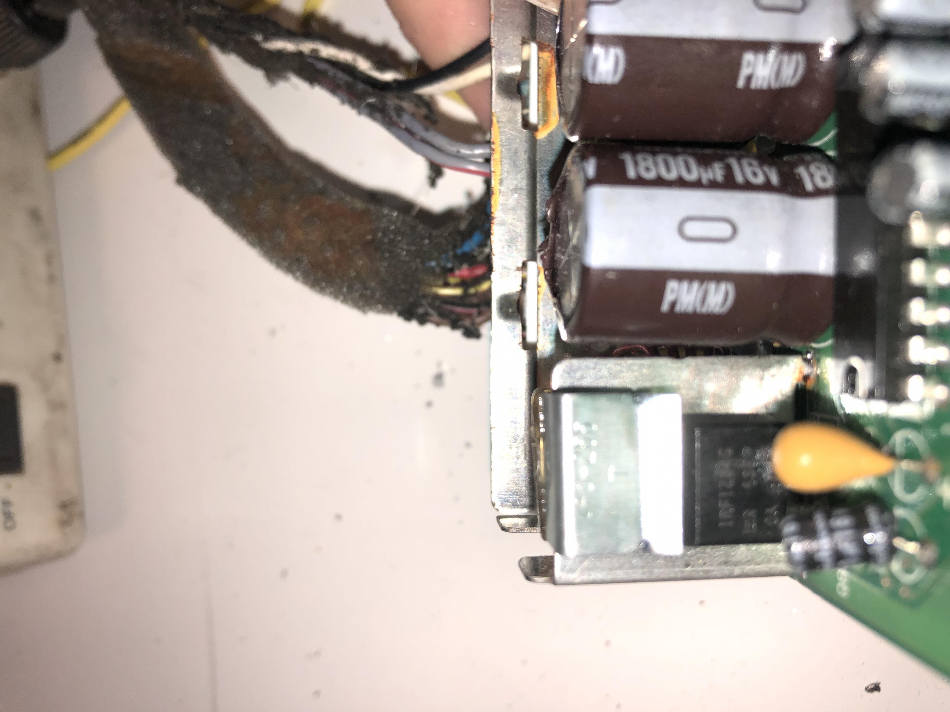

I inspected the bose amplifier and it became clear that it's not that exotic. I removed the 3 inductance coils, some caps and the metal plate in order to trace the pcb. I made a drawing of it in eagle cad, which you guys may know, which can be used in order to create a pcb drawing for manufactering. (I just used it to have a clear drawing of the schematic)
The conclusion came that the VCC in (12V) was detached from the green coil, where the voltage enters the system. As the VCC is twice on the board, I repaired the hole by lightly sanding the coating of the copper pcb plate and soldered a thick cable on it and to the underside of the VCC hole. The amp+subwoofer works now, however, the sound is weak and 'electric' on some notes.
I have a old amplifier at home, can I use it to put a sound signal into the amplifier subwoofer and use my power source with 12V to power the amp and turn it on? This would mean I don't have to put it in my car to test and I can turn it on inside the house. Or is there a better way to inspect the amplifier?

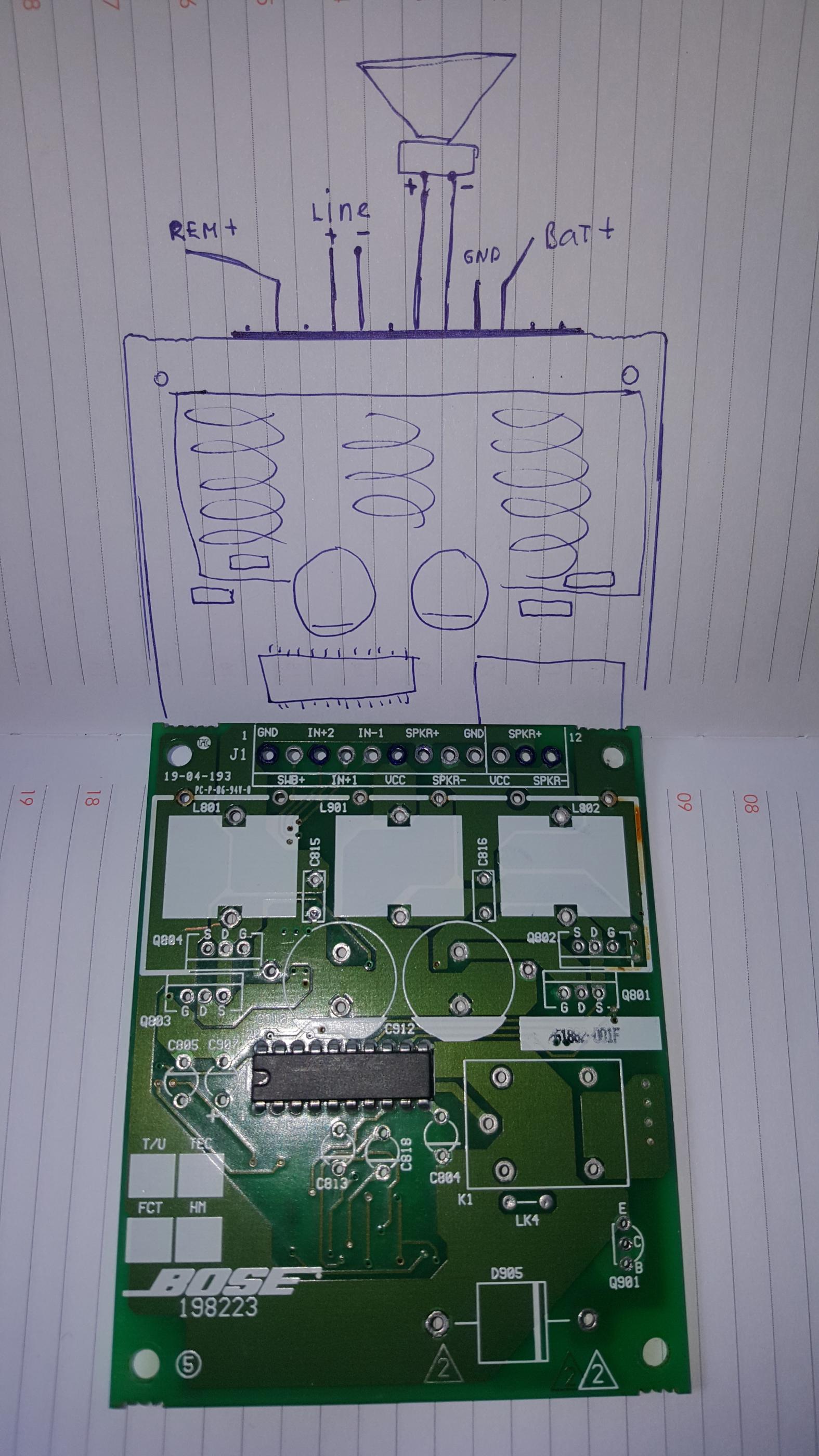

I attached two pictures I found on the internet. I'm currently not at home until this evening (I live in the netherlands) and will post the schematic plus pictures of my actual amplifier when I get home.

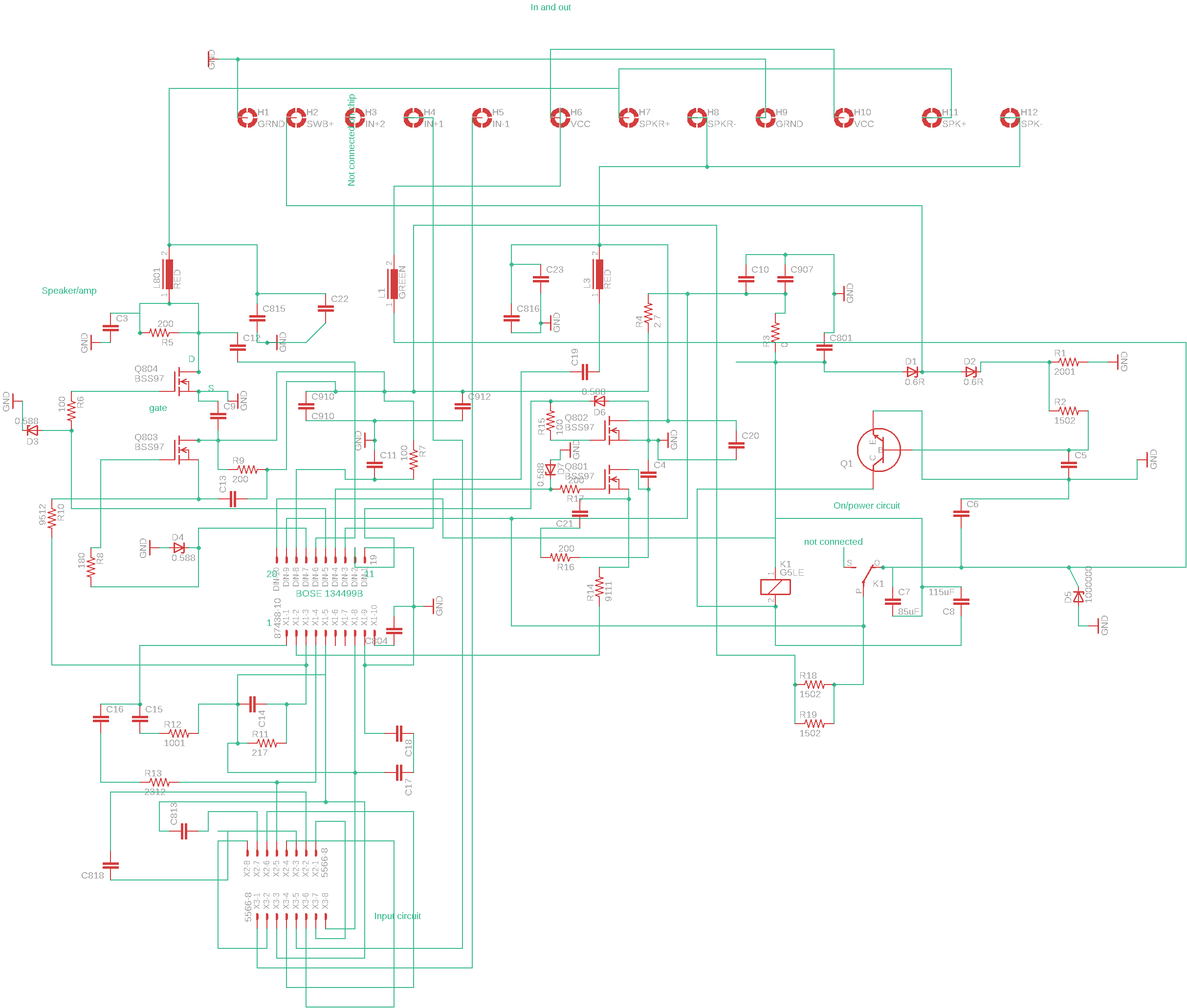

EDIT: note that the schematic is uploaded, but not all names are right, all of the SMD components on the underside are not named. Only the cap's etc on the top. I have not yet identified which mosfet's are on the board, so the name in the schematic is also wrong.

I don't have much equipment, I have a DMM, a component tester (which shows caps, resistors, transistors etc) a variable power supply.
I can borrow a oscilloscope from a friend of mine which lives nearby. It doesn't have an output, only inputs. In order to diagnose it, do I need a signal generator?

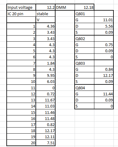

I measured the voltages of the transistors ( and mosfets) and main IC. (the 20 pin one which has a Bose description on top of it) Is it of any use?
The voltages (given in list form, not an inline mess) may be helpful. The IC 'may' be an HIP4080. The voltages may tell for sure.

Here are the voltages. If you need more components or something else, please ask. I also made a audio recording with my phone, but it's made with an iphone so the extension is .m4a, I don't know if you can play that. I think it's from itunes.
It sounds like the recording is bad (like when you record music which is too loud for your recording device), however in reality it sounds almost alike.

The casing of the transistor says IRF 1 Z 34 G ( If I'm reading it correctly)
Next line on the right is 538P. The GDS are labeled on the pcb.

If they're fully insulated, the part number is likely IRFIZ34G.
Signal tracing can work but you have to know the circuit and here, it will only be good up to the input of the IC since this is class D.

The ICs could be custom components made only for Bose. If so you will find very little information on them. You could ask on the class D section of this forum to see if anyone recognizes it.
If you want to clean up all of that flux, a toothbrush and acetone (preferred) or alcohol (91%) work well.
Where are the 4 IRFIZ34 FETs?
There is a virtually infinite amount of information on class D amplifiers online. The following are a very basic introduction.
http://www.irf.com/product-info/audio/classdtutorial.pdf
https://www.renesas.com/us/en/www/doc/datasheet/hip4080a.pdf

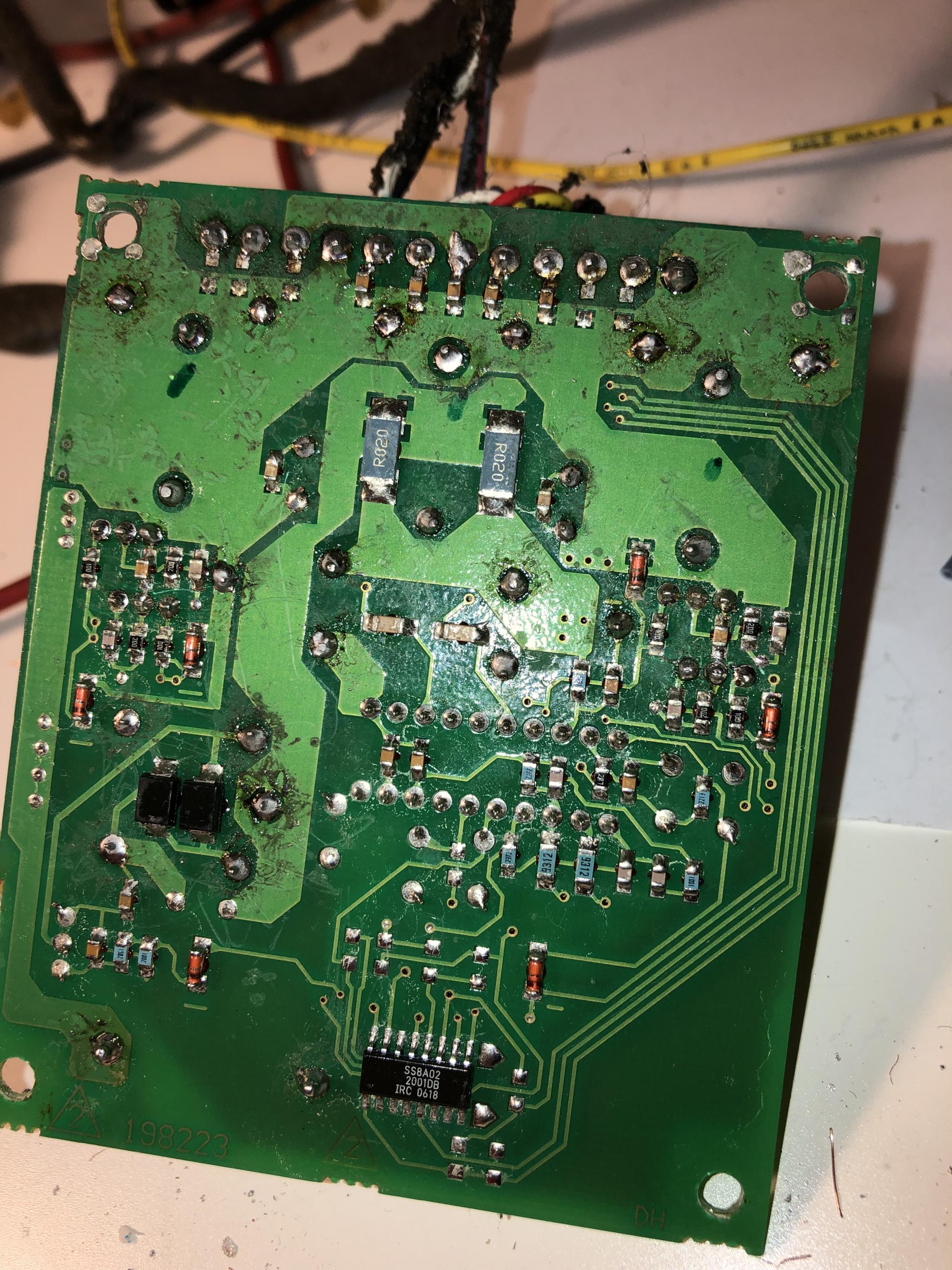

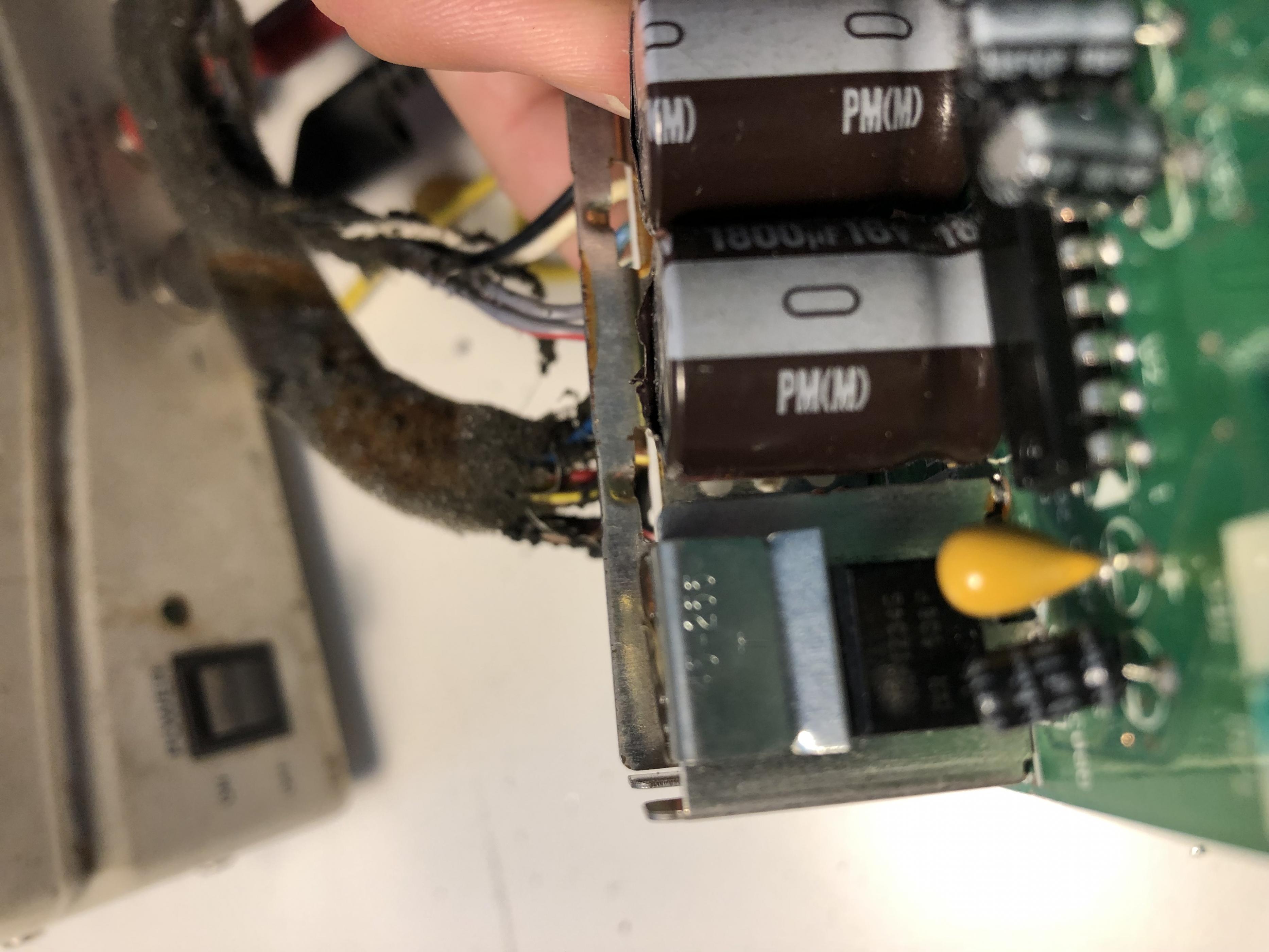

Here are some pictures of the components, I can't seem to get a clear picture of the mosfet. I will try to add some info to the schematic i've drawn in my first post this evening and make it maybe a little more clear to read.
Thanks for the links. As I understood, the signal from the IC is filtered high pass and low pass by the big capacitors and the inductance coils? When you get distorted signals and the filters after the IC seem right, what is the best way to go with diagnosing. I can remove the mosfets and test them with the component tester?

You start by looking at the signals on the drain and source of the FETs.
Learn to use a multimeter to test components.

I ordered a cheap signal generator in order to have a simple input on the amplifier, in order to measure distortion with the oscilloscope at the out signal. I don't know if I'm thinking right about it...
Also, I tested various components. The mosfet's are N-E-Mosfets with values around C = 2.24 uF, Uf = 575 mV and Vt = 3.7V.the four are almost identical in values.
As I understood, the coils and caps work as a high and low pass filter in the class D amplifier. Both coils have values of L = 0.02 mH and a resistance of around 0.1 ohm.
I added a picture of one of the caps (both have the same inscription) and an update scheme to my post. I tested all the traces when I made the schematic, I can't seem to find a faulty component either. Is it possible that the IC itself is blown?
