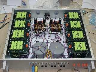

How does it sound ???
I do have a Borbely DAC , preamp, phonoamp and monoamps.
To me they do sound good with the standard components Borbely is offering. PS can be improved with Blackgate caps. But very much is depending on the trafos you want to use.
I had Pass Aleph before. Borbely to me is by far better.
Just my opinion.
Best emw

Hi Sigurd,
on my phono preamp i have a Nicd accu powersupply.
On my balanced preamp I have 4 x 100Watt Borbely Audio trafos, with the boards you mentioned, but with additional chockes.
I would not build the phono again with the accu ps. For me it is too much effort, charging and watching it does not less than 21 VDC etc... The Borbely PS Kit is as good as a battery /Accu ps.
I would go for chocked Borbely PS, but with Blackgate caps after the final regulators (if you will get BG´s ?).
On the phono board I have used BG aswell in certain areas.
Please ask Borbely when you order the parts, he will let you know.
Best ...EMW

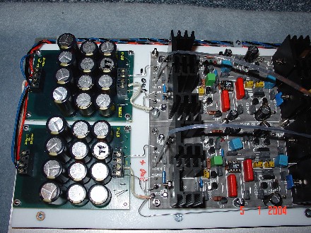

I bought the power supply kit, and have now assembled it.
Assembly was a piece of cake. All the small bags with components really made it foolproof to mount all the components.
Setting it to the desired voltage was simple, and the voltage is very stable.
Components are of very high standard!
I was positively surprised 🙂
Dale resistors,
cermet potentiometers,
Cerafine Fine Gold electrolytics,
Mundorf film caps,
Wima polyprop caps,
JFETs and MOSFETs.
If you are looking for a good regulated PS with good components, I recommend you to check it out.
Sigurd

Here are some photos I shot of the regulated power supply and the recifying supply kits.
Sigge
Sigge

Re: Re: Borbely PS has 5 uV noise and ripple - little or much?
Elso -
at last, I now have the 254 together with a Borblly Superbuffer1 and an unregulted PS 309 also from Borbely.
Here are some sonical impressions I have. I compared the Superbuffer1/254/309 with a TX102 transformer volume attenuator.
I use the Superbuffer1 with Teflon PCB and Caddock high resolution MK132 resistors for the input, output, and feedback resistors. I also opted for the high output current option that is supposed to give better bass (and the SB1 can now also drive 600 Ohms, which I do not need). Instead of the voltage references, I have installed blue LEDs.
Transformers are 225 VA toroids from Amplimo that are potted, and shielded against both magnetic and electric fields.
The Borbely preamp is built up like dual mono from the AC outlet and onwards.
A mains net filter from Schaffner is also used for each channel.
For the stepped attenuator I use DALE's CMF55 non metallic resistors.
Silver wire is used for signal wires.
Standard gold plated chassie RCA connectors.
To summarize
Both me and my wife find that Borbely's Superbuffer1 sounds better than the S&B TX102 transformers. More detail, more slam, another octave of deep firm bass, and better focus and clarity on voices.
Sound comparisons
Both these preamps are of very high quality both regarding component choice, mechanical properties, and sonically. No doubt about that! Still, it was not that hard to hear that they did not sound the alike.
I built the TX102 preamp some months ago. The sonic character I hear is a smooth, bass-rich sound with great sound stage, a polished treble that is never hard or cold, and a body for each individual instrument (on good recordings) that can be very appealing. Details are OK. Transients could be better.
The preamp made up out of Borbelyäs designs has been online since a month and the SB1 is now fully burned-in. It sonic character is one full of details, resolution is higher than I ever had heard before, each instrument is clearly heard through a mass of instruments with a very good focus and body. The body I heard on the TX102 preamp is more muddy in comparison. Voices are better as they are easier to hear, more realesed, with better clarity. Soundstage is great with wonderful depth. Transients scaringly fast. Slam is fantastic. Bass is firm, powerful and deep. I did not know that my speaker could deiiver such a deep bass.
