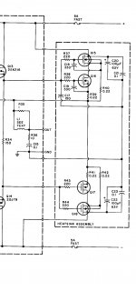

An acquaintance asked me to look at this DC 100 he built back in the day. The left channel is out. At power on, the right channel heat sink warms up nice and toasty, but the left is cold. Here are the voltages I'm seeing, left and right, for the K135 and J50 output transistors:

I meant to post the circuit details of the output stage, but epicyclic beat me to it. See his post with the attachment.

The drawing is a bit unconventional (drawing a connecting link through the FET symbol) as the FET's are actually in parallel, each having a 0.22 ohm in each FET's source.
Lets go back to basics. The voltage across the 150 ohm at the left (R34 in the latest diagram) is what will determine if the FET's should be drawing current.
Can you recheck the voltage across these 150 ohm resistors. It is a single reading we are after (red lead on the top of the resistor, black lead on the bottom end). If you have 800mv (approximate, probably even less than that in practice) then the FET's should be on and pulling current. So compare both channels. Lets see what is really across the FET gates and whether they should be on.
The 0.22 ohms can be checked in circuit, if they read essentially short circuit then they are going to be OK.
Lets just clear up this bias question first.

Interesting, and yes, it is across the 150 ohm that was of interest.
So 1.4 volts should definitely be turning the FET's on quite significantly. That voltage should also vary with adjustment of the bias preset.
Although not 100% accurate, a quick simulation of that bias voltage across those lateral FET's should be letting around 280ma flow... split between each pair. That in turn should certainly cause them to get a little warm.
