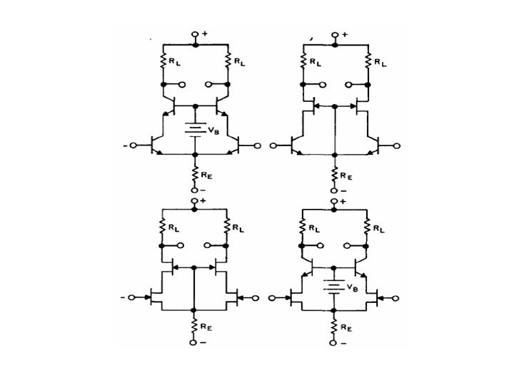

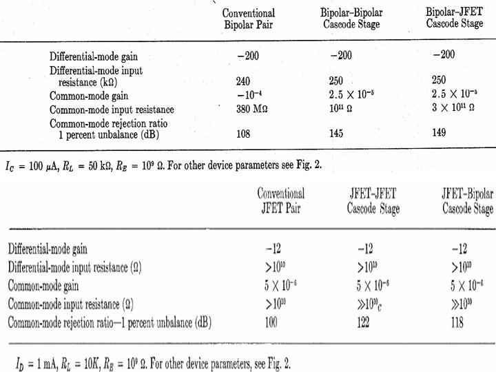

Common cascode topologies

Onvinyl said:
Lumba, this was the tip of the day. simmed a folded cascode made of an discrete sziklai pair, simms great.
Now I have to look if it works in reality equally well.
Rüdiger
Where did you put CFP pair? In common base transistor place, folded cascode design?
FC works very well if you use current sources instead resistors in series with BE cascode transistors.
