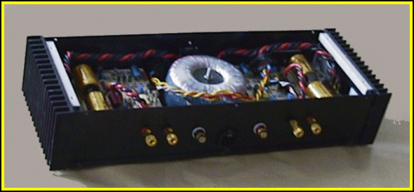

I made a modified Servo 100. Higher rail voltage and some other smaller changes, and 6 pairs SJ55/SK175 per channel, biased to 1 amp it also gives some class A output. It produces 250w in 4 ohms, and I measured distortion to 0.0034%.
It sounds fantastic.

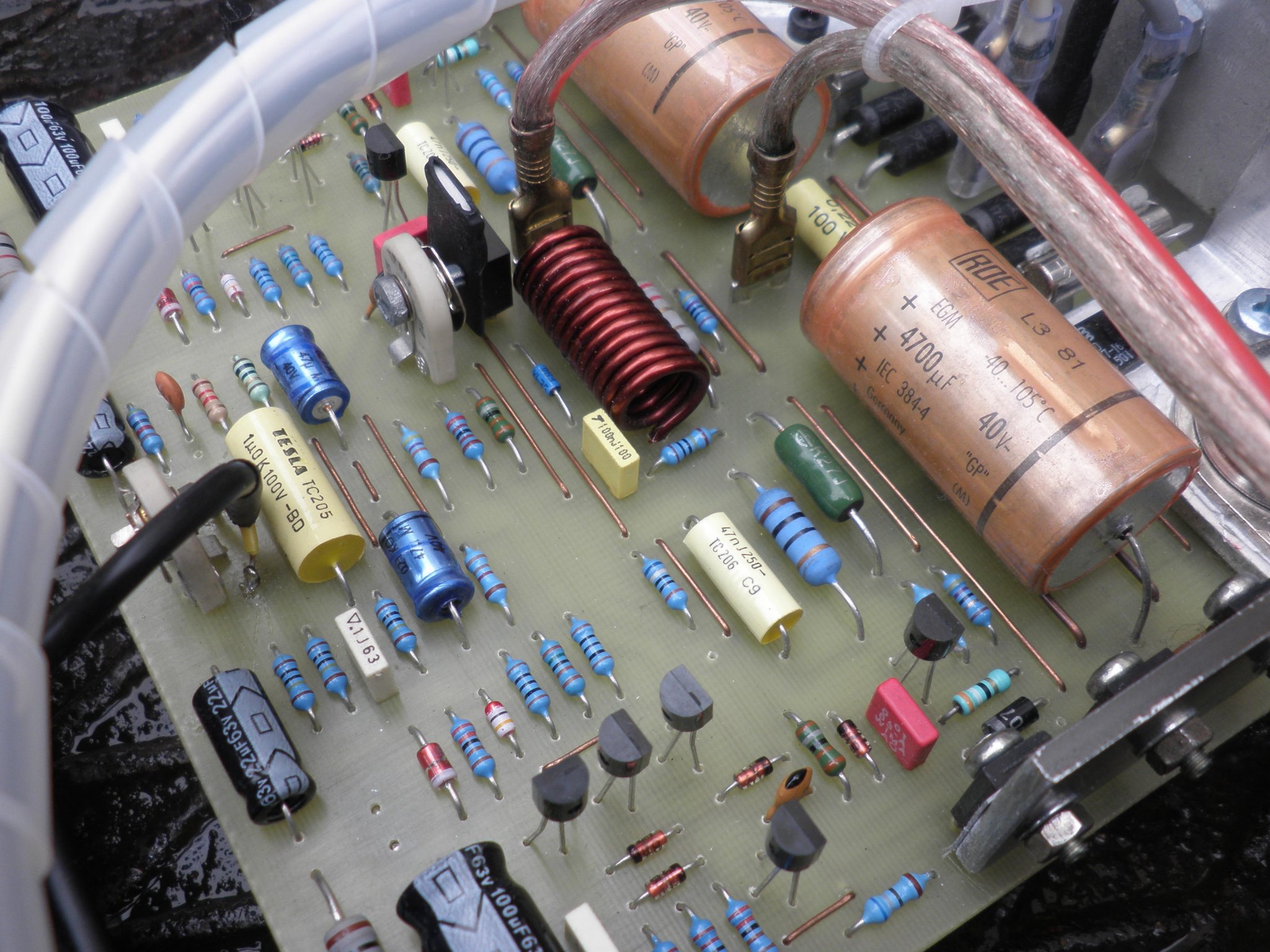

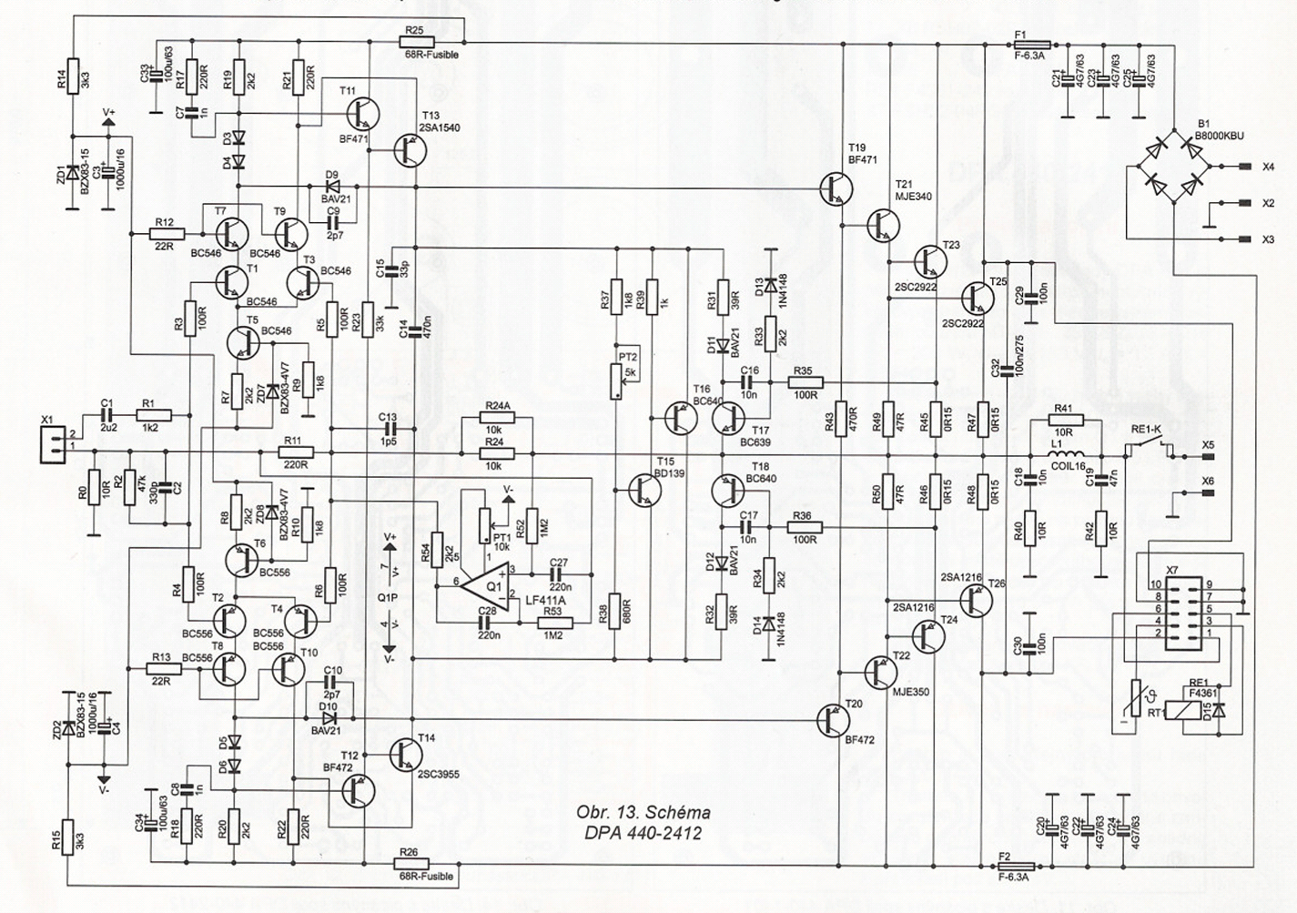

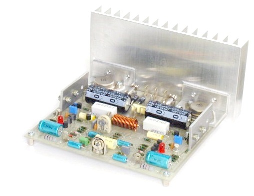

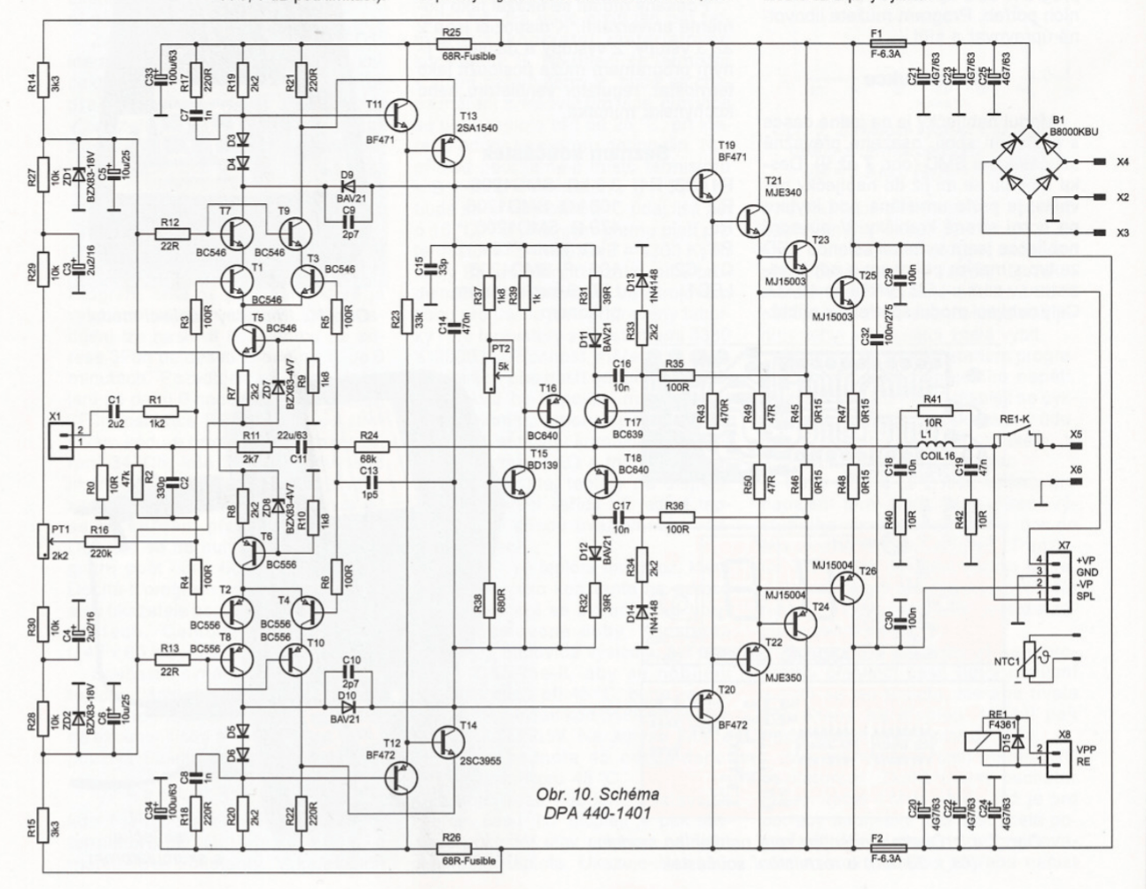

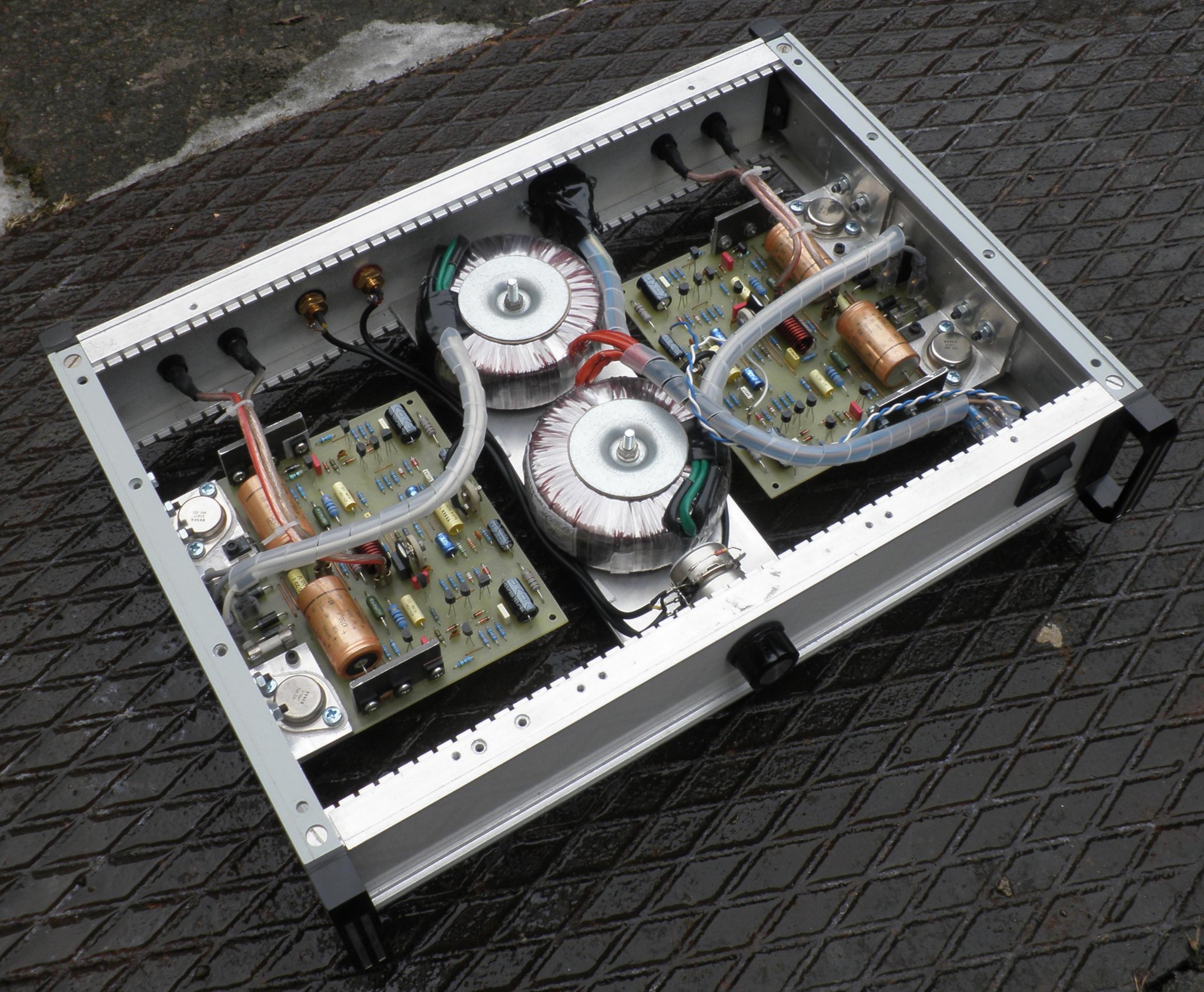

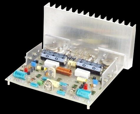

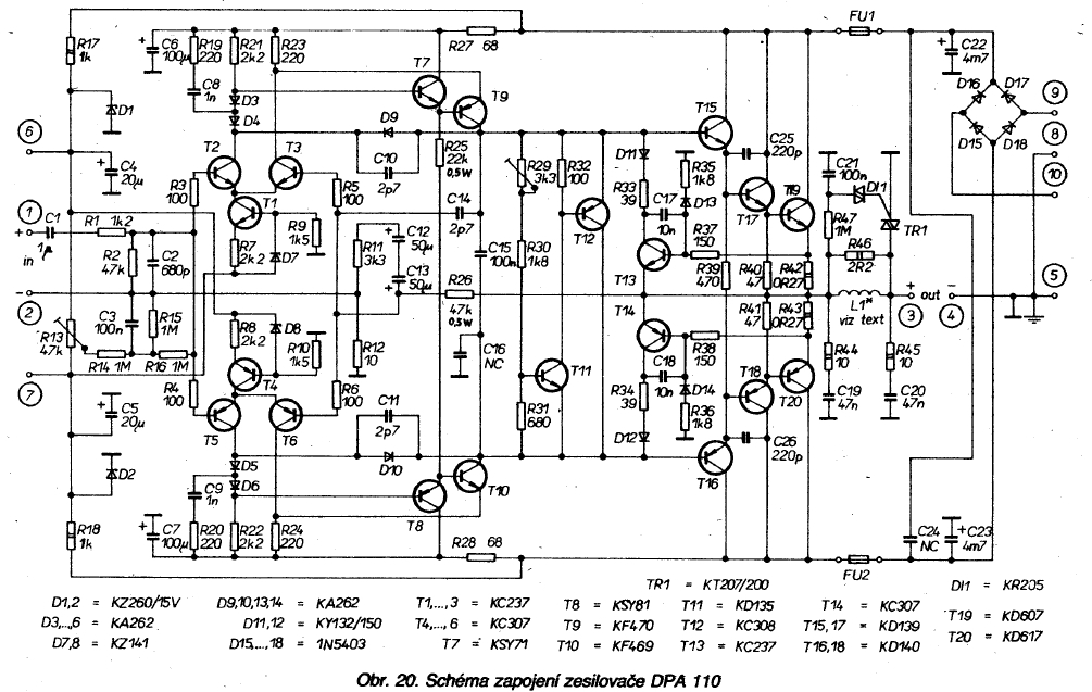

Mr. Pavel Dudek developed in 1992 year the Borbely-Lender schematic in the family of DPA audio amplifiers.
Here you have the old DPA110 project:

DPA110 looks like the front end of the 60W mosfet design with bipolar output stage.
I notice it has DC offset adjustment. Has this proved necessary in the Borbely mosfet designs? Is it not sufficient to match hfe of the input transistors?
