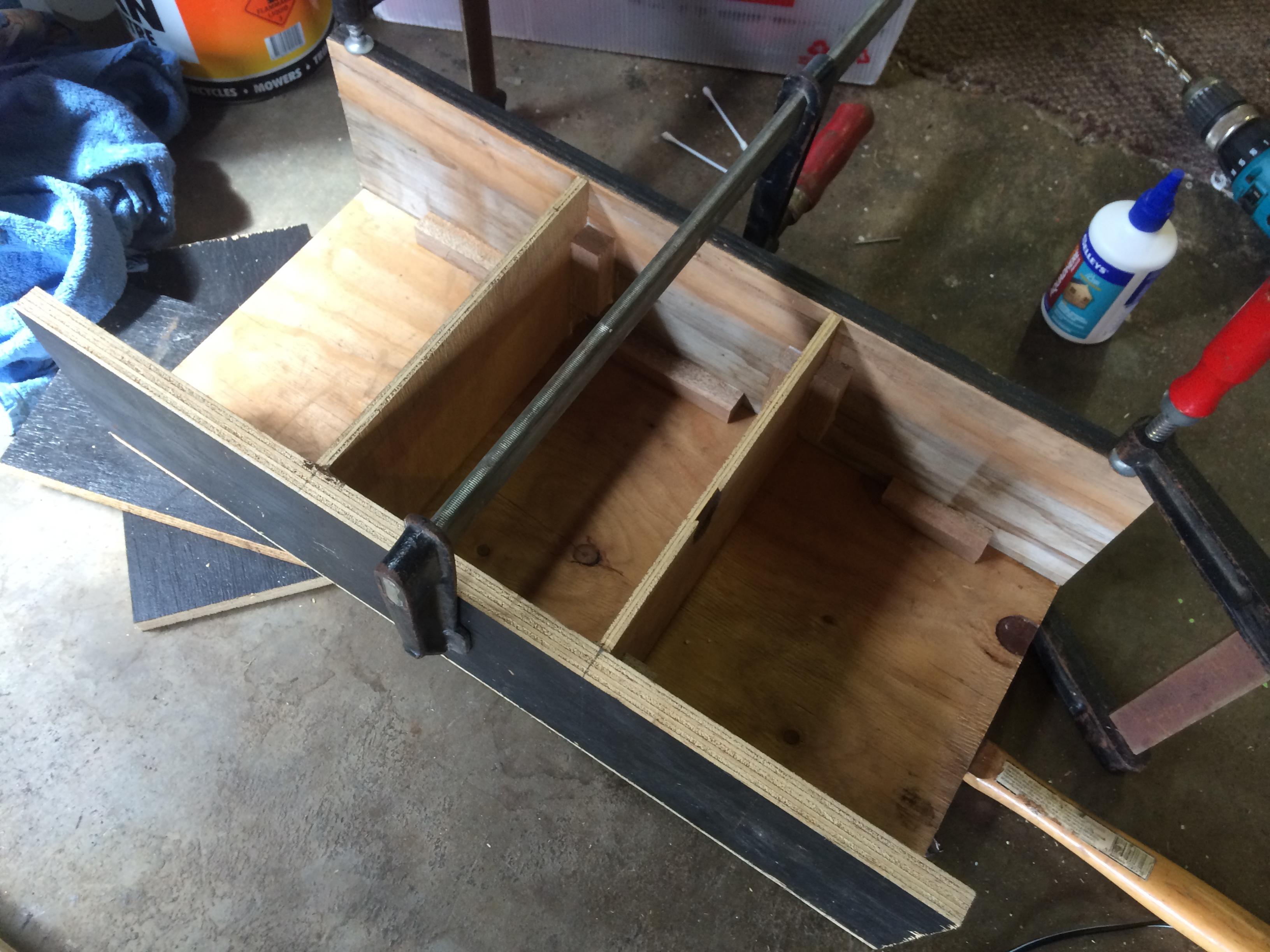

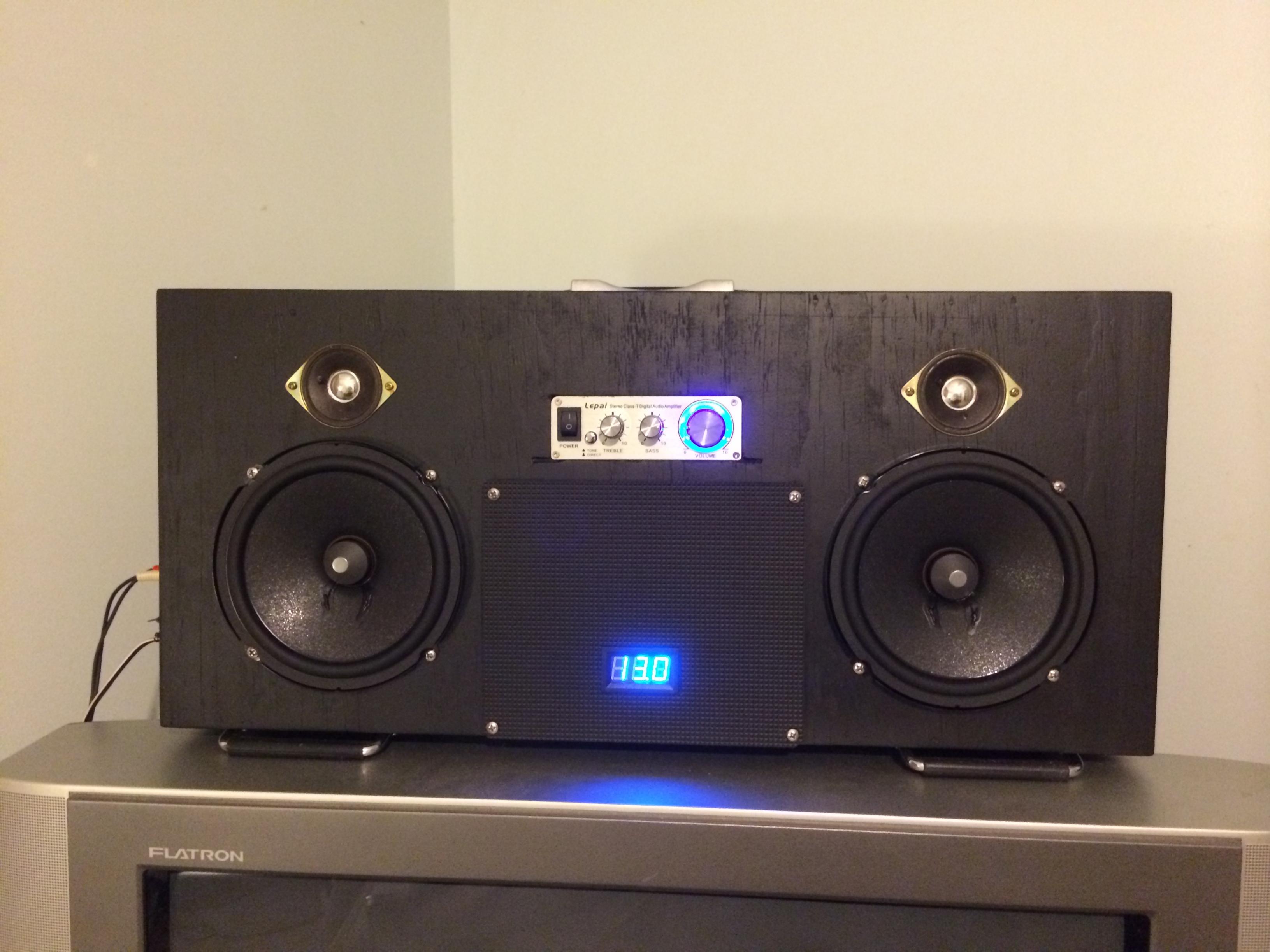

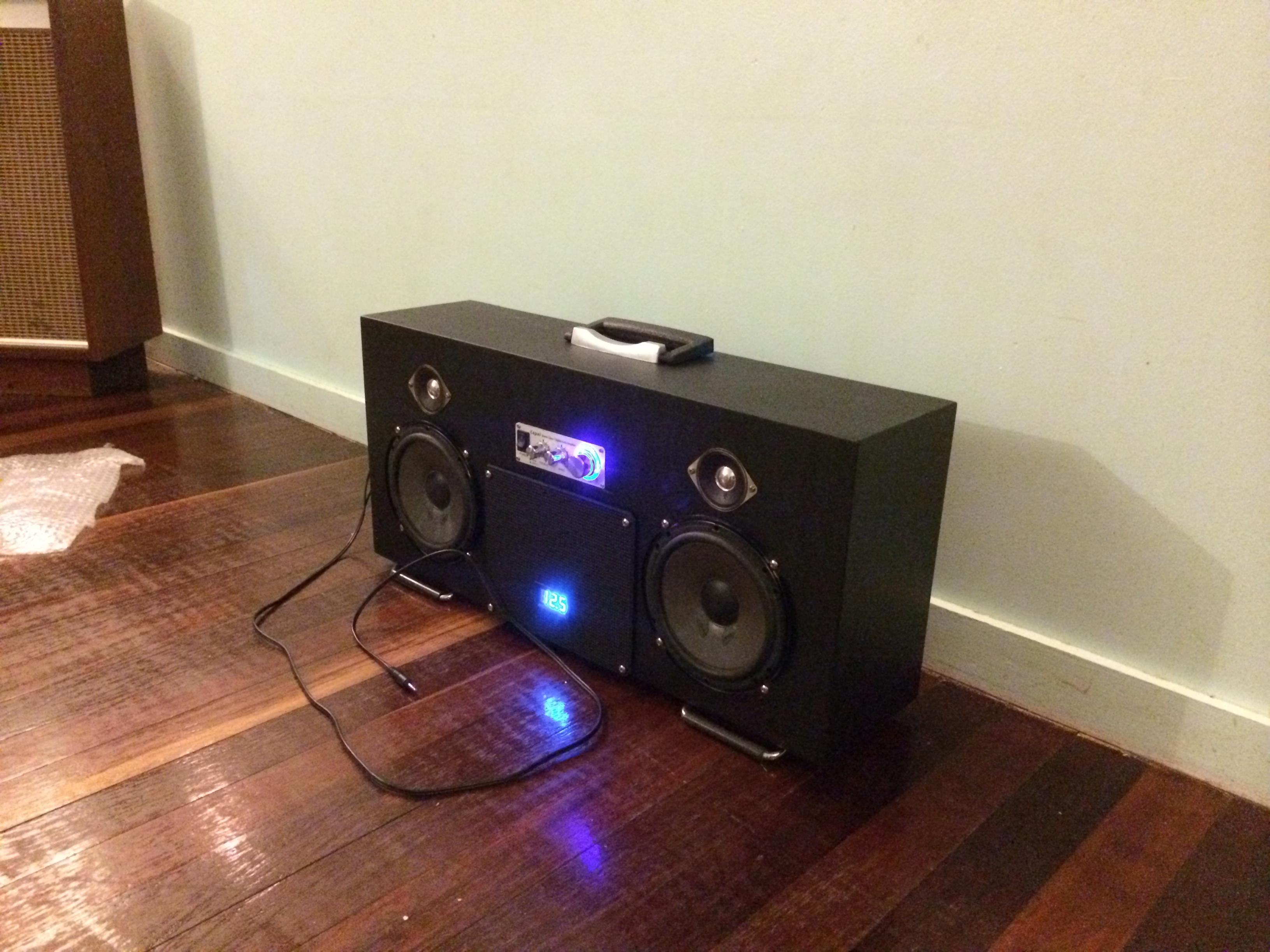

Hi from a new member,
I've been lurking for while now gaining various bits of information to help with the design of a DIY Boombox I completed a couple of weeks ago.
I used second hand 17mm structural plywood for the top, bottom and sides and some scrap 7mm ply for the front and back panels.
I went with the Lepai LP-2020+, two Pioneer 4 ohm car speakers, a 9 Ah SLA battery, a cheap volt meter with side mounted switch and a marine female car charger plug for charging the internal battery and for recharging an MP3 etc + an RCA chassis input. I sourced some tweeters from an old Sanyo M9998K boombox (1979) and used the metal feet that came with the Sanyo.
I went with separate sealed boxes for each set of speakers filled with padding. Simple construction but very solid - no vibrations etc.
I originally wanted to create a DIY box that would sound as good as a classic boombox but would be able to utilise a rechargable battery. I tend to use my boomboxes outdoors and was sick of paying $35 per set of 10 D cells (killing a set in under an hour!)
I'm very happy with the sound of this DIY box. The Lepai seems to drive the Pioneers pretty well - It pounds with good bass and clear highs and is plenty loud outside! It far exceeds the sonic abilities of my boomboxes! This little amp seems very efficient as you can run this thing for days and days before a recharge is needed. 🙂
You may notice the speakers were changed in the last photo - I upgraded to better drivers as my second hand set were past it! Total weight came in at 9.40 kgs fully loaded with the new, heavier drivers.
I'm now working on a slightly bigger box running 8 inch drivers - I can feel another addiction taking hold!
