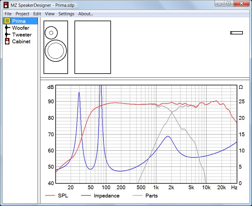

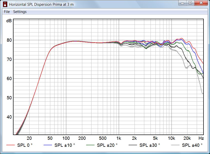

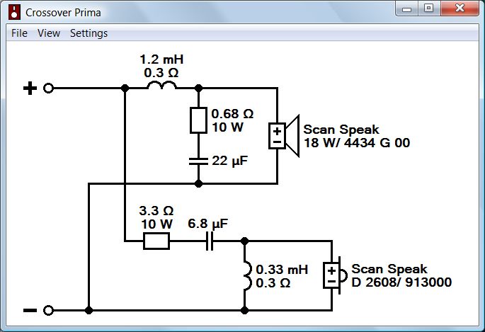

There's an excellent design that is little known because it's from a French diy site, the Prima: Prima - JustDIYIt !
It uses my favorite drivers from the ScanSpeak Discovery series which offer great performance for reasonable price. The crossover is simple and very well done IMO. Drivers are around 300 Euro.
Edit: I just noticed the crossover below is the old one and has been slightly modified in 2013, sorry.
