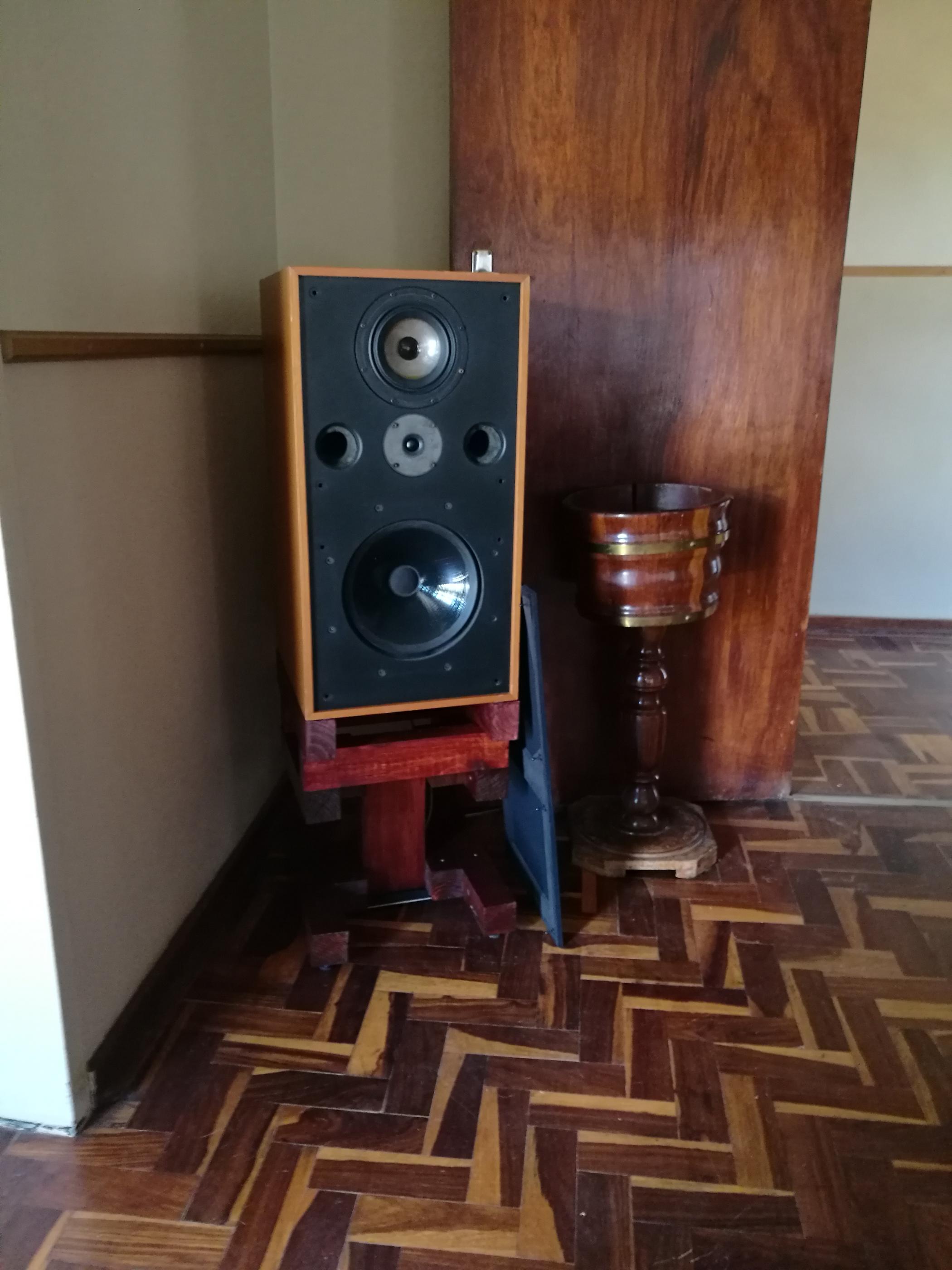

I have a pair of Dynaco A50's which is very special to me, I have a pair of AR66bx monitors and then I have the King of all, a pair of Spendor S100, I will never let them go, have never heard such clean midrange and balanced sound !! 😉
