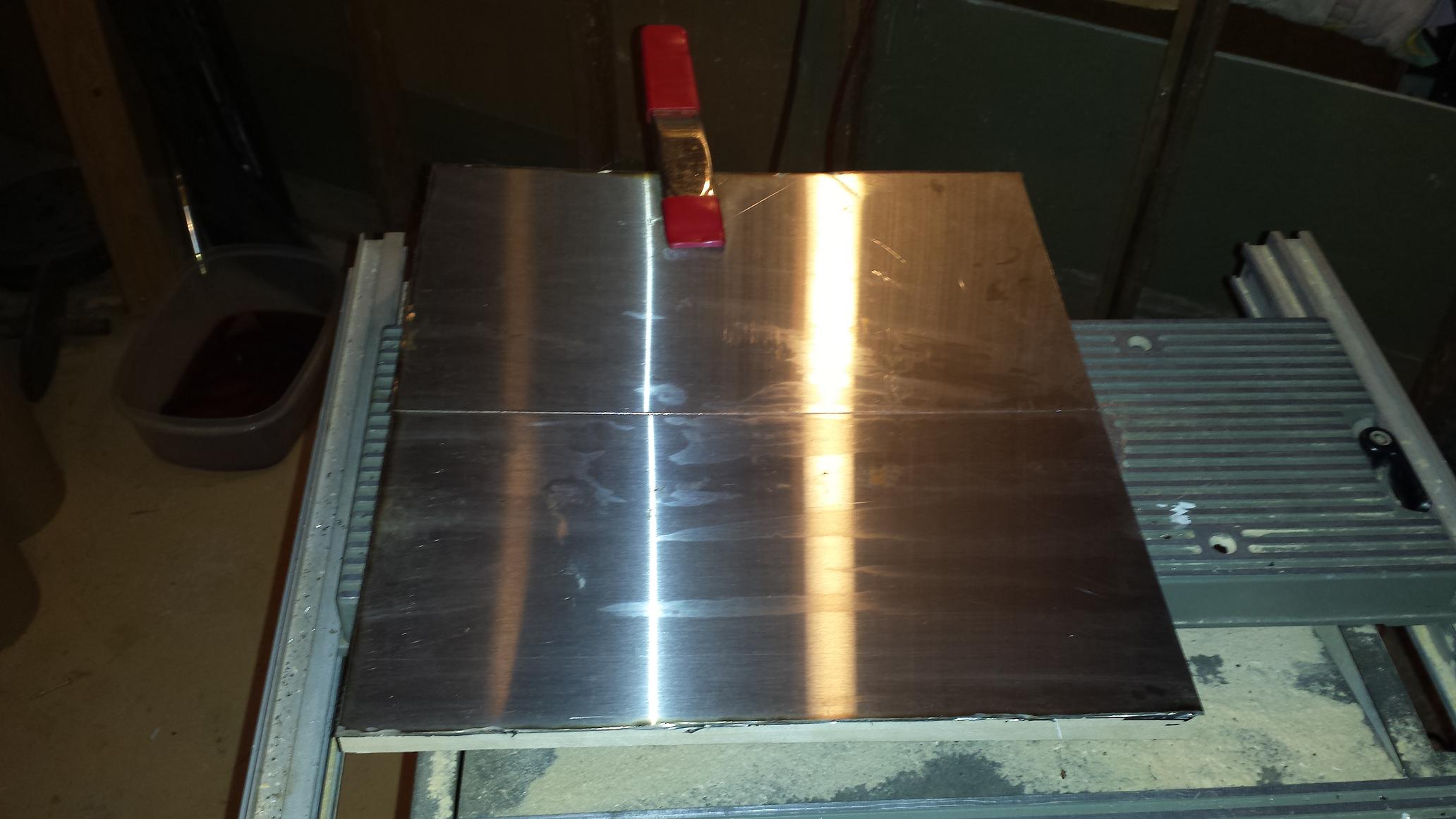

Thanks, I appreciate the useful ideas. I salvaged some. I weighted a piece over night to true it up. On a flat surface placing ply and a couple 10lb barbell plates on it. Then screwed and glued some hardwood strips to the underside. Hopefully it will stay put because plans are a surface for a stainless steel tube amplifier, that should display nice.

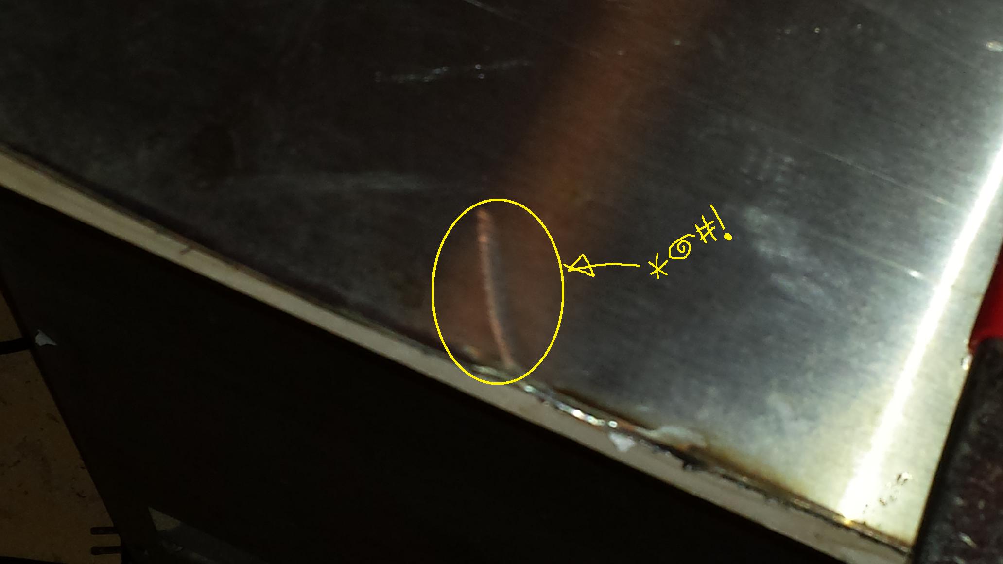

I prefer cutting the steel outside in the natural light, but falling snow didn't allow me that option. Thats when screw ups like that can happen -->.
It was the first pass, it MIGHT of skidded off the felt ink line (Id rather blame that lol). I plan to re brush finish because it already has light scratches. But the gouge is just too deep to remove.

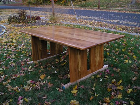

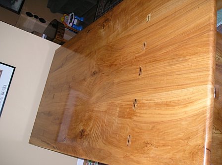

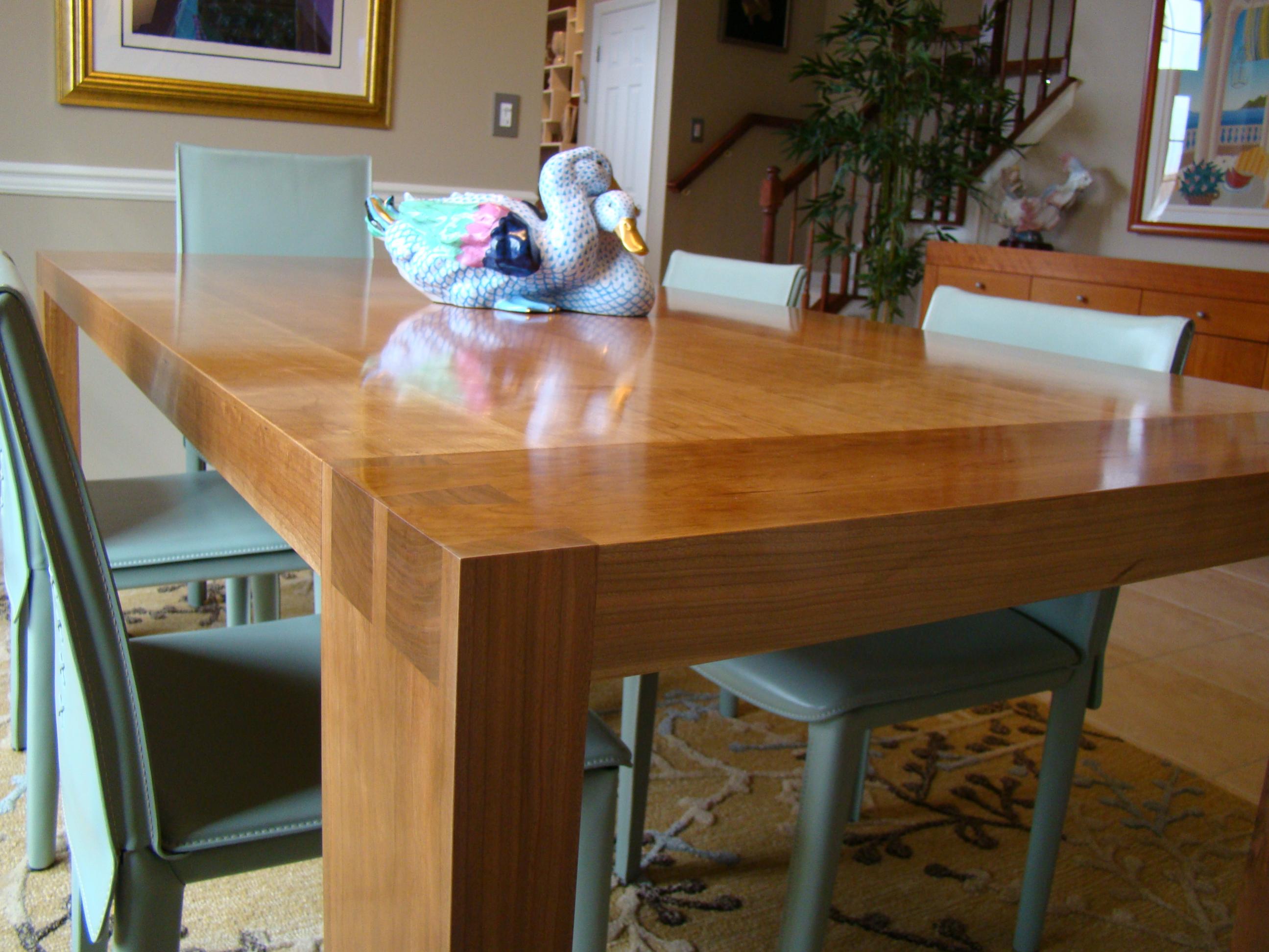

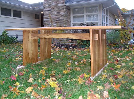

Here are a couple tables.... The beech I cut myself... Table is about 4' by 9' The cherry is solid leg sections with a top that has a cardboard honeycomb core.
Excellent work! I particularly like the one displayed in pic#5 and the way you notched the legs where they meet the table top.
That's not a table, it's an airplane part.
Why buy made junk at a stupid price level, with unflexible sizes, if one has to look at it for decades, I says.
