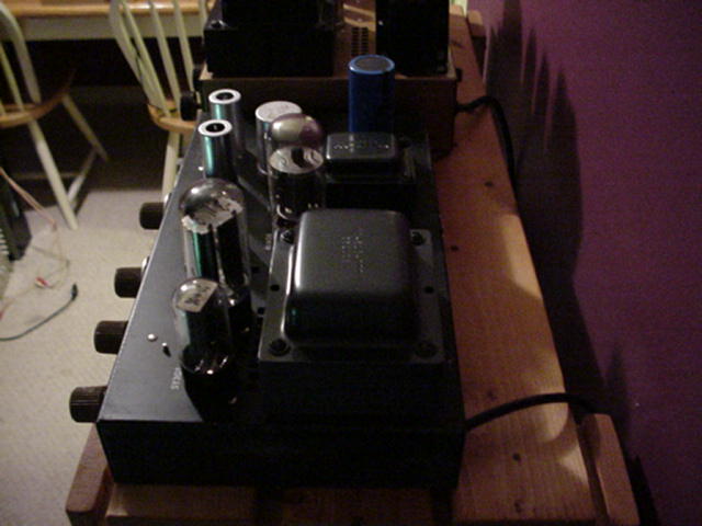

Hello,
I just picked up a Bogen DB-130 because it has a few EQ curves for 78's. The power cable was dried out so I replaced it. The fuse it came with was not burned so I figured let me plug it in now and see what happens. It worked fine for about 4-5 minutes. I then began to hear a boiling sound by the power transformer. The audio was not effected, but the boiling sound quickly got me worried. There are also 3 huge electrolytic caps by the transformer and it sounded like the sound was coming from them. I immediately turned off the unit, unplugged the power cord and the RCA jacks. I then felt the transformer to see if it was hot, it was not. Then I felt the three caps and two of them were very hot. I remember reading somewhere that as caps age their membrane can become damaged which would warrant replacement. So I am assuming these caps should be replaced.
Any thoughts on this? Should I bother trying to repair the Bogen or should I look for another tube set-up that has different EQ settings or just go with a modern unit, for eg. SMART phonoe ReMaster. I figured the older tube set-up will give more of a genuine sound.
Any help would be most appreciated.

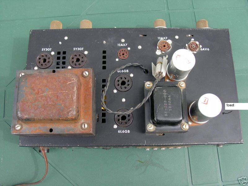

i had the same problem with my bogen cha 33 i got last week.
used a variac worked good than i turned it off came back turned it on right away there was a boiling or poping sound. shortly
after it blew the fuze. bad 400V cap replaced it works great.:mischiev:
And everyone thought it was going to be the transformer. Lot's of rusty tranformers work just fine.
You need to slowly build up the cap. Way slower than just bringing the unit up on the variac. It was going to go anyway.
