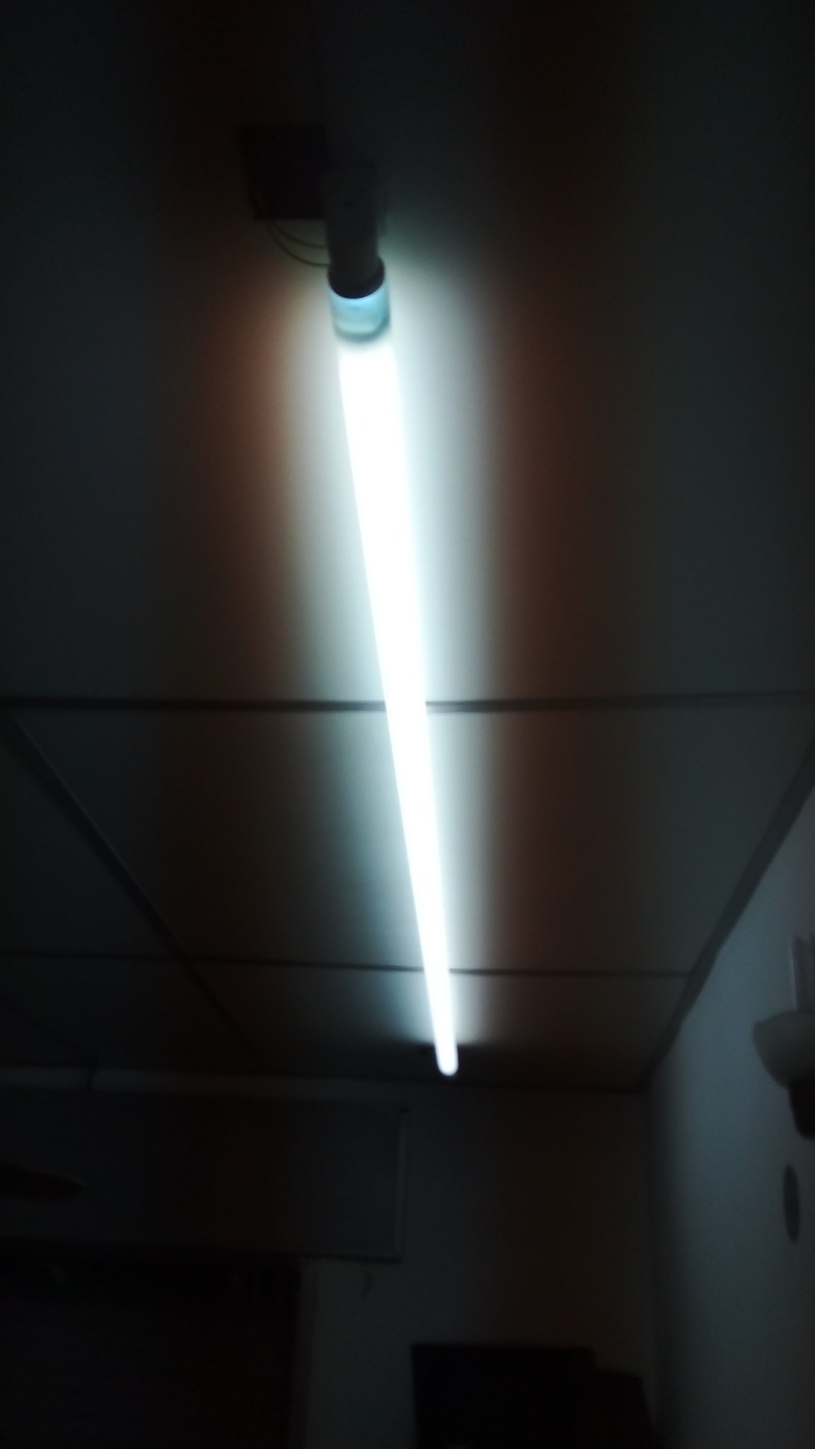

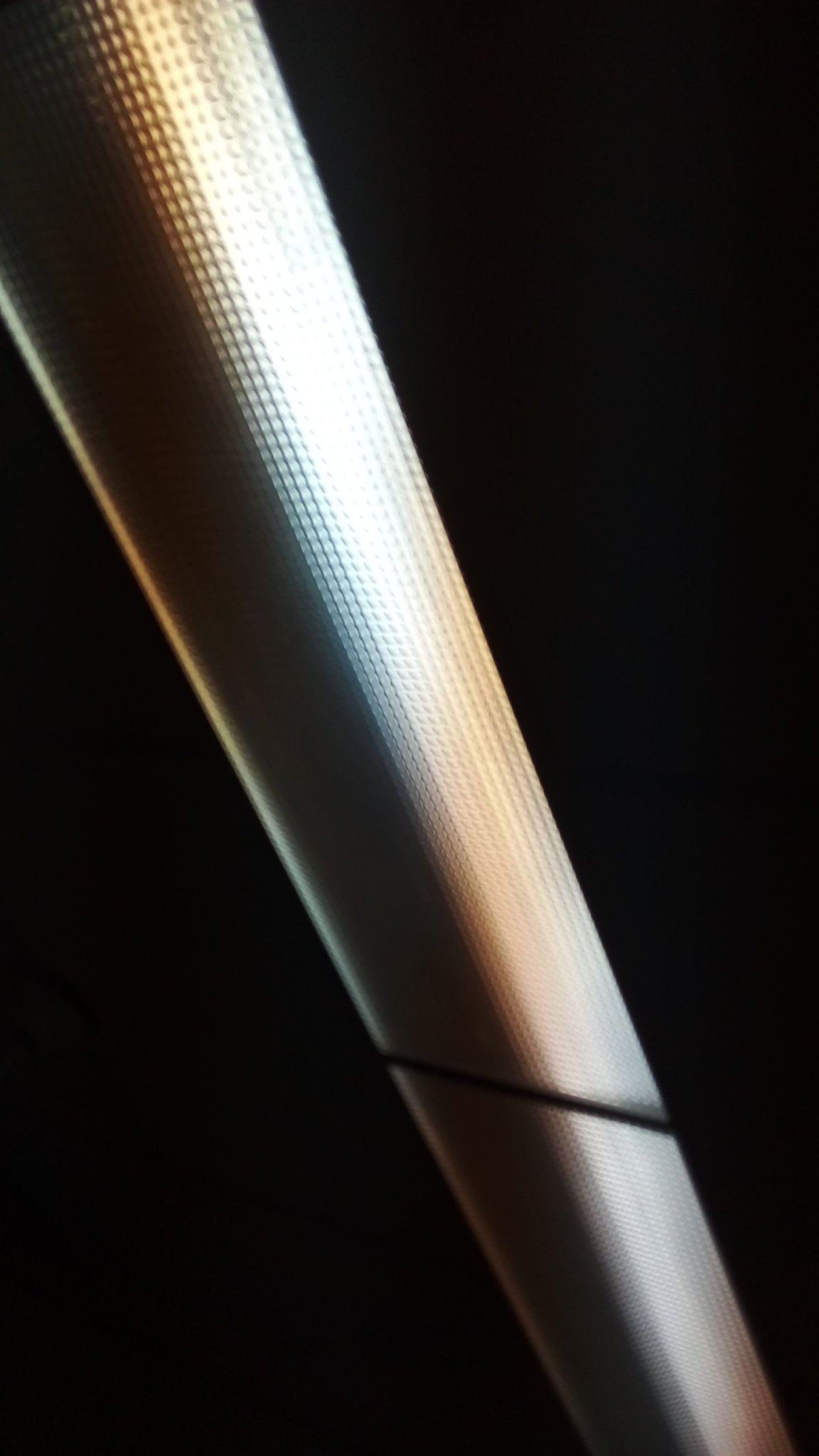

Yes, I know that. But mine are 20 years old, run with electromagnetic ballast and only replaced 2 of 5 in my home durind this time. Over it, they generate low EMI unlike electronic ballast and leds. As ham radio from 1987, I have a strong interference in the 2mts band (144MHz !!!) when led lighting at the street start to glow. Below two 105W lamps.

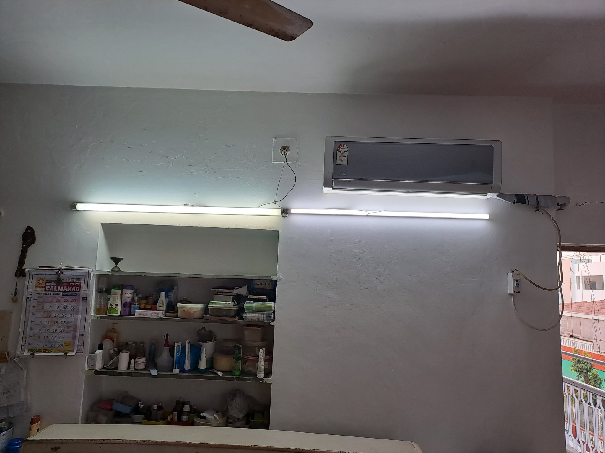

In the picture, 40W fluorescent on left, 20W LED on right.
Not much difference in foot prints.
My dude, this is not good. Both are bunk. Sorry but you are comparing a crap fluorescent to a crap LED. Go find some pictures of high quality lighting and start figuring it out from there. What your photo depicts is about two steps above a little LED headlamp. And who wants to read a novel to a blue tinged 6500K headlamp?
Edit: and don't come at my with "muh cost." I just gave you a data sheet of emitters that would cost you about five USD to replace both lights in that photo. To the point that you would want to puke if you had to revert to the ones on that wall.

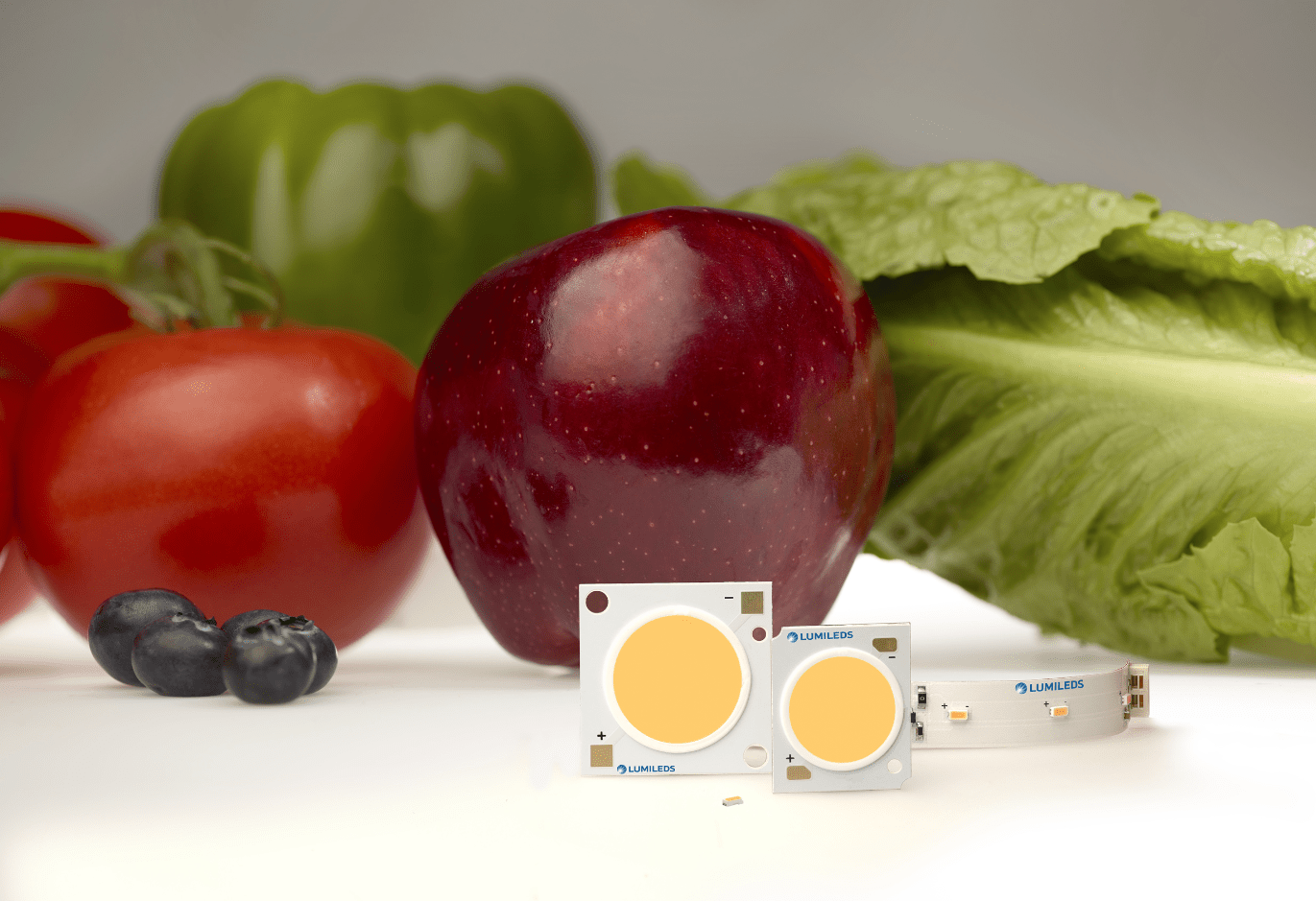

Look at these emitters that are tailored just to make fruit look good:
