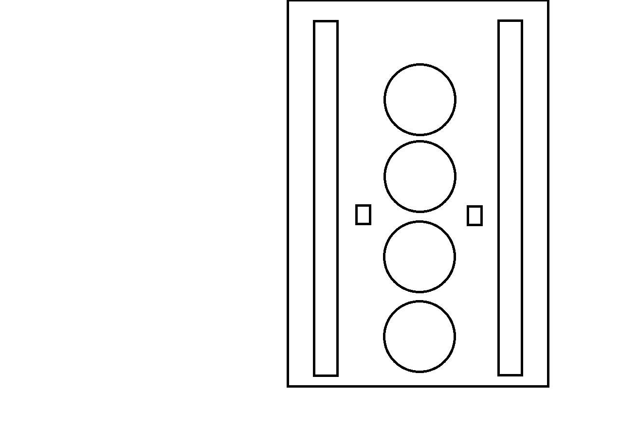

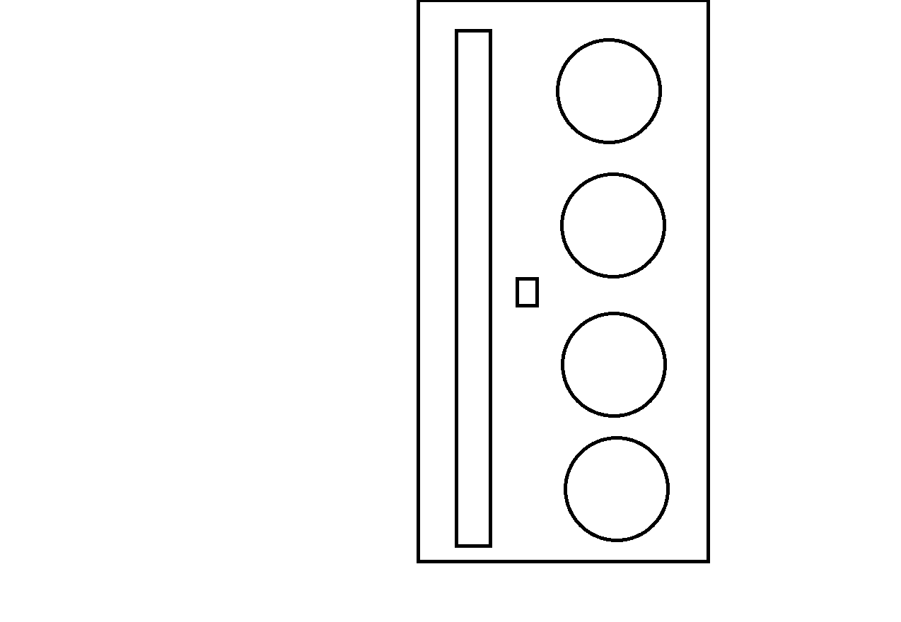

Below is the design of my open baffle speaker. It uses 4 AE Dipole 15 inch woofers for low frequency, Planar transducers for the mids, and 2 Aurum Cantus striction tweeters for the high frequency.
Note: I do not have money to build these right now. This is just for fun.
What do you think? Is it overkill?

Bg planar = $753.50 x 2. (4 total for pair)
Aurum Cantus AST2560 Aero Striction Tweeter = $169.49 x 2. (4 total for pair)
AE dipole15 = $314 x 4. (8 total for pair)
Total cost for pair of speakers minus cost of crossover and baffle = $6203.96!!!!
HOLY SCHNIKES!!!!
The baffle will be sand filled and the crossover will use high-end silver oil caps and copper foil inductors plus high gauge silver wire throughout.

Stig, I know your thread well, I followed it. Are you absolutely sure that your speakers would not benefit from one supertweeter in the middle? Just a thought, maybe be worth the try.
There are two sides to this.
Yes, in theory the RD-75 could benefit from a supertweeter, since the dispersion starts to narrow above 5 kHz or so, and the frequency response drops like a cliff above 18 kHz.
The high-end roll-off of the RD75 is easy to fix with EQ.
The other side is how to integrate an omni supertweeter with a line-source driver. We will have two drivers with very different polar patterns, and one with 3 dB loss per doubling of distance, and the other with 6 dB. The tweeter will also have to be placed on the side of the RD-75. This combined with a high XO point will result in severe lobing in the horizontal plane.
Ideally a supertweeter should be a long very narrow ribbon to make it line-source, and to get good horizontal dispersion. And it should be placed almost inside the RD-75 to reduce the horizontal lobing.
As you see is it not easy to integrate a supertweeter with the RD-75.
When it comes right down to it the whole supertweeter thing is in the realm of the 1% icing on the cake. I've no doubt one could live without it, and as Stik mentions the integration of a supertweeter with a line source dipole isn't exactly easy. On the other hand for some that 1% becomes a major goal. The Enigma supertweets were special but then again they cost more than a full stereo pair of RD75 with Acoustic Elegance Subs would run combined.
