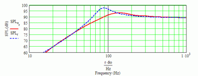

I am opening a new workshop and I really need some advice. It is roughly 25'x50' with concrete floor and 17' ceiling.
My question is does anyone know if these are a decent match for a BIB enclosure? My idea is to use an inverted BIB to couple bass to the floor.
Can I just take the dimensions for a Pioneer BOFU and use that?
I don't remember Vas. I'd guess ~ 1 cu ft
Fs is ~ 110 Hz ...... Qts ~ 2.2
Very close to the mean for this type of 8” IME, with the Bogens I had measuring very close to the old RS 40-1271, 1272 series, so for cab designing, a good ‘worst case’ set of specs to ensure a large enough cab to have some tuning flexibility:
83 Hz Fs
32.85 L/ 1.16 ft^3 Vas
2.446 Qts
This equates to a nearly 71 ft^3 BIB!, so not really practical per se, especially when used inverted with a very high Fs driver.

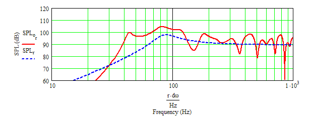

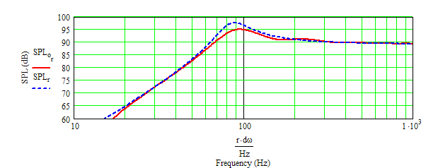

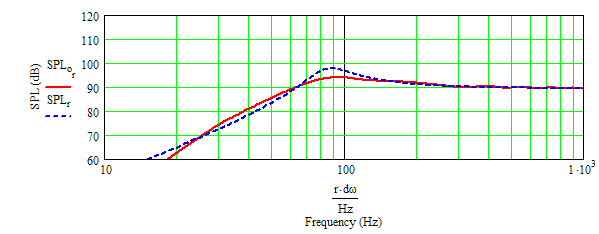

There were several posted B20 BIB alignments, so choosing the 96” one to fit it on a 4x8 sheet of plywood, it’s ~24 ft^3 net, so while it’s considerably smaller, it’s probably too under-damped without being stuffed like a typical TL, which will of course negate much of its LF gain.
These types of PA drivers all spec similar enough that a ~10 ft^3 sealed cab is close enough to being an IB for an 8”, so plenty big enough for a stuffed ‘to taste’ TL, which in turn will allow us to de-rate it to ~8 ft^3 for a well stuffed one [simmed = 1 lb/ft^3 of polyfil].
With a 94.5” i.d. height, this equates to a ~146.28”^2 CSA with the amount of TL damping varying based on driver offset [distance from closed end to driver centerline].
With a 17 ft ceiling, the driver ideally needs to be at some odd harmonic of it and unfolded, the driver offset at 1/3 lines up close enough to 17/3 and gets it up off the floor high enough for some shops.
Moving it to the closed end improves damping of course, but may not put it close enough to a 17/5 harmonic, though only one way to know for sure.

1st sim: B20 BIB, no stuffing
2nd sim: B20 BIB, with stuffing
3rd sim: offset driver TL
4th sim: end loaded driver TL
