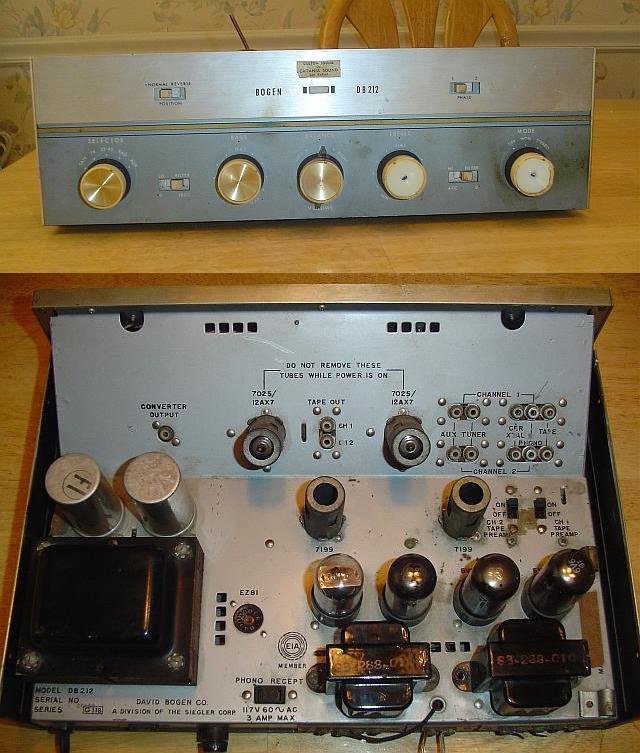

This Friday at the New Jersey Antique Radio Club meeting we had a mini auction. I purchased this 6V6 push-pull stereo amp for $12.00, not bad if I have to say so myself. Its missing its 7199 tubes (I have a spare from my Dynaco ST-70) and the EZ81 tube.
This will make a nice base for a DIY tube amp, or restoration when time permits.

Nothing wrong with that! I never pass up a chance to buy a tube amp for the price of lunch. You could sack it for parts, restore it for a secondary system such as for your workshop, or, as you suggest, use it as the basis for something new and better.

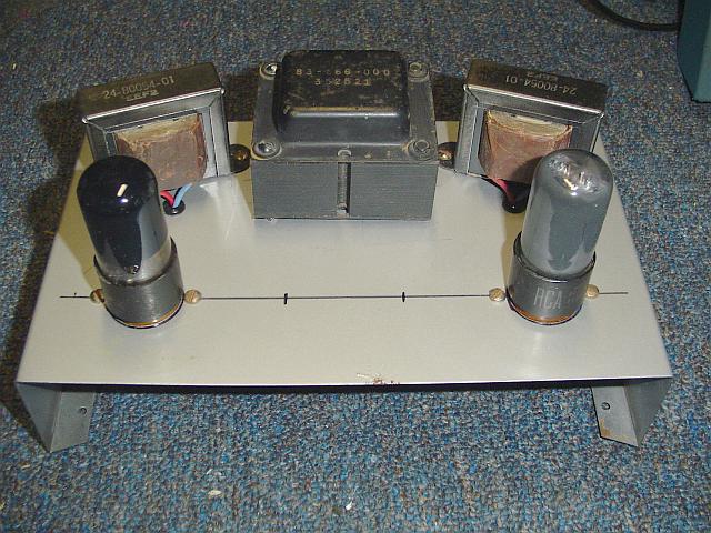

I am in the process building a 6V6 SE amp now (photo attached) utilizing scraps I have laying around in my basement.

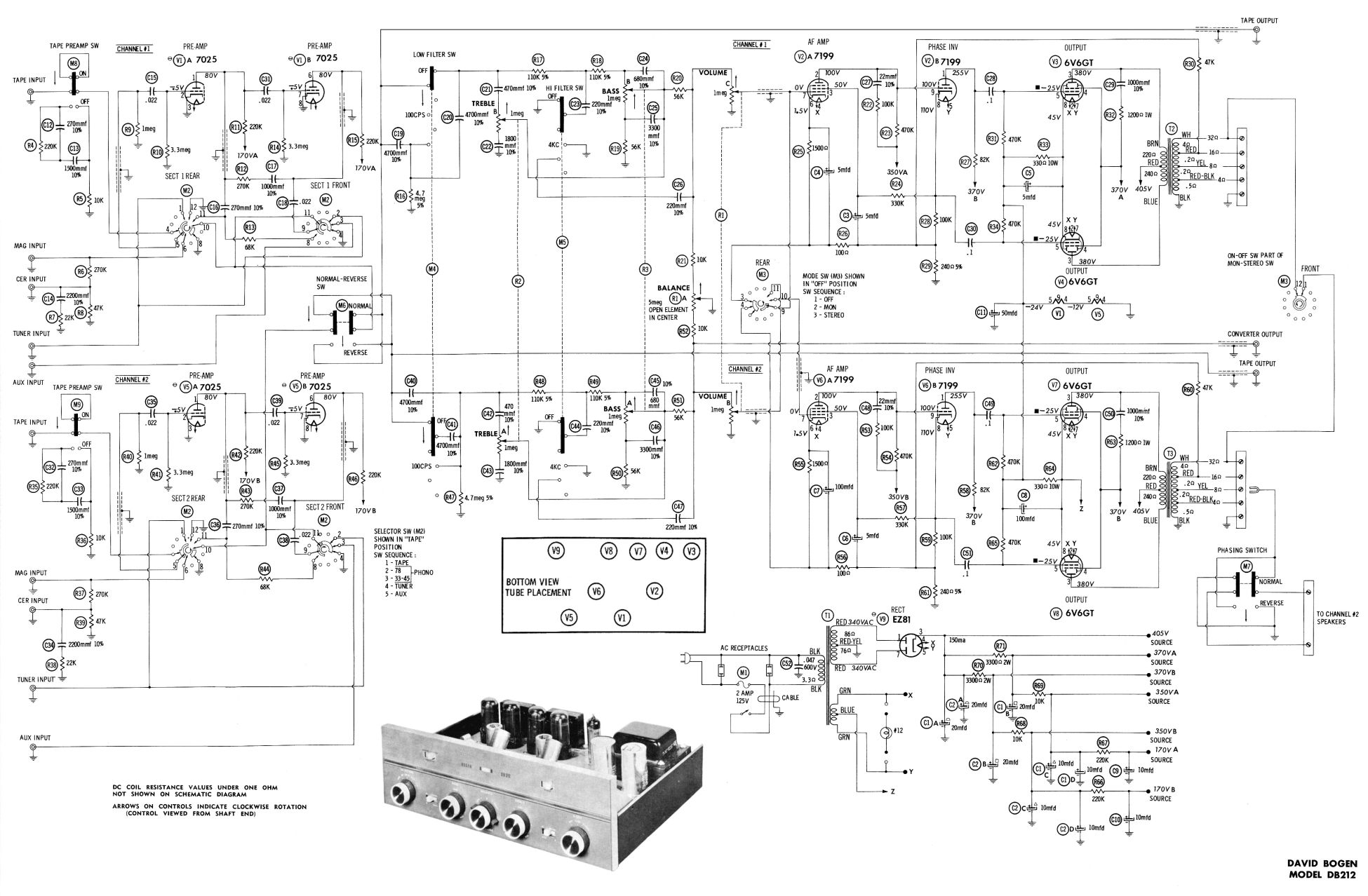

That looks like a DB-212 - I have the Sams folder scanned... let me know if you want ia copy.
If it wuz me.... I'd rewire the 7199 sockets for 6GH8 / 6U8 / 6BL8, since I have dozens, and ZERO 7199s...). As I recall it's 3-4 wires to move...

The Bogen amp is model BD-212. I would appreciate a copy of the schematic whenever you have a chance to email it. My email address is salb203 at optonline dot net

Watcha gonna drive the SE 6V6s with? If you haven't yet decided, think about a 5965.
IMO, tone controls should be COMPLETELY defeatable. Only a few recordings need the help. I'll EMail a Max Robinson designed circuit for the tone control function to you, as the forum software is blocking attachment. Perhaps the moderators will assist me. Use Max's circuit as is or reduce the number of triodes by replacing the cathode followers with DC coupled ZVN0545A source followers, as described in MOSFET Follies.

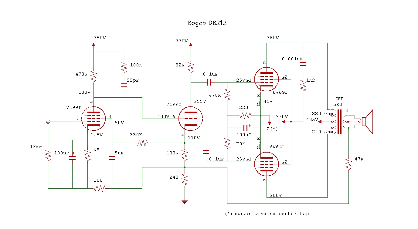

I'm trying to make sense of the DB212 original schem, but some details of the ground path strategy confuse me. Also I do not understand what's the purpose of keeping some bypass caps been just a fraction of the other channel values (100uF vs 5uF)
I was trying to re draw the power amp section; I'm doingg a mess? or is this right?

Sorry,Too late to fix the typos (being/doing) Incidentally I know nothing about this brand and his history, but I'm curious because Bogen amps were mentioned in some passages of Philip K. Dick novels, and it lead me to think they were advanced designs for their time (just a supposition)
