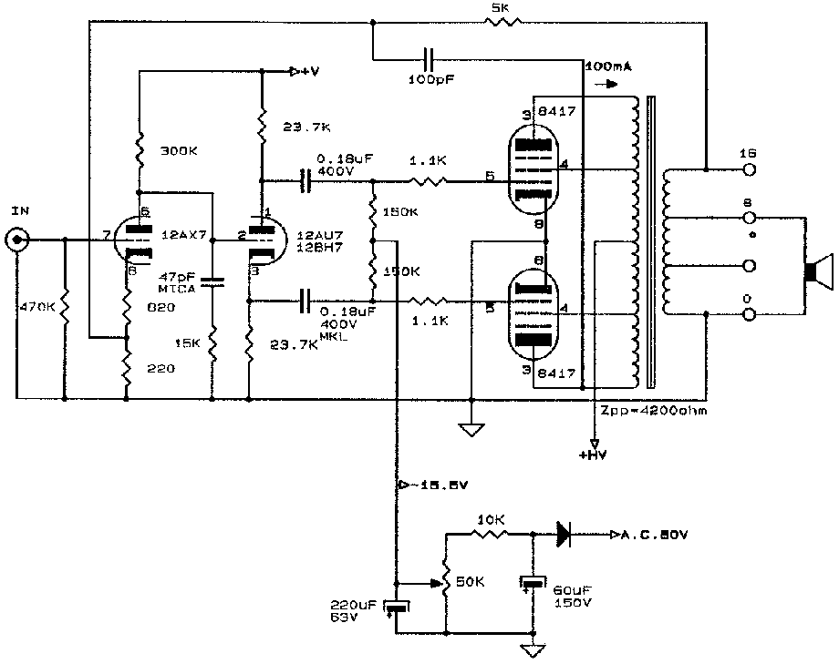

Hi all,

Hi all, thanks for your replies. I'm new to this forum stuff, but I managed (I think) to attach the M120 schematic here. As I said, I'm not electronically savvy, but I know how to use a soldering iron, a multimeter and follow instructions. I looked at burnedfingers' thread and can't make much sense of it, it's above my skill level. Ideally if someone could take a peek at the schematic and say, "okay, do this... replace this resistor here, etc.", I could do that. I've tried to sell the amp for a year (great condition, with tubes) and it apparently has no resale value. If I attempt the conversion and blow the thing up I haven't lost much, so I'm willing to take a crack at it. Any help appreciated, thanks again. -N.

The only real info i've seen is the link that HF-89 has already posted,which is probably a good guide to use for modification.
You'll need to add atleast one potentiometer (preferably 4-one for each tube) ,so you can adjust the bias. It's currently set at a fixed grid voltage. You'll also need to be sure that the bias supply can supply the needed voltage to the grids of the new tubes,you might need to fiddle R45,46,47 a bit to get it right..
Also add a small value resistor in the cathode of each tube,that way you can measure the bias for each tube seperatly.
Hum,some stopper-resistors on the screen-grids might not hurt either.

Actually I believe you should be able to make the swap to 6550's or KT88's and rebias. I don't believe the grid resistors are critical in value but need to be matched. You may have to change the bias pot in order to obtain the correct bias. On the Quicksilver you don't need to parallel the tube sections and I would guess the Bogan's front end will have enough grunt to drive either the 6550's or KT88's to full power.

I think the Bogan has hopes. If one were to re do the front end.
(note, my evil eye looking at SY)
In addition to the front end I believe a re engineering of the bias circuit in order to provide individual bias per output tube.
Oh, scrap the mic input section of the amplifier.
