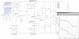

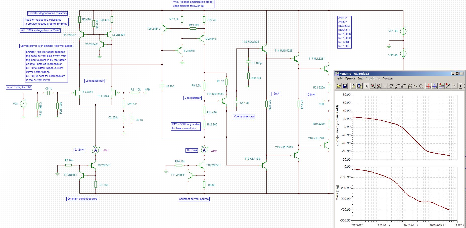

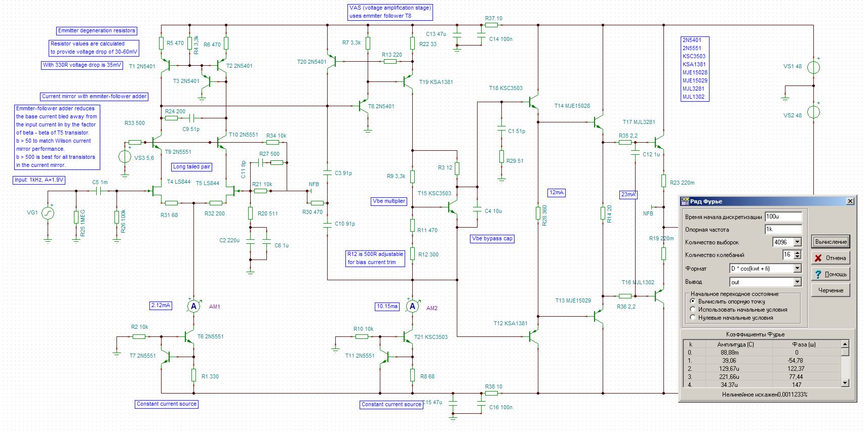

Hi all,
Schematics is one-to-one from the application note for LS844 JFETS (those are dual 2SK170).
https://www.digikey.com/en/pdf/l/linear-integrated-systems/ls844-application-note

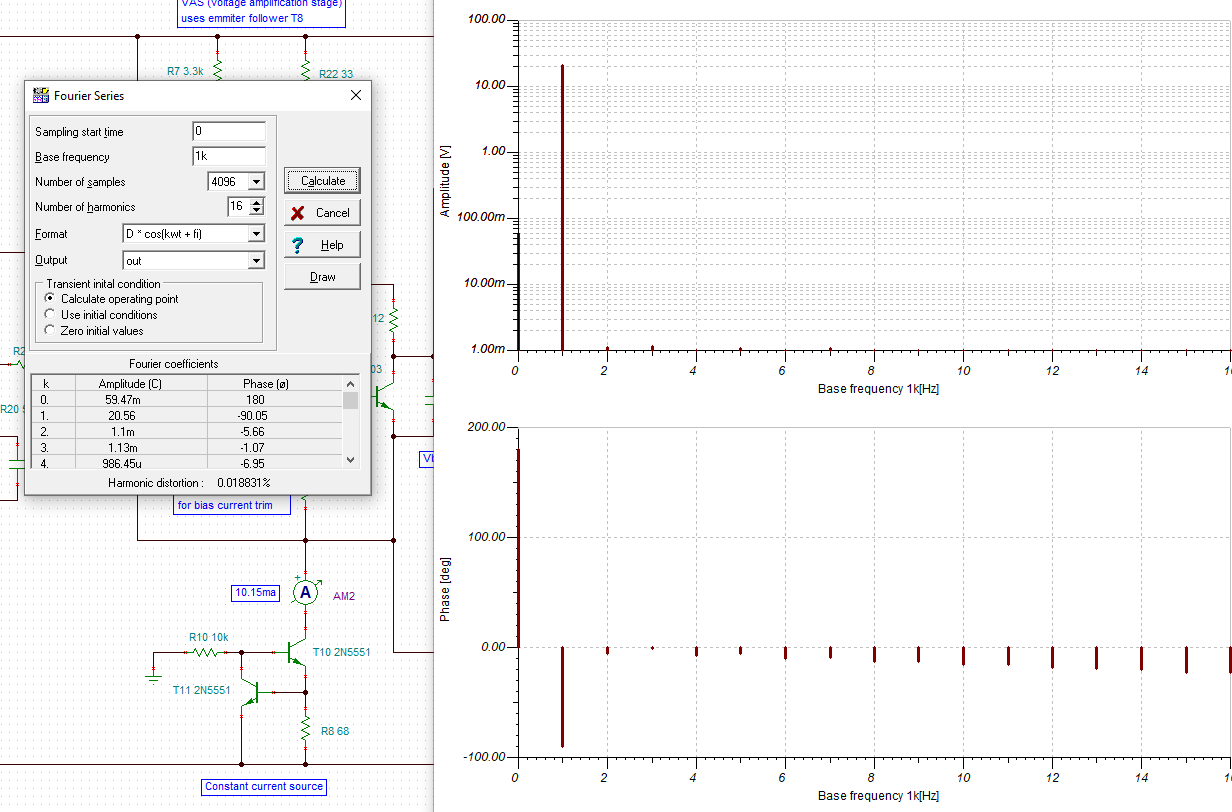

I was wondering what kind of distortion figures this amplifier produces so I simulated this in TINA TI.
Few models were missing so I had to search for those.
MJE15032 and MJE15033 transistors are not available and were substituted.
Attached are all sim files.
  • amp_by_Cordell_LS844_AN.zip

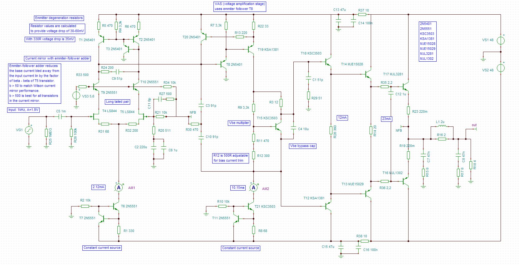

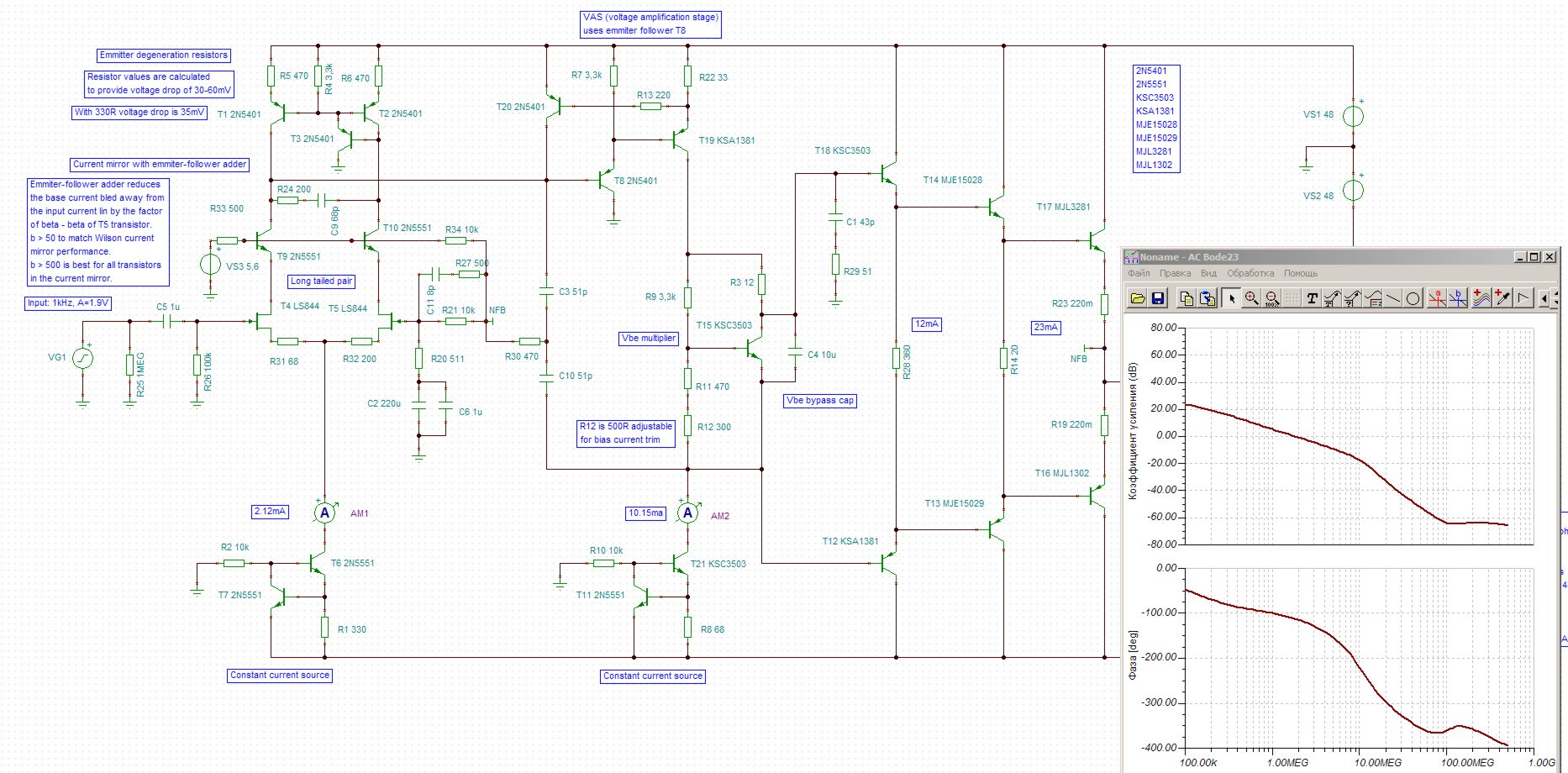

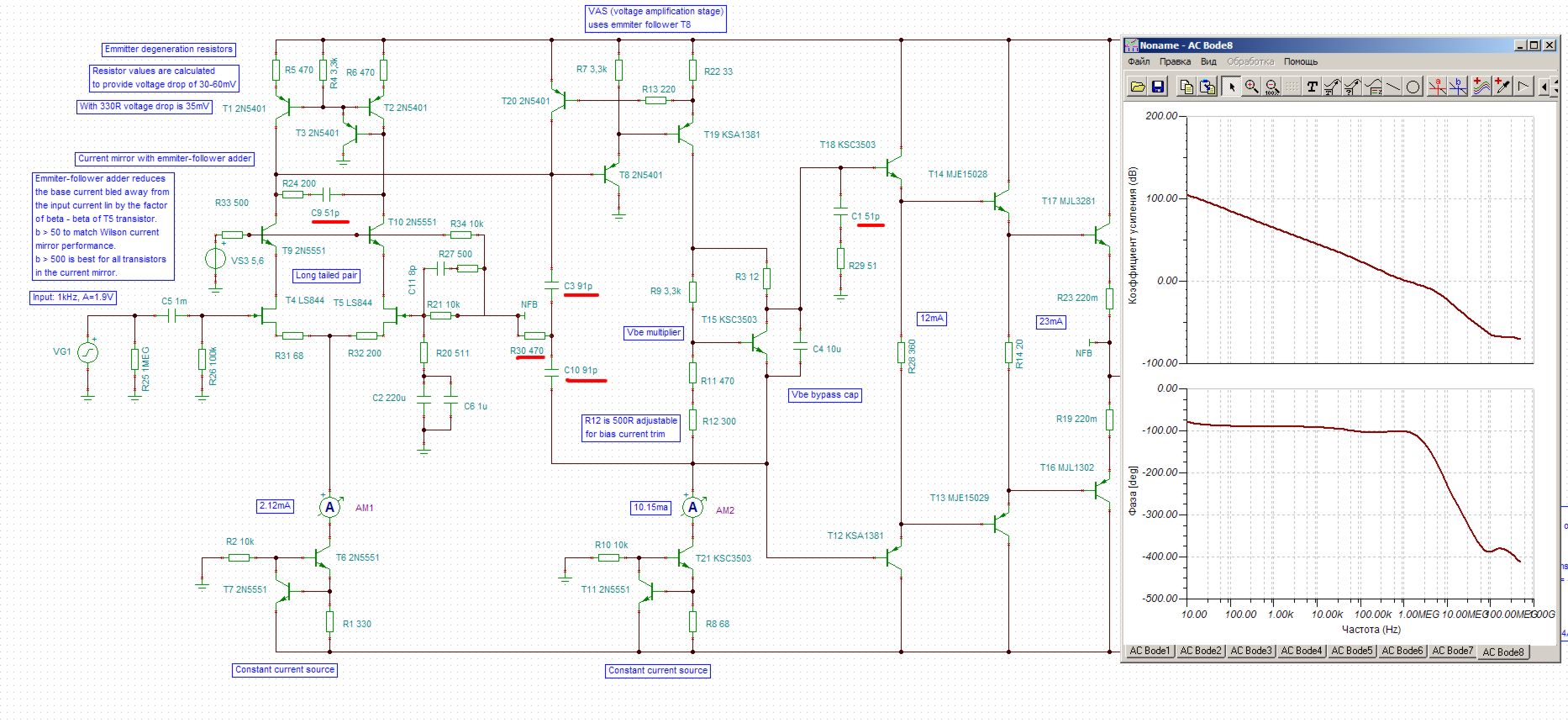

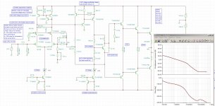

Hi. Input transistors with a supply voltage of 46 volts will work poorly. I changed the correction and replaced the transistors in the voltage amplifier. At the entrance, you need to put a high-pass filter.

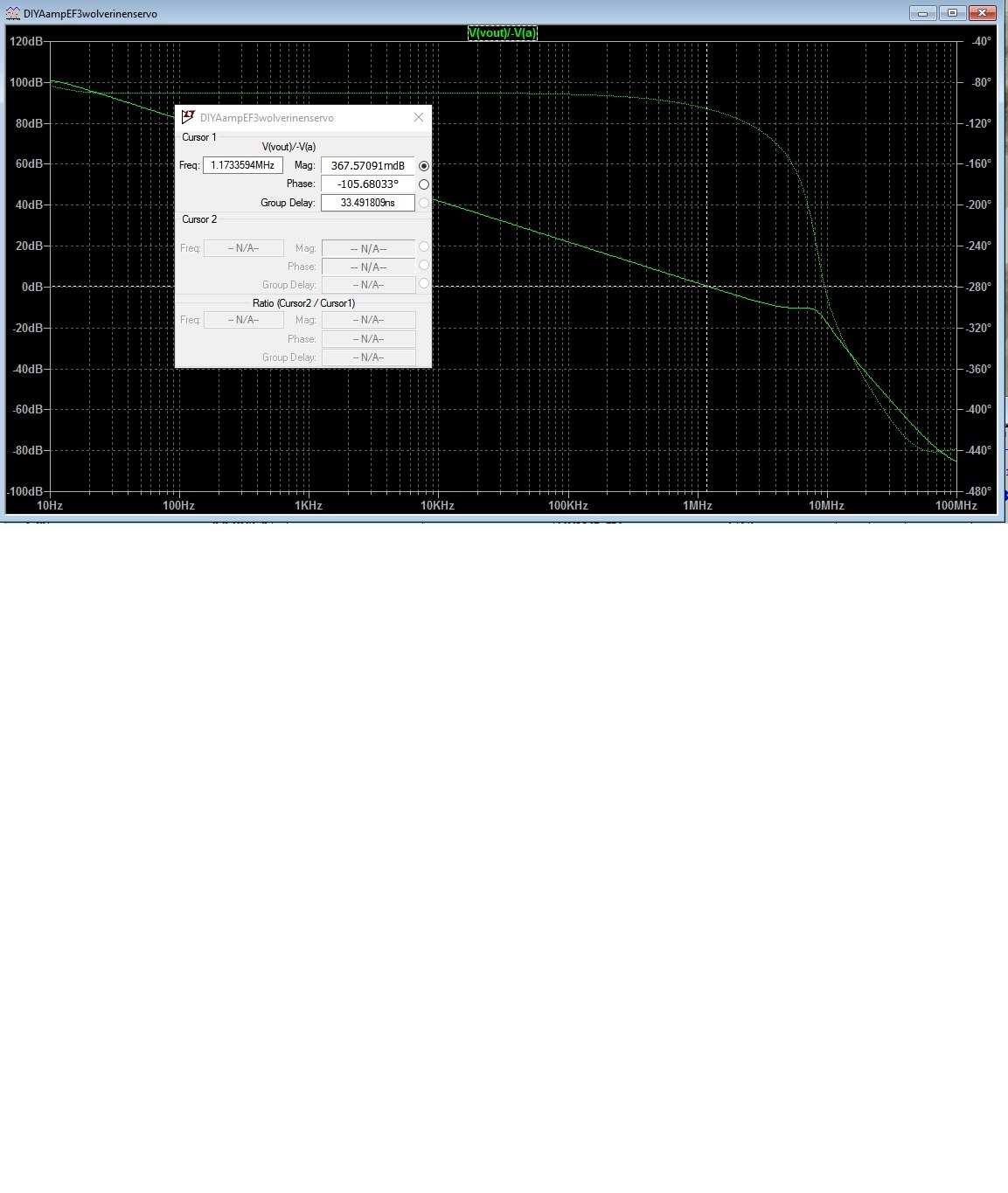

here is what a amp like posted should be .
See how "pretty" LT shows a unity gain bandwidth (gain) below 1.17mhz. Still 75 degrees to go before -180 degrees (oscillator).
Your EF3 is unstable in the real world , simulation might not show it.
PS - at -180 , gain is -10db .... can not be a oscillator.

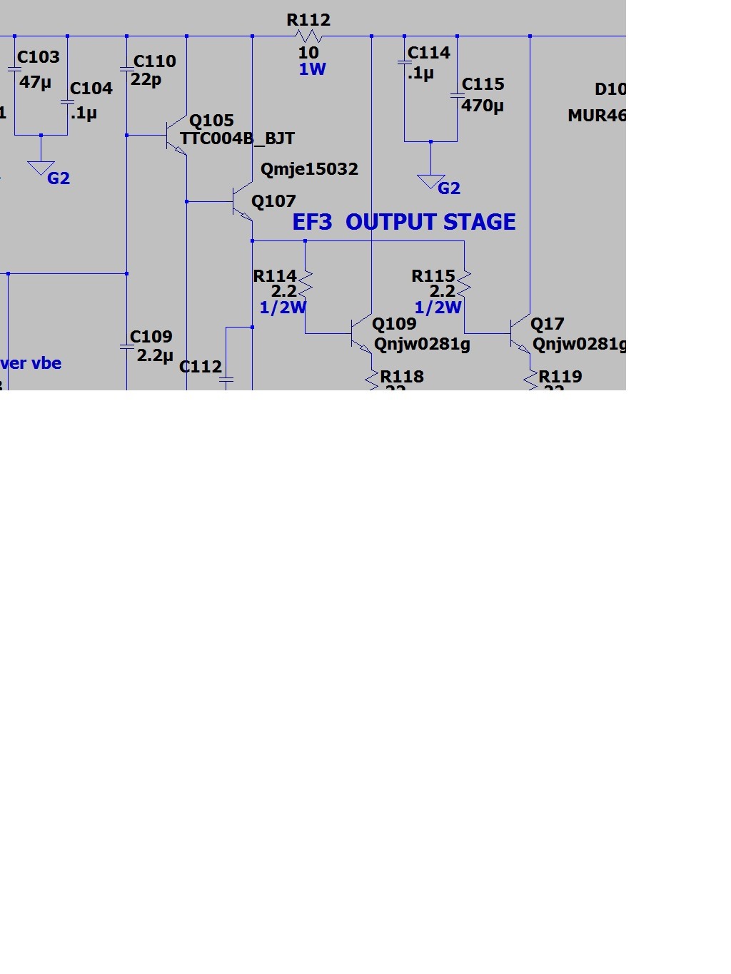

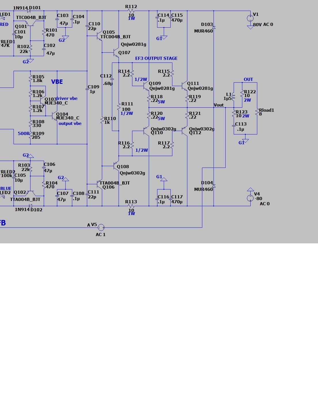

At least get your EF3 right. R112 + C103/104 break the feedback loop in the output stage. Old Japanese trick.
C110 shunts very high frequency ( where oscillation occurs) and you have rock solid stability.
Simulation won't show it - but it does happen.
Ef3 is cool , run your VAS at 3mA ... nice and cool ! Drive 2 ohm speakers - VAS does not see any of this. damping factor of 300+ easy.
PS - and base stoppers (R114/115) plus C112 (suckout cap) pulls the charge out of the output bases. Very fast perfect audio.
8 years of perfection. Badger was before I learned this $hit.
OS
