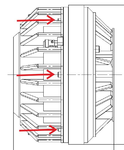

Is there anybody who have experience with changing diaphragm on this driver?
I cant find any screws an wonder how a can dismount the driver?

Looking now it should be opened from the back where the speaker terminals is positioned.
Thnx Flaesh!! 🙂

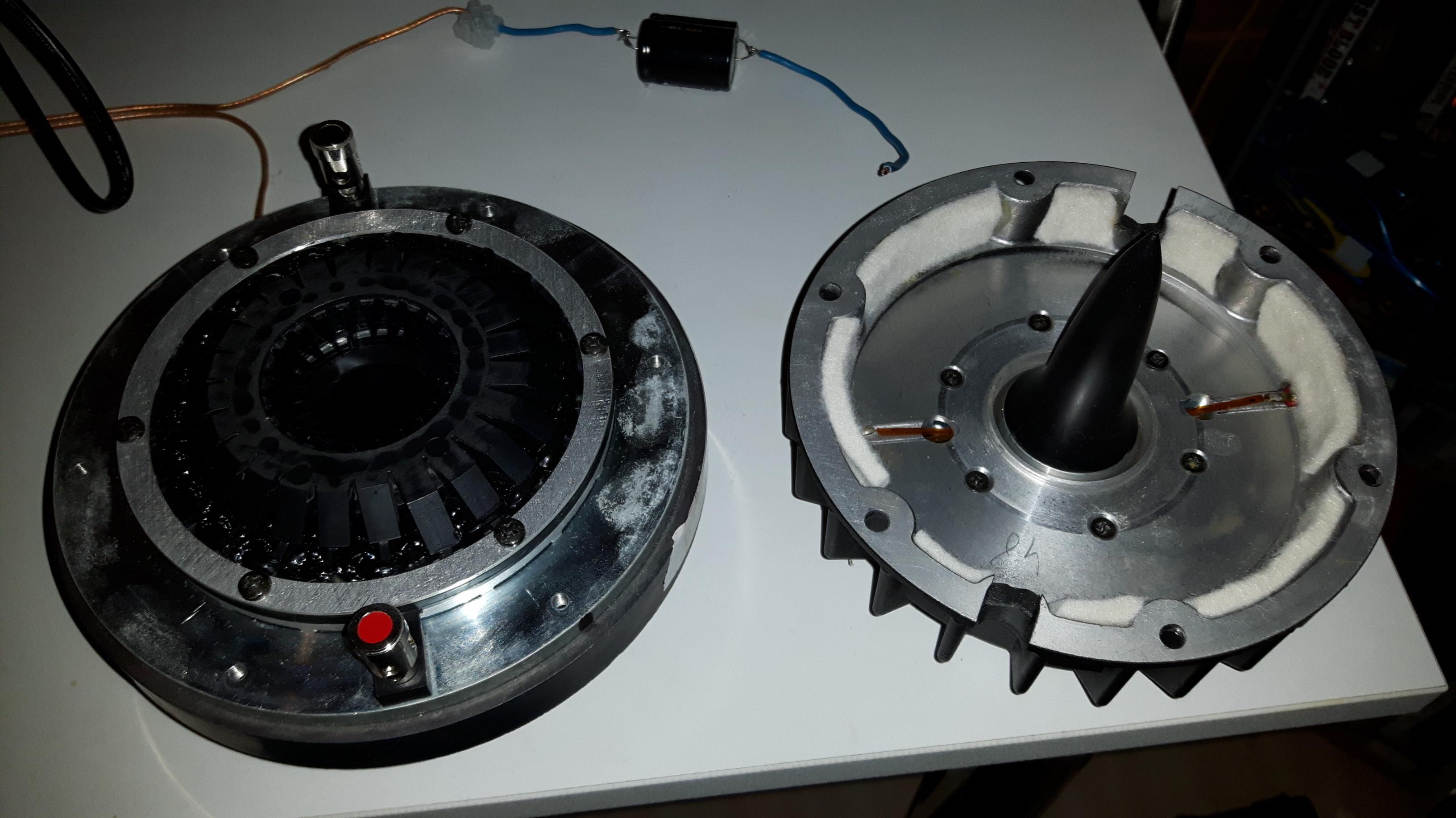

What I find out also!
Is there something special to look out for when open this?
Have only changed diaphragm on JBL 2446 before...

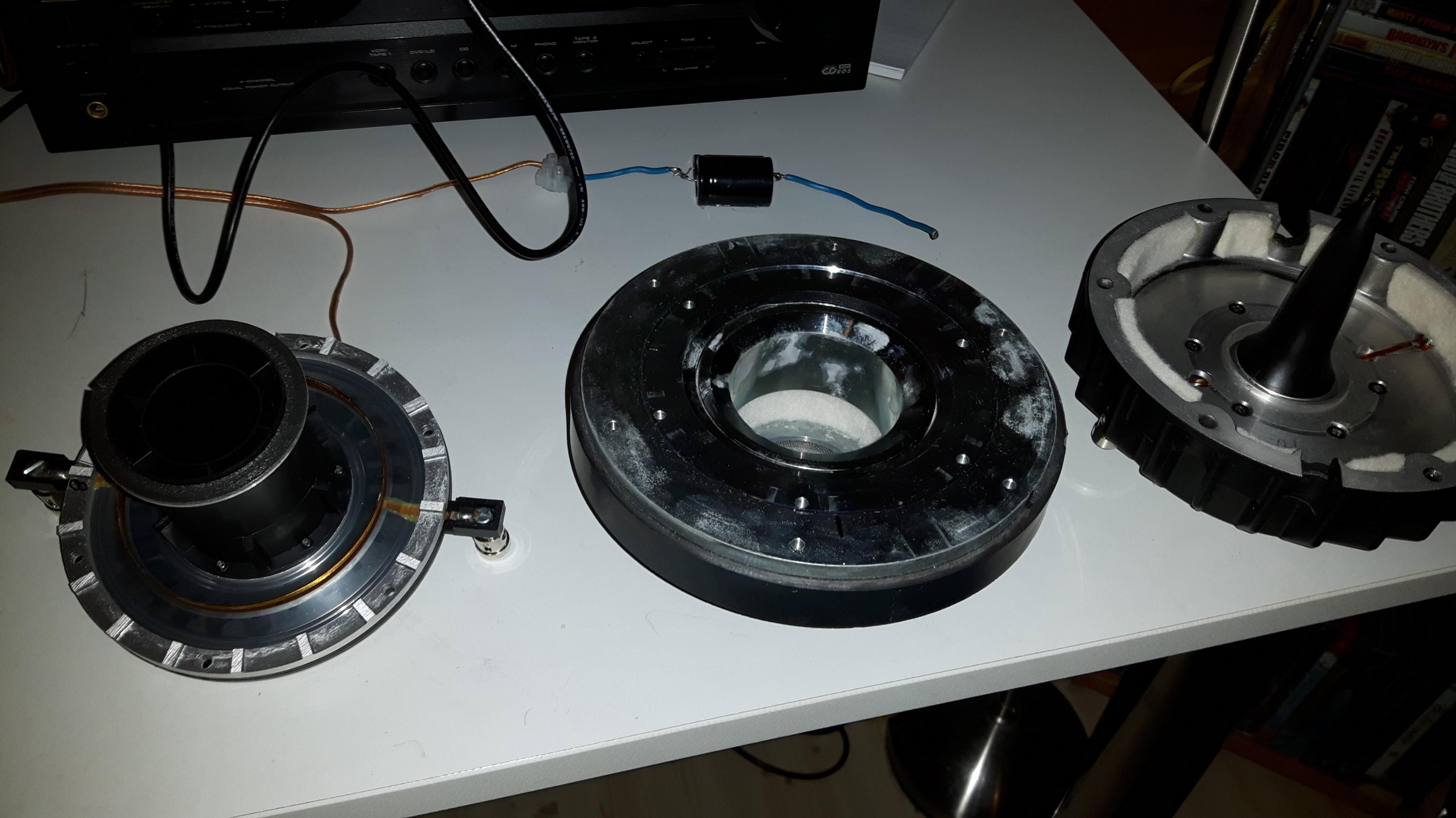

Don't know. Using 4595 at home I cant find any reason for this 😀Is there something special to look out for when open this?
I also marked the diaphragm with marker before pulling out to get correct position.
Then cleaned the coil with a q-tip.
The thread where the coil is positioned cleaned with painter tape.
When mounting back the diaphragm I hit carefully with the back of screwdriver to have well positioned and at the same time tightening the screws in cross order (same as when changing wheel on car)
Put back the cover.
Measured the driver with REW, measures now well 🙂
NB! I used a 55uF (what I found in my shed..) protection cap between amp and BMS so not to destroy it by power on thump from amp!
100uF should also be enough to protect it.
