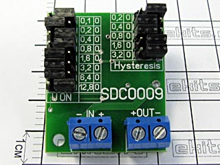

As a undervoltage protection i'm going to use this scheme. It has adjustable hysteres and cut off voltage. It is sold in Russia.
